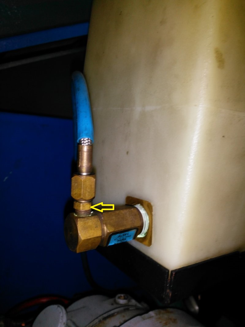

Hey guys, I have purchased a Prochem Blazer, used with aprox 11 hours and it seems like it is bypassing way too much water from the temperature control valve to the waste tank. I took the valve apart and cleaned it and changed the o ring but it just pours out causing low heat and filling the waste tank prematurely. Is it just a manual valve or is there an electric solenoid controlling the bypass?
Picture of what you took apart

28,273
The 145 degree relief valve on the water box is fine. It is leaking on the manual bypass. There are no wires attached, so it looks to be completely manual. Opening the valve, you get full stream of water going to the waste tank, closing it reduces the stream but doesn't stop it altogether. I bypassed it back to the water box for now, I'll have to get a new one from Prochem it looks like.

11,541
I over tightened mine because my tech thinks tighter is better and caused it to leak.
I just tell him never touch it.
When new, when it stops turning you have to stop turning it. Anything more dents the brass.
Cranking it down will eventually stop the leak. Just replace with stainless if possible.
