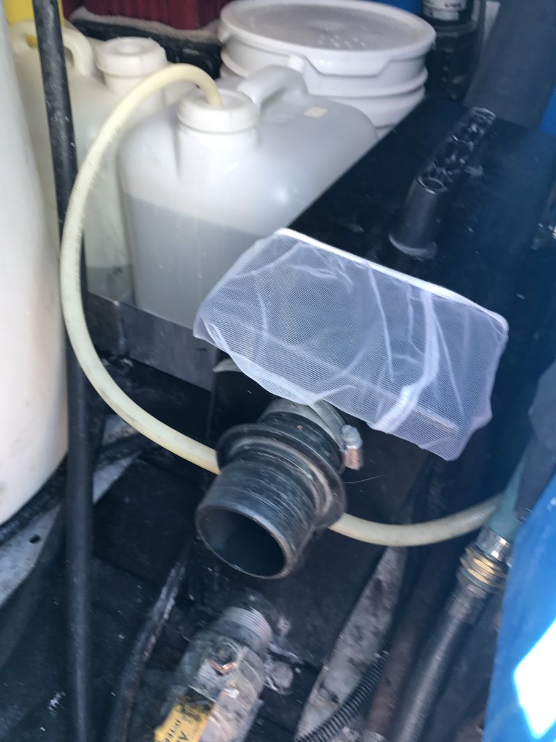

IMG_1511.JPG IMG_1512.JPG Ps. Thank you Mark S. for the referral

It will help keep the waste tank cleaner, and if he has a auto pump out, it will help it too.

Yep. Just my stock filter box on my Everest. But the paint filters keep it cleaner and easier at the end of the day. If I had a traditional in tank basket I would be using a Dev filter for sure. Keeps the tank so much cleaner. And climbing into a low roof Ford with an Everest tank is not a fun time. Lol.

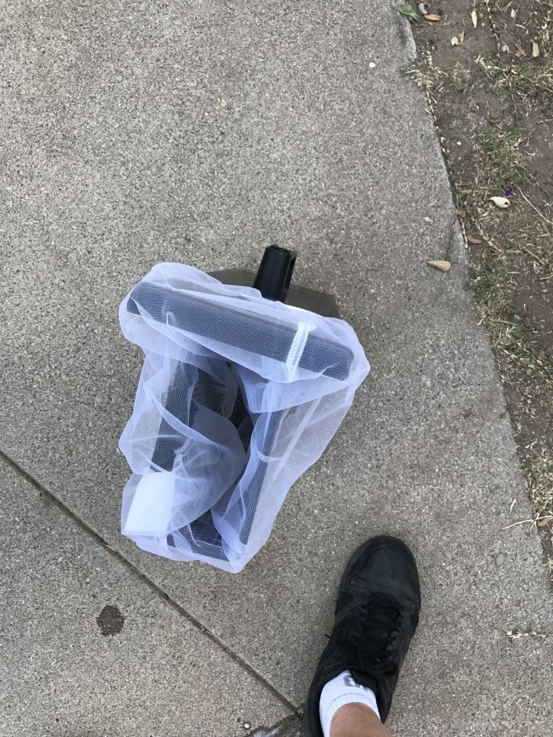

I bought the DevFilter awhile ago. Nice piece. After using it for some time i start tinkering like i usually do. On my AquaTech units, there is an in-tank filter basket that i operated on, cut it all out except for the top inch&ahalf trimmed the rim to fit the paint filter & viola... a custom made bottomless in-tank basket filter.
Huge flow and a 10 second swap for a new bag.
