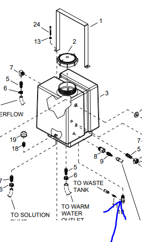

i need a bit of help in finding prochem thermal valve for the water box, i am sure mine is worn out . if someone an pls post a link or something will be helpful, thanks

Here you go. You can also grab the hoses that are on the waste tank and follow them back. One of them goes to the thermal relief valve, one to the flow simulator, and one to the heat bypass valve.
