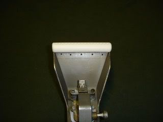

I didn't care for the Prochem Upholstery Tool that I bought 4 years ago. So, I sold it. Then Greenie made a glide for it and some notables on the board have stated that it was the best tool ever. So, I bought one near new used one ($150) and slapped a glide on it.
I've tried it on several jobs and I just don't get it. It seems messy and slow compared to my other tools. It does have a nice sweet spot for cleaning. And the adjustable spray is nice.
Does it just take a while to get used to? Am I doing something wrong? Tips on use?
It's amazing in the tight spots on stairs so I'm not planing on selling it.

Placement and size of the holes to control overspray...any recommendations??

Greenie clued me in on size and placement of holes. That is why a pc works so well on microfiber, you can turn the pressure up to a good hosing.

You'll fall back in love with that prochem tool if you follow the optional instructions included with the glide.
Just keep the holes under 3/16" unless you run a Vortex, anywhere from 4 to 5 seems to be the sweet spot, also make sure the holes aren't obscured when the glide is fully inserted. (note, the tool will be louder, but catching the operspray is worth it).
I also extend the jet (and optionally upsize the flow to an 02) with a checkvalve jet extender.

3/16" holes is what I did with mine. Maybe that is the problem with mine. I drilled 5 holes but it does not seem to control the overspray. Holes too big I guess.

Brian, tape over the center holes and only leave the end holes and see if that changes anything.
Then buy a real TM. :wink:
Seriously, a strip of tape applied dry brings it back to factory.

I will double-back tape a 1/16" piece of G10 over the inner holes. Fiberglass epoxy is as strong as steel. Great stuff.

I was thinking a little more redneck....just duct tape it for a job and see how she flys?

This way I can drill smaller holes right through the G10 if I need to.

My first one was .172, I think that is the one in the pic.
But honestly, even at 3/16 I don't know how it's not grabbing the overspray with a glide?
Got a short checkvalve extender?

can someone post a picture, I have one also and hate the thing
spray tends to be heavy in the center and just not a good tool
with the way it works now I wouldn't even try it on microfiber

7 or 8 post up Steve.
I change the jet using a short checkvalve extender to a 95 02
