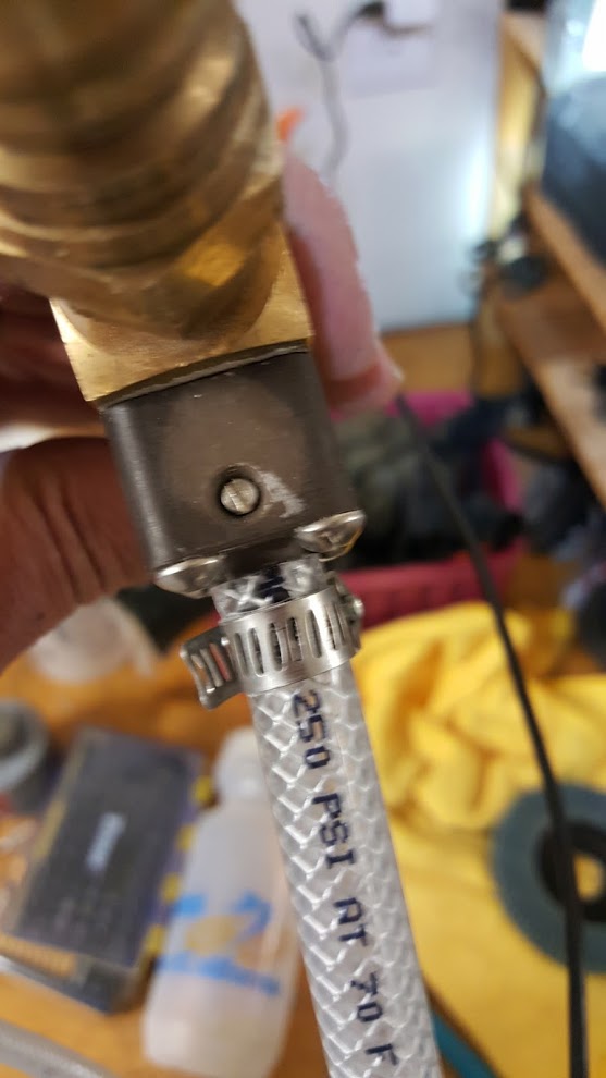

Mine stopped drawing the brine today, after lots of scratching my head (raft, Marty) I decided to take apart the Dema, low and behold that tiny screw was all the way in totally cutting off flow.
I opened it wide and all is well.
