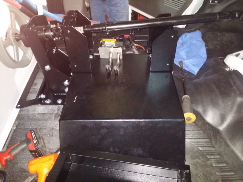

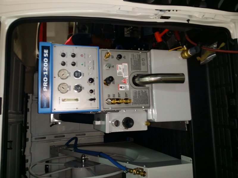

Progress pics of the build.... pro 1200 sapphire
