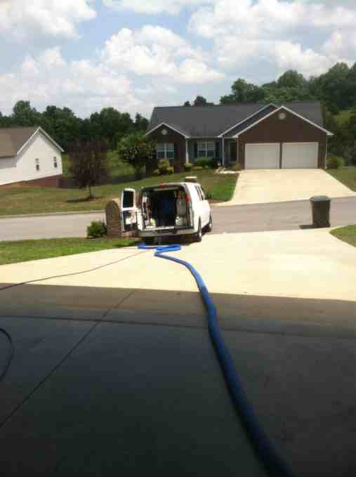

Especially id your gonna run for long periods.
Cleaned this same house exactly 30days ago as they went to Texas to buy amother place, i was called in again for a little Market Ready touch up.
Run some extra hose and keep your Rigs as level as possible. Keeps all your pickups working properly and your engines lubed.
Dont Be Lazy!

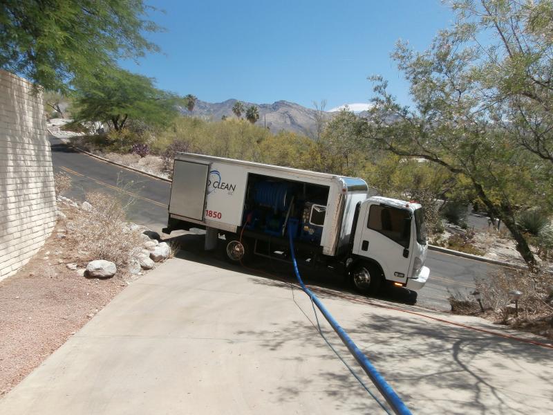

sometimes you just don't have a choice........you got to pucker up and just get it done.....

And my friends call me a Polock...:icon_razz: The drive must be steeper then it looks.. I would have pulled up straight and went a little into their garage to get the same angle you are running at..

mine would not go in the drive way....I could back the Vortex up in there...it would still be at a slant...but not as much as the road.....the Chevy is 2 foot longer and that 2 foot will not let the bumper clear...and between the slant in the road and the one in the drive way........that's all I got..........

If you look at the trash can. I am standing in the garage and my feet are above it. Last time I did 5 rooms and 2 sets of steps here.......
I got nasty azz water in my blower. In the pic I can zoom in and barely see it. about a 8" tan spot on the concrete.
It is about two foot down on the left side of the pic from where there grass and concrete start, looks like a smudge on the image.

And look at Jims picture. Curbed the wheels just in case.
