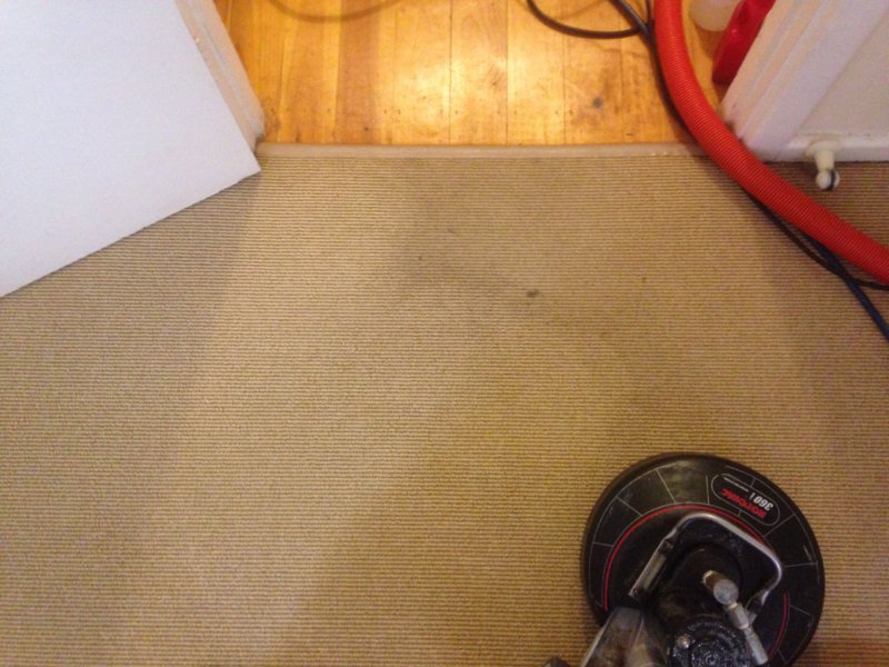

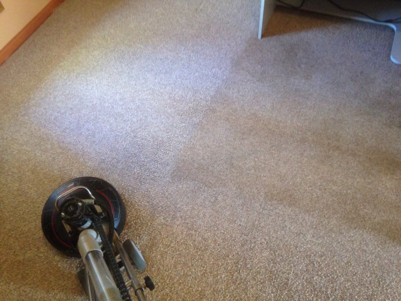

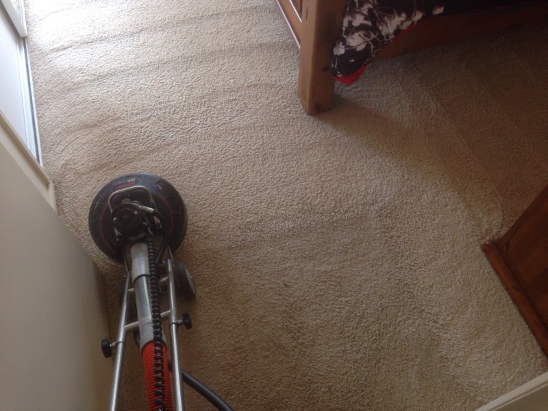

The nice thing about Redline is that it has enzymes, is a good cleaner and unlike some of the knockout high ph enzyme products out there, it still maintains the carpet warranty.
A product that can be used both commercially and at homes.
As with all these products- a little more agitation and dwell time, goes a long way towards greatly improving results.
But that is a lost art. Ain't it? :winky:
I got some - excellent - just - excellent advice about a RedLine Powder here on Mikey's Board.
It changed my day to day business. Just overnight.
Best chemical I have ever used. Even better than Bio Break which impressed me a lot.
