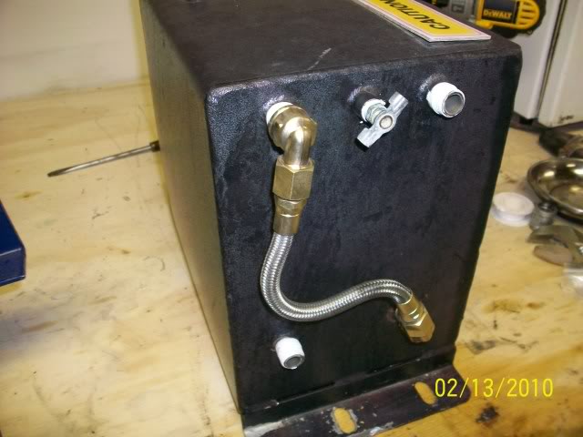

that Butler i had was ALL AN line..
heres the HX

It's crazy NOT to have an EXHAUST heat exchanger when you have a V8 engine sitting there running the whole time. It would be easy to do.
so Lee...how WOULD you do it....?
18,840
Benton KY USA
Lee Stockwell
Right behind the catalytic converter unbolt the exhaust pipe and add a loop that totals about 8' of pipe that is flared on one end so that it bolts stock back up to the converter and tail pipe in their stock locations. Coil about 150' of 3/8" stainless tubing around that loop and insulate over the complete assembly. Don't insulate the converter or factory exhaust however, as this could trigger warranty issues.
There would be a couple of other details for freeze-proofing it. I did a crude version of this when I had a Butler.
yes the freeze-proofing was giving me a hard time..... :?:
