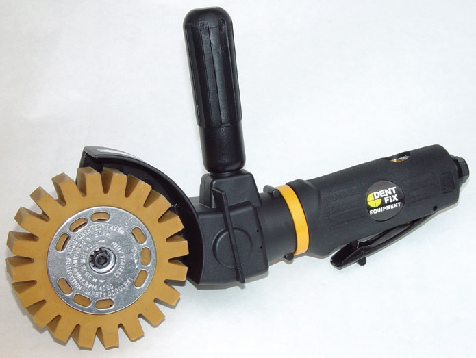

No, the best way is an electric drill with a stout wire brush on it. After you get the bulk if it off, you then can then can take paint thinner or mineral of spirits and coat the residual patches and putty knife them off.
Make sure to clean the tank top with detergent and let it dry before putting the new gasket on.

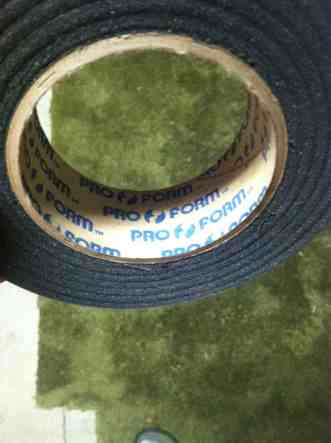

The gasket material that we use in a self adhesive that you peel off. as long a the surface is relatively smooth and clean it will stick.
You could us a gasket with out adhesive as long as you never lift the lid.

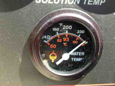

I just did this for the first time as I usually have my suppliers mechanic do it. I had to do it quickly because we never go in our dump tank as we use a in-line filter so rarely go in there. Noticed I lost some vacuum & heat and the gasket had some cracks in it.
So I called my supplier and they insist that you have to use their special glue/epoxy and it takes 24 hours to cure but I want to fix this ASAP.
So I simply scraped it off with a big blade made for removing glue off subsurface and then used Dremel tool with wire brush and clean it up. Wipe down real thoroughly and simply used 100% waterproof gorilla glue and it has worked perfect!
The best part is my vacuums completely back and so is my heat being a heat exchange system.

Best gasket material I've found is grey, closed-cell, anti-fatigue floor mat at Lowes. About 1/2" thick, 30" wide x whatever length you want to cut off the roll. Cover the whole inside of the tank lid. Glue with Gorilla. Lasts 24+ months.
