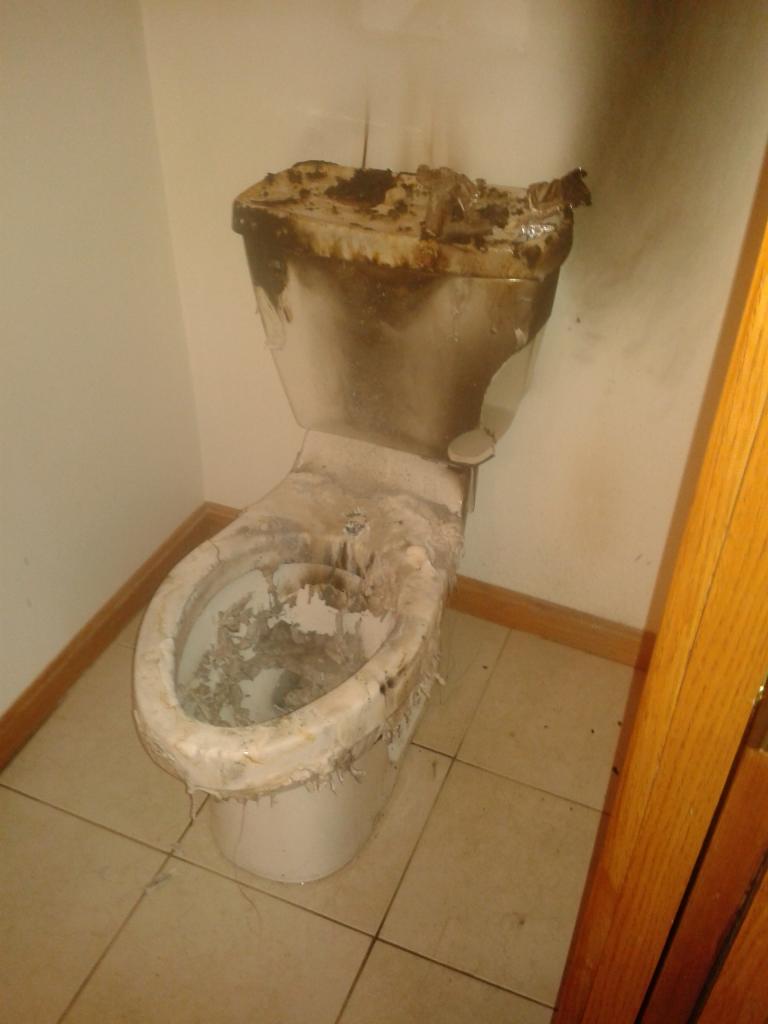

I think the monetary risk involved warrants more than a votive with a flower pot on top.
Liquid wax around the wick can often choke out or limit the flame size.
