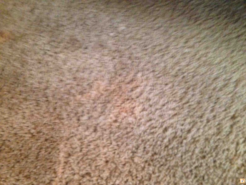

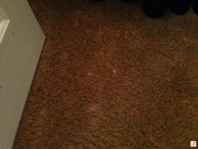

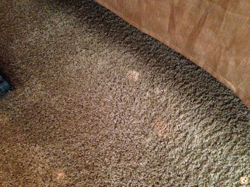

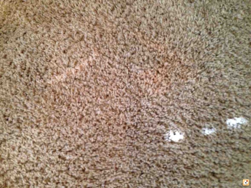

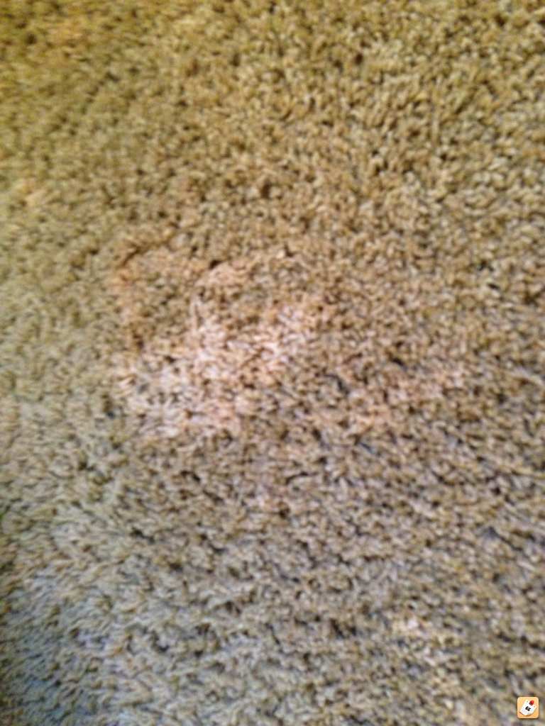

Random bleach stains appeared after cleaning
11,182
Did this job 10 to 12 swears by a competitor whom I sold Thayer first truckmount back on 93
We pre sprayed with prekleen then rinsed with pro powder.
No visible problem did some subsurface in another room were the dog pissed it was lighter from the urine already.
Left fans in room finished packed still no appearance of stains.
Get call at 400 says its bleached.
Here's what I go and see
11,182
Ya that's what I told her after I gave her my insurance info.
She's like shouldn't some things be tested in a inconspicuous. I said we pre sprayed everywhere and rinsed with same stuff and the spots didn't appear for at least a half hour how do you test for that??

How old is the carpet? Usually after 10 years carpet has no replacement value. We have a disclamer agaist pre-existing conditions like this.

Remember if the spots can be bleached. They also can be spot dyed.. if you want to take responsibility . That is the route i would recommend
11,182
In 30 years I've never used my insurance, I don't have time to mess with one bedroom.
the living room is fine, there's at least 30 tiny spots.
All around bed and walkin closet
These spots weren't there a half hour after we cleaned room the bleached after we left.
San Francisco, CA
Bummer!
Unfortunately, we've all been there. It is clearly spills and drips of some chemicals that they used, and what's not. If it ever came to court you'll clearly win.
Though, you probably don't want to get there.
That's why cleaning a carpet is kind of like walking into a mine field. You never know what's underneath. Thankfully, these don't happen that frequently.
If client does not understand or admits responsibility (some time they don't even realize that it's them) what are you gonna do?
Crayons may come handy or the kit CTI is selling. Just don't come back to re- clean, cause so would the stains :winky:
Re dying is an option though time consuming and the client may not deserve this time investment.
Keep us informed.
Or better yet- Send Jimmy :eekk:.

Based on location. Even more reason to suspect benzoyl peroxode ointment. I have seen it many times just between the bed and the bathroom. They often apply it on feet while sitting on the bed.

Pesticides will do it too.

Ya especially when it's only in walking areas in the bedroom right next to the bed and walkin closet that's why I'm thinking its something they used on their feet.
But a dripping pesticide bottle is a possibility too.
I've see foot prints coming from the bath to the bed prior to us cleaning (fortunately). It was due to fade cremes that were used on their feet and activated by the moisture from their shower over time. Just lucky it was prior and not post. :icon_neutral:

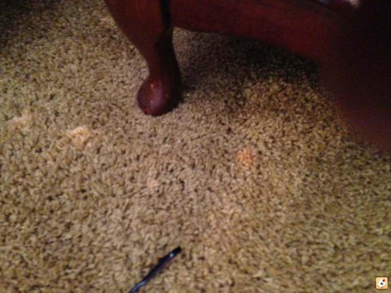

It looks like in a couple of pictures the spots are in a corner and also around furniture legs. I think they are some type of pet stains. Teenagers don't lay in corners or put their faces next to furniture legs but thats where dogs pee. A door frame or furniture leg is a tree to a dog.

I cant see dog pee doing something like this well after I left it bleached it took time.
there was no spot at all before cleaning.
I know urine can discolor carpet but those are end tables right next to the bed, there
was one that was a straight line which was odd.

Most definitely the BP issues as stated. Athlete's foot creme will do this as well.
Who's rooms is it? In the traffic area is a big giveaway. Innocently ask homeowner about any foot cremes. Also teenagers like to sit on the floor at the foot of beds and chairs to apply acne medicine to their face then wipe their finger/hand on the floor and apply again.

Because of the discoloration (best guess mind you) people are using colored Windex to treat stains right before you get there. Old urine will do the same thing. Peroxide even then kind you use to rinse your mouth with heat will turn white. Ammonia is usually the perpetrator. They get it out of some stupid book for home remedies. I always show the customer immediately and make them sign a waiver.
