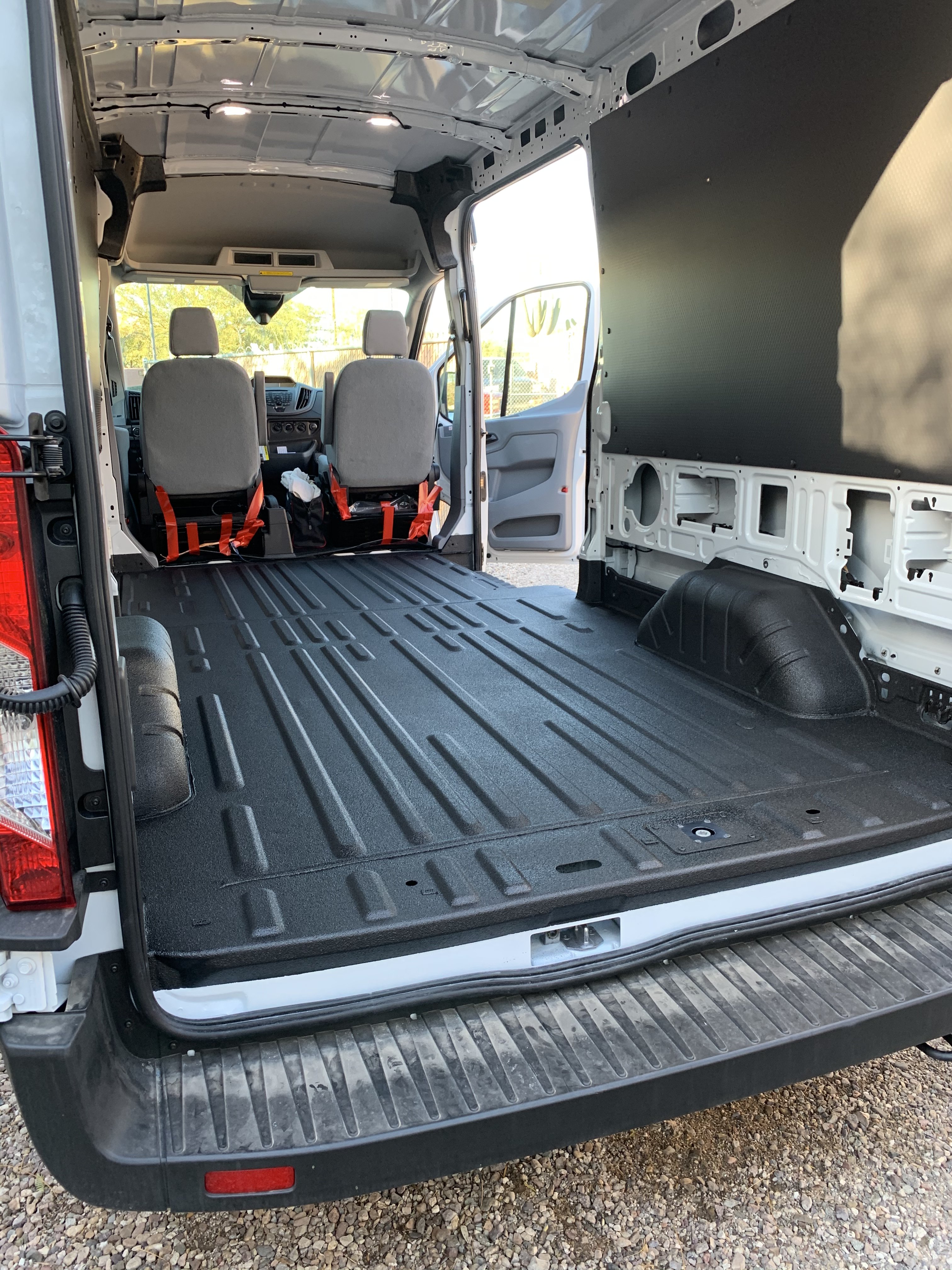

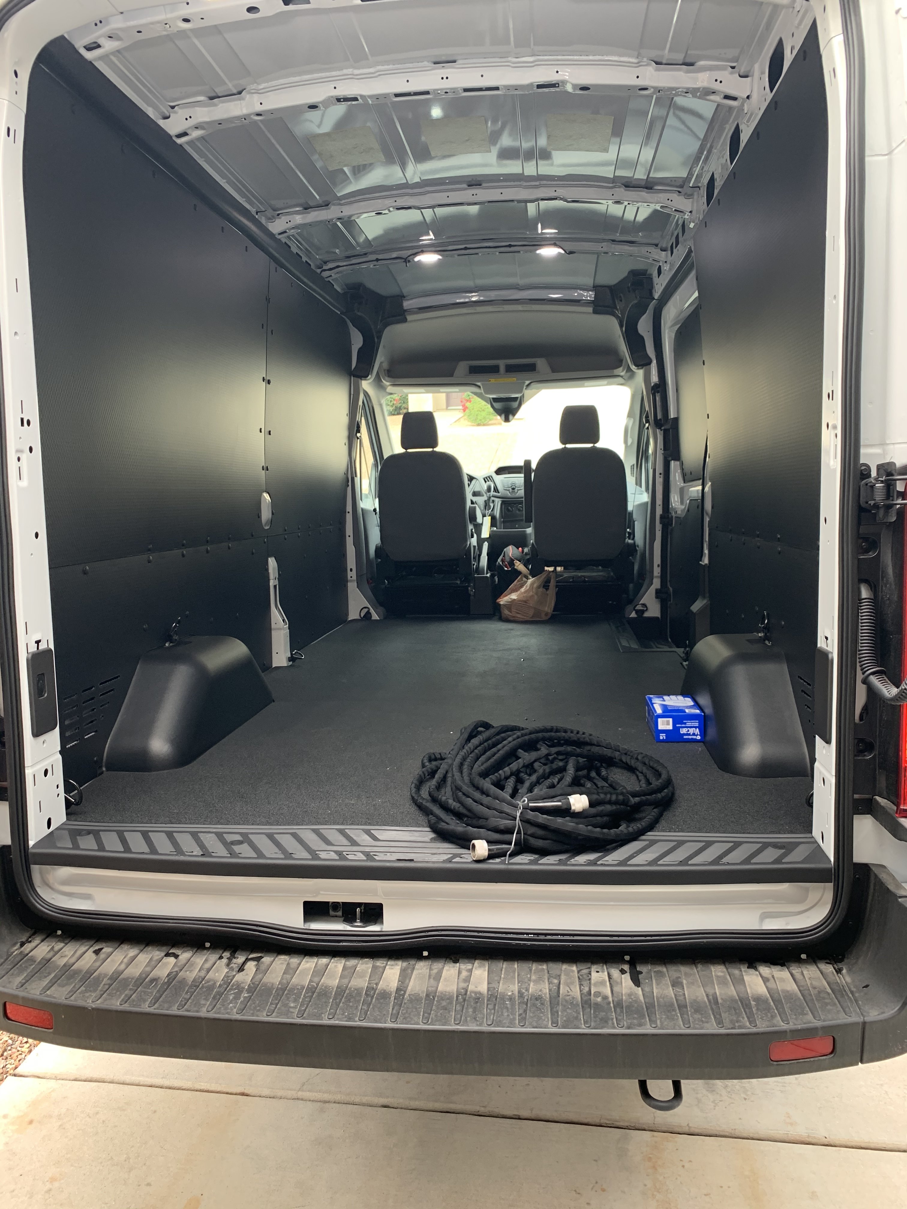

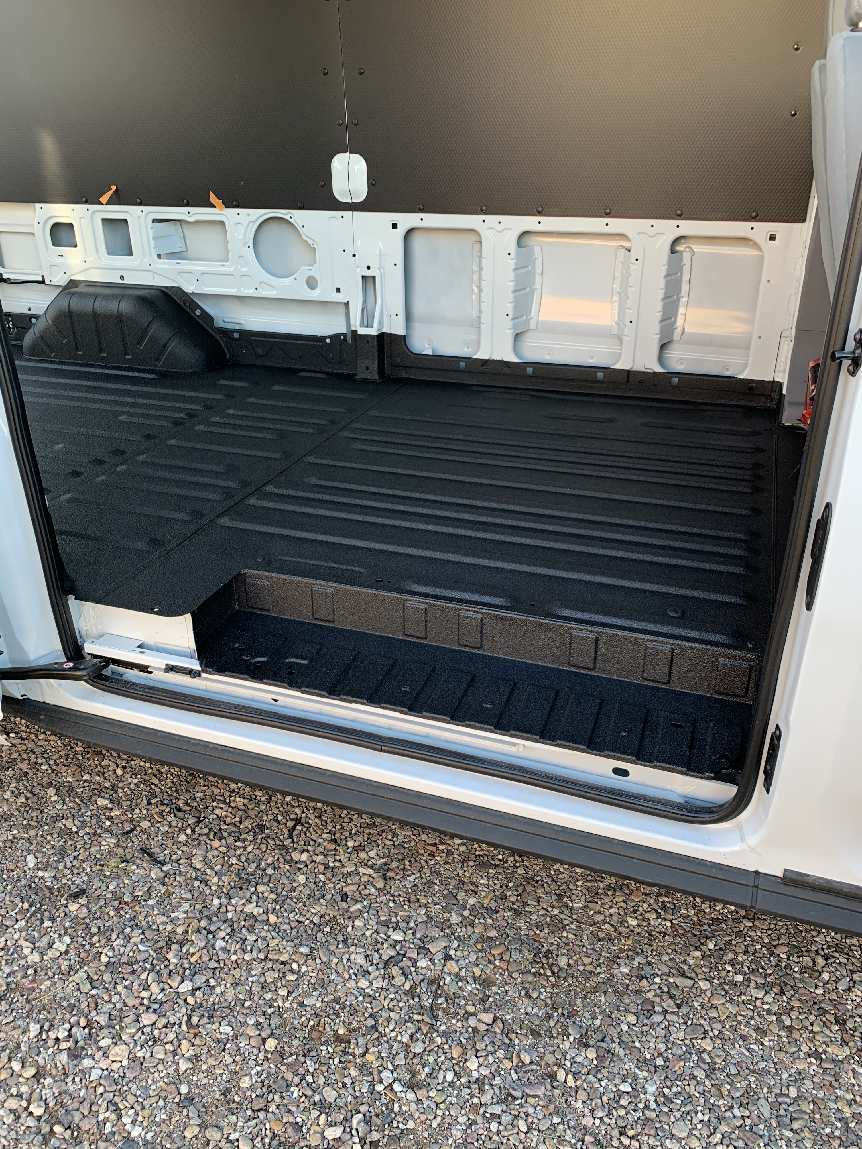

Who hear has used raptor liner? How is it holding up?
I sprayed in our van today I think it looks good, hopefully it will hold up.

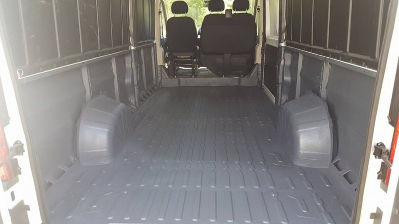

I found out the hard way. I bought it twice for my Promaster. I bought the first batch from a local auto paint supply shop. It was white tintable. Turned out it wasn't enough to do my van so I bought another batch on Amazon for 1/3 the price of what the shop had charged me. But when I ordered off Amazon I accidently ordered black. so I mixed the black and the white together and it came out Grey. I like the grey so much i'll be doing it again in my truck.
