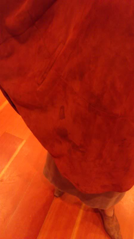

Friend of mine got a great deal on a fur shawl coat, $4 !
But it has a spill on the suede side.
How would this be cleaned?
COuld this be simply wiped down with a damp cloth or maybe using an encap or uph cleaning solution?

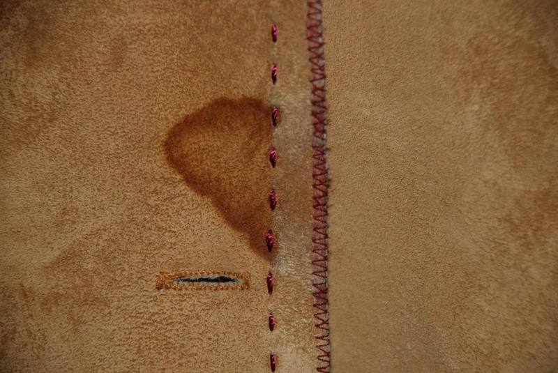

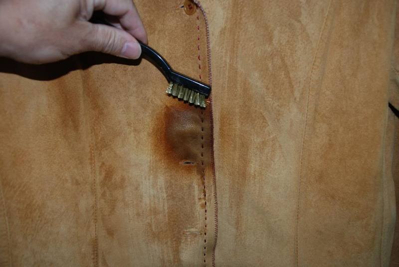

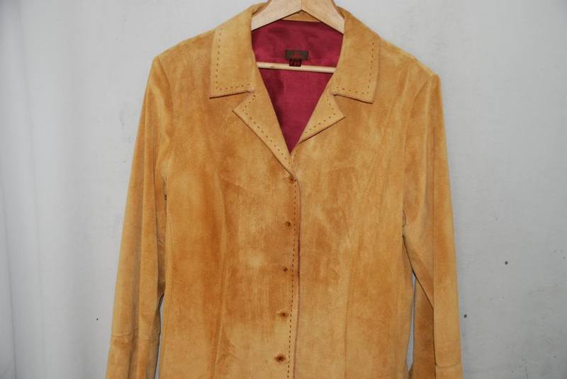

Here is sequence of pictures that show how stain from suede was removed.
Roger Koh
info@leatherdoctor.com
#1, before
#2, during
#3, after

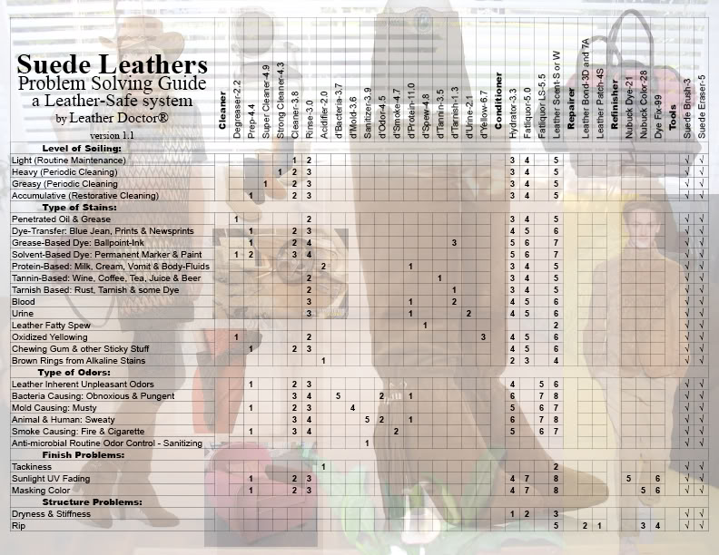

Leather Doctor®: Leather-Safe Problem Solving Guide-S9 - Suede[/center:3k5v69xk]
