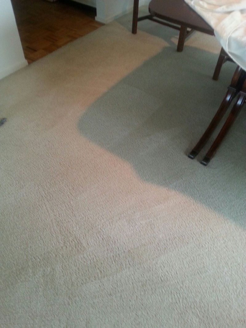

The previous picture was from today in the field. It was an accident that occurred over the weekend. They requested only remedial stain removal service:
