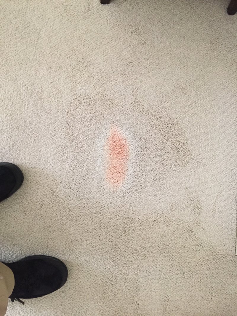

Sodium metabisulfite. Flush orange stain, apply Red X-it from Chemspec and heat with a wallpaper stramer over a white cotton tee.
What do I not know? It seems to be fading a little, but nothing like the magic act I expected.
And I'm getting older watching...
As good as it is gonna get. The carpet is bleaching now. Customer is happy, go figure.

Matt, at first I thought it was an old blood stain. I tried peroxide, no reaction. I tried oxalic acid for the iron, no change.
Rinsing each time, then all I could do was try the X-it. I had to stop when the carpet started to bleach. There is no caking or sediment in the fiber, so beats me.
On the bright side, the X-it made two purple ink looking stains absolutely vanish. So there is that.
