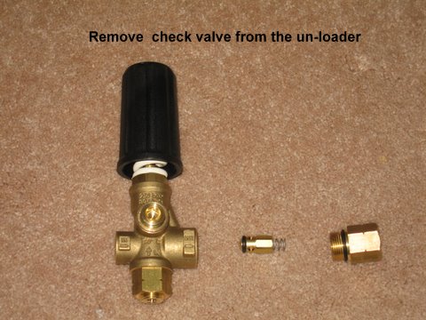

I have a Cat 3CP that uses a regulator/unloader. It bypassed back to the mix tank. Problem is when I pull the trigger on the wand it bogs the engine down and the belt for the pump starts to slip and smoke. The regulator/unloader is fairly new. Any suggestions?

did you remove the check valve......
