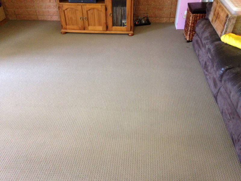

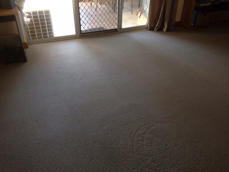

It started getting late so I decided to pull out the cimex and work on another room that wasn't as bad. I knew it needed extracted but time was running short. I left another guy on the wand and went to work. I mixed the releasit ridiculously strong with good results. Damn thing was looking better than all of the steam and muscle in the other area. I ran out of releasit so I ran to the supply house to pick more up. They sold some other magic juice so I tried it. The other half of the room looked like smeared grease. Terrible.

Compare the brightness of the first and second picture of the carpet with the pattern. It looks like crap.
My expectations of what it was supposed to look like was not met. I don't see how you guys deal with this all of the time.

Sounds like you may have built up residue as an issue from the crappy contained used. I would grab a good pre spray and scrub it in with the cimex, flush the crap out of the carpet first with your TM, and post pad with a little encap. It is probably loaded with soap hence why the flushing is needed, the post pad(use cotton pads) encap will help keep your wicking at bay, and help remove a little more soiling.
On commercial grade carpet, encap can and will make it look better than HWE a lot of times. I would flush the magic juice you got local out, and try a post padding with the release-it.
Just always remember to have consistent mix ratios when you are doing large areas, and to use the same products. I've done something similar when I ran out of my regular juice and used a heavier juice on the same area, end result was the same in having a noticeable difference where I used two different juices.
