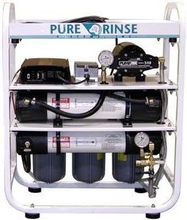

Found this at http://www.cobbcarpet.com/purerinse.html
Is this what zerorez is bragging about in all their propoganda?
Is this a must have or what?
At a cost of 4k sure seems like an expensive upgrade.
Anyone use one?
Reverse Osmosis Rinse System - No Residue
Removes All traces of Detergent Residue
1.9 GPM Output
150 lbs.
1/2 HP DC Pump Motor
Zipper Bag (Throwaway Filter Bag) or Shake-Out Bag
$3999

ZeroRez is spending many times what that RO system costs.
Dave Gill is using an RO water system in Florida and is quite happy with his results.
Without using any rinse agent, it provides the most complete rinsing process available.

You really don't need di for cleaning. Ro will get up to 90% pure. Ro does waste a lot of water but I think the bigger ones as in the pic waste much less. I think it's because it's under more pressure then the house pipes.
