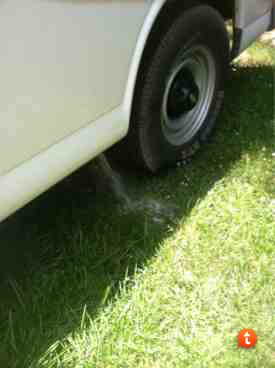

Yup, it was that time again today...
Jus felt it was needed after cleaning on a massive incline last week.
On LOW
Ease the hose to full stream while sticking it in the suk hole inside your waste tank.
Let it run an flush that crap out for about a minute.
Do It in the Grass : )

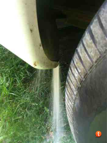

Silencer should spew water like this...
Cut the water off and let it blow the excess out once it is a fine mist out of your silencer crank it up and let it run.
Noise draws attention, i like making alot and telling people why.
Once its dry, flip it in low an squirt ya a shot of WD or another good lube down the pipe.
Glad thats Done! Cracking that tank Suks!
