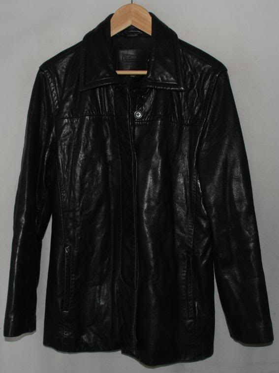

Example of Coach® Leather Jacket for repair & refinishing.

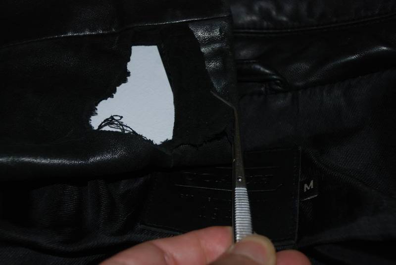

Example of Coach® Leather Jacket Rip at sleeve to be repaired.

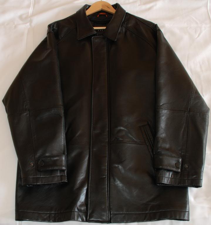

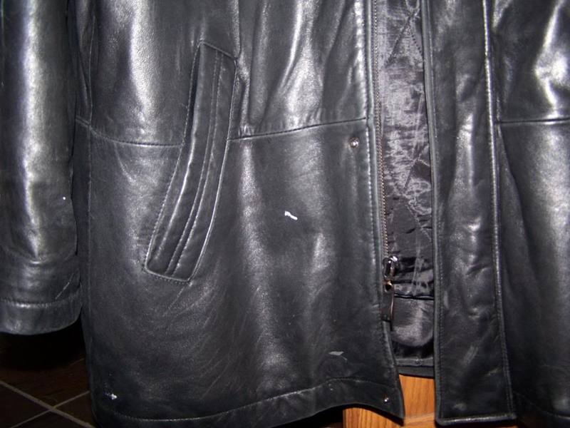

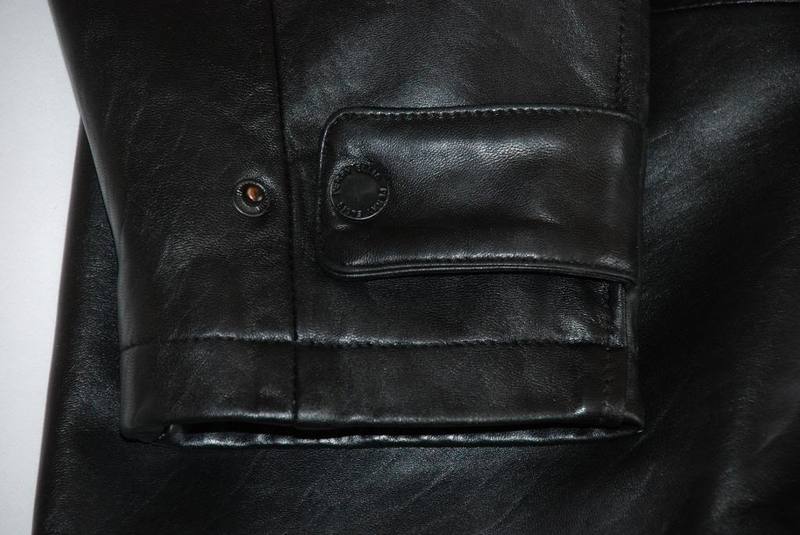

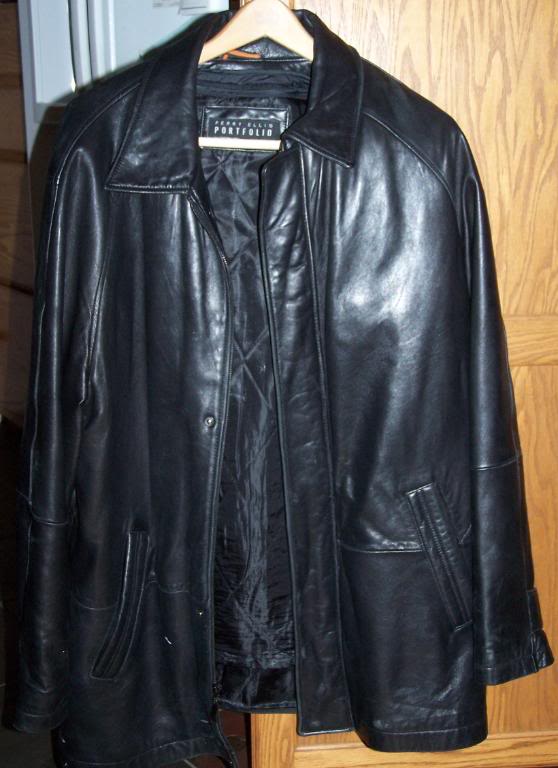

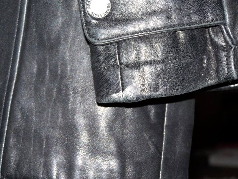

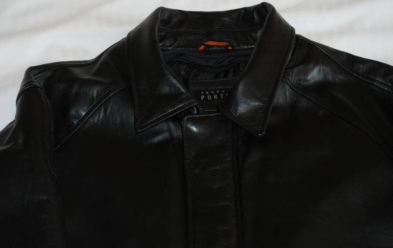

Picture #1: “PORTFOLIO by Perry Ellis” napa black leather jacket.
Picture #2: Several unknown white stains similar to paint.
Picture #3: Lost its “New Look”.
Well, we have another volunteer’s jacket to work on.
The concern is that there are several white stains that are similar to paint that need to get rid off.
And overall it has lost the new look.
Let’s have a quiz to learn about restoring this jacket!
1. What do you think this “PORTFOLIO by Perry Ellis” napa leather jacket finish type is?
a. Pigmented
b. Semi-Aniline
c. Aniline
2. What type of tanning process is used?
a. Vegetable Tanned
b. Chrome Tanned
c. Alum Tanned
3. What do you think is the “Breathing/Absorbency Qualities”?
a. Non-Absorbent
b. Semi-absorbent
c. Absorbent
4. The type of “Binder System” used as the base color?
a. Nitrocellulose
b. Polyurethane
c. Acrylic
5. Type of skin?
a. Sheep
b. Goat
c. Pig
6. Do you think it can be restored to “better than new condition”?
a. Yes
b. Maybe
c. No
7. Do you think, besides the look, the charm of leather appeals to the nose, ear and touch too?
a. Yes
b. Maybe
c. No
Take this quiz if you have interest in leather cleaning and restoration!

Roger Koh
Feb 7, 2008
175

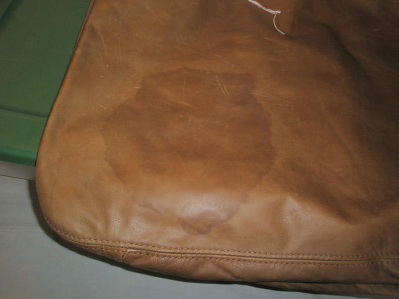

a. Pigmented
b. Semi-Aniline
c. Aniline
a. Vegetable Tanned
b. Chrome Tanned
c. Alum Tanned
a. Non-Absorbent
b. Semi-absorbent
c. Absorbent
a. Nitrocellulose
b. Polyurethane
c. Acrylic
5. Type of skin?
a. Sheep
b. Goat
c. Pig
a. Yes
b. Maybe
c. No
a. Yes
b. Maybe
c. No
It certainly goes against the norm as I was also taught that water “Pools” on “Pigmented” leather!
If so, how can these “Pigmented” answer for #1 and “Absorbent” answer for #3 be right?
Why semi-aniline is ruled out in this case?
The clue is in picture #3!
Roger Koh
LeatherDoctor® System
Jack May
That Kiwi
2,423
Palmerston North, New Zealand
John
I know where I may have stuffed up. On the cuff, the finish is wearing off and showing the 'blue/grey' underneath so to my mind that means it MUST be a pigmented finish.
Is the blue/grey the chrome tanning or the base binder system? If this is the binder base colour, how did you know from the photos that it was chrome tenned?
Is it absorbent because of the stitching, wear etc?
How can you tell that it is a sheep hide from the photos? Grain style?
John
Roger Koh
Feb 7, 2008
175
When you see the crust color the finish on top must be a “Pigmented” finish is correct!
Yes! The blue/grey color denotes chrome-tanned.
The binder system refers to the color composition other than the color itself. (Nitrocellulose, Polyurethane, Acrylic, etc, are referred as binder).
Absorbency depends on the binder of the color and does give a characteristic look.
Here the black looks warm and mellow - typical of nitrocellulose (Absorbent).
If it has a metallic “copper” glow - typical of aniline (Absorbent)
If it has a cold look with a much deeper tone than “nitrocellulose” - typical of semi-aniline (semi-absorbent).
If it is close to semi-aniline but has a stiffer appearance without the drapes - typical of pigmented (non-absorbent).
There are no hair follicles, so the pig is ruled out.
Between the sheep and the goat - sheep has smoother grain, spongier and surface nicks and abrade easier that shows a worn look over time much quicker.
Goat has distinct tighter grains and typically dyed thru.
On closer inspection goat is always lighter in weight and also has a characteristic smell that are not a favorite for fashion garment.

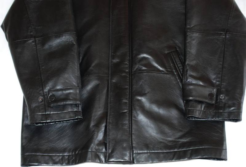

#1: After Refinishing - comparing to before picture above.
#2: Close-up at the cuff - comparing to before picture above.
#3: Close-up lower front where paint-like stain was - comparing to before picture above.
#4: Close-up collar without the wrinkles - comparing to before picture above.
What do you think of these results by sight alone, without experiencing the hand, feel or scent?
Your comment please!

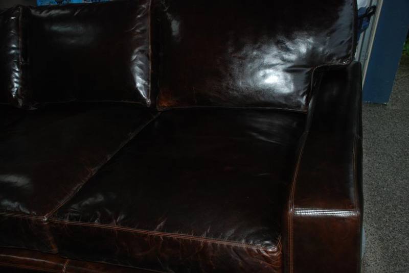

#1: Before

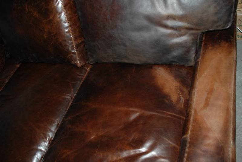

#2: After

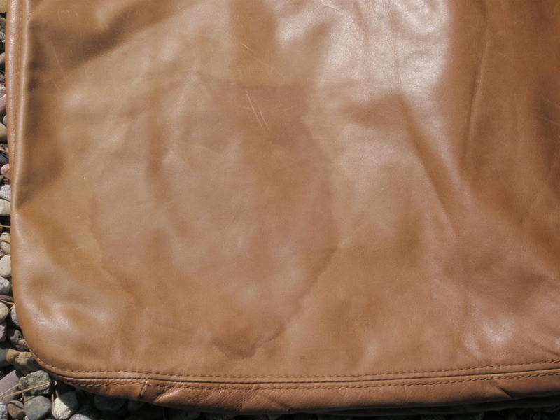

Hey Roger

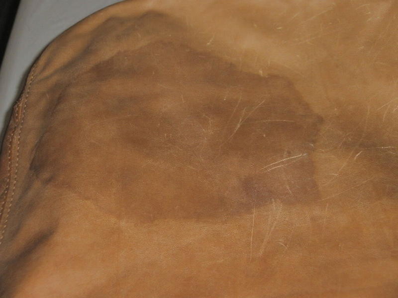

Nice seeing you in vegas please take a look at this leather and tell me if it can be cleaned, it is urineabout the size of a small plate
Thanks again and please give me your phone number and address

For the pics of the sofa Roger posted...
My guess it'd be a semi-aniline. I'd do the water drops test to see. All I've done up to this point on these different types is make my existing dyes work as best I can, try to thin down when necessary. Been lucky so far, but I know it's getting time I'm needing to get a set of aniline dyes.
Roger, if it is topcoat pigmented, but wore off, did you use your relaxer and fat liquor chemicals on it successfully?
Roger Koh
Feb 7, 2008
175
Semi-Aniline still have the opaque look can’t differentiate the difference from a pigmented without the “water test”.
No! The picture above is neither “Semi-Aniline” nor “Two-toned Pigmented” as John said.
These are the different “pigment” color coat for different leather types:
Remember they too come with matching “Topcoats” too!

Ron Lippold said:
Hey Roger
Tell us how the urine gets there, from human or animal?
How long ago?
Any attempt to it?
Looks salvageable!
Send it to me quick without delay (check your mail)!
As urine with time is a leather “denaturant”!
