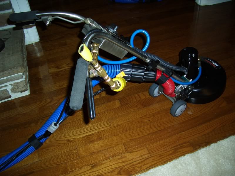

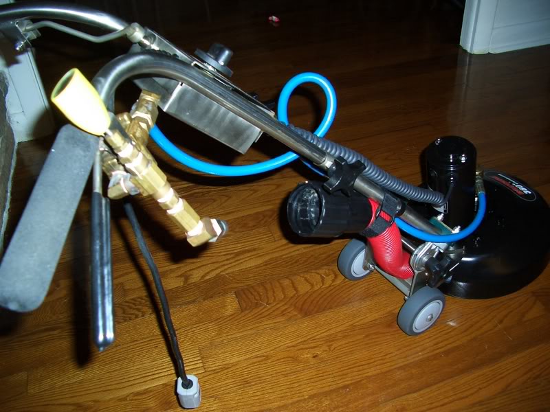

I have been using this set-up for years and I haven't found an easier way to manage the "extra cord" that hassles so many users. Also ultimate hose management. So here you go:
Cut the cord on the machine you don't need an attached 50 footer

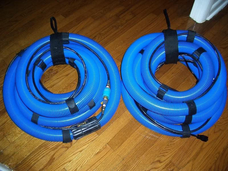

These are the two 25' lead hoses for indoor use only, neatly velcro stapped with my 3/16th ultra-lite Parker 540N. Notice one has a 25 ft power cord attached. These two and my multi-sprayer is what I first take in for a very fast and clean set-up.
Everything hooks up super easy.

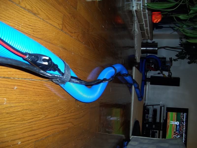

25 ft away and you can see I use a detached 25ft extention cord on the end, which I plug in way behind from where I'm cleaning. No cord hassles period.
As I back my way up extracting and the hoses bunch up, when its time, I unhook my second lead hose set, wrap it up, and quickly get back to work. Twin lead hoses rule, even when wanding. So thats pretty much it.

I hope that's 12 GA wire...we don't want your extractors motor to burn up. :shock:
FastEddie
Oct 19, 2006
435
First 25ft cord is half of what my 360 came with. Second is fatter, I think I'm covered.
