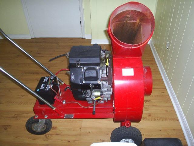

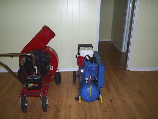

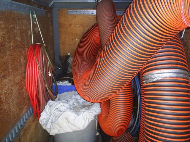

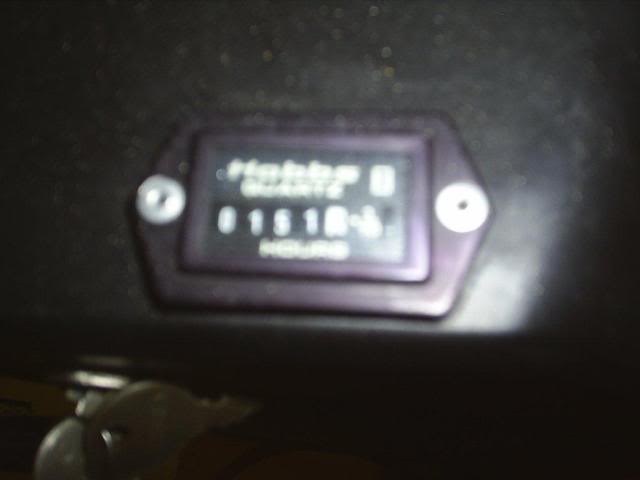

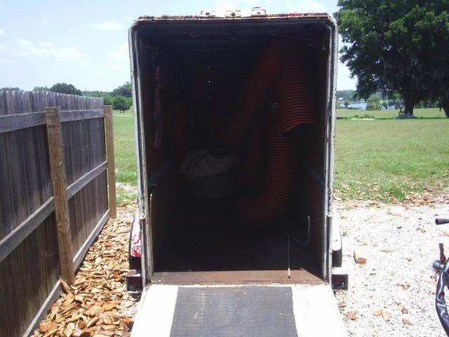

I found a $66,000 truckmount on a repo lot for 23K. The truck only had like 9,000 miles, buy used never new. Another alternative is a trailer mounted system like Atlantic Engineering sells. I would look at the Kleen King gas vac and compressor too pictured above.
