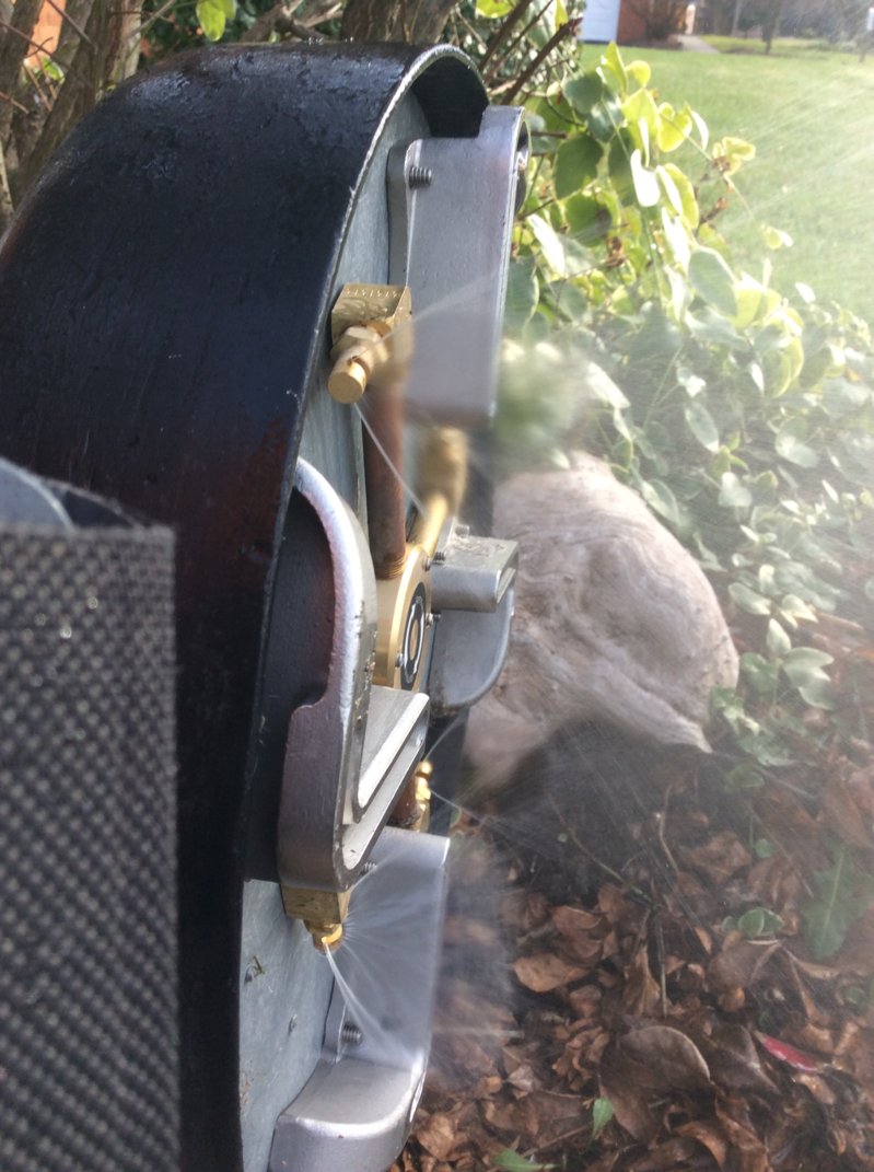

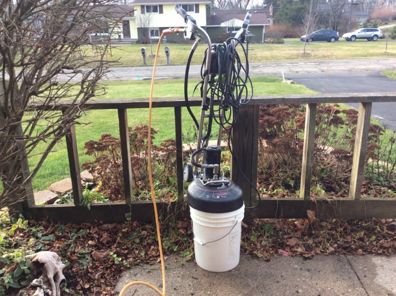

Kellie, the dual 3 stage CFX works perfect with the 360i; they were designed to work together. I use mine interchangeably with my Pro1200 throughout the day, some jobs the TM, some jobs the porty. This is what the business side of the 360i looks like hooked to custy faucet with a standard 100' Parflex TM hose:
I bucket tested this and a 5 gal pail was filled in about 6 minutes, which is plenty of flow.
Try it yourself; just hook your 360i to a faucet and run the vacuum from your TM and see if this is going to work for you. The CFX produces 230 CFM vacuum, as good as any dual 3 stage produces, at 40 pounds.

So I wouldn't absolutely need the dock thing right away then? I like it a lot, and I need a light one. Cool, thank you! And Hapoy New Year!

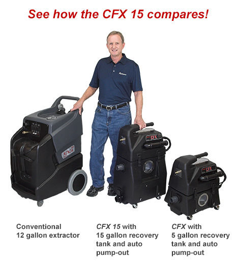

Make sure you get the right CFX.
I would dearly love the newer CFX 15, even though it is going to be much higher on my old 27 gallon docking station, which I rarely need to use.

I prefer the 5 gallon CFX. Put 10 gallons of water in a 15 and then try dumping it. Look at where the dump valve is located, it has to be lifted in order to dump and I doubt anyone would want to be in that position at a customer's even second floor apartment where there's no elevator. Even rolling the 15 around with water in it is not an easy task due to how low the body profile is to the floor.
In either case you're going to need to use the auto pump out which negates the need for the 15 gallon capacity. The 5 gallon unit is much more manageable and easier to carry around.

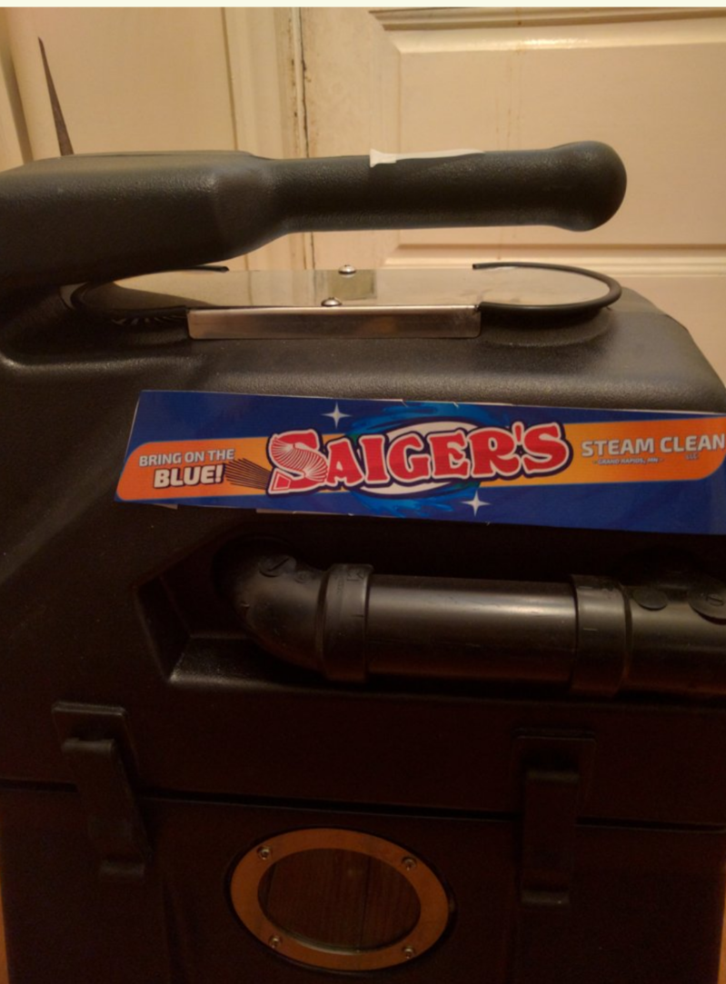

Me
My 15 gallon machine sometimes spits the water out too. Rotovac and I have discussed the issue at length a few times. I was told the issue was gong to be addressed because it's a known problem, but as of last conversation about it a few months back, nothing has been done. I and other users have sent Rotovac ideas and photos of things we've tried to mitigate the problem.
All portables do spit, especially when there's any kind of foam buildup. I just want you to be fully aware of the possible problems you could be faced with.
The CFX is a terrific little unit in spite of this spitting issue.
Unfortunately, sometimes the auto pump out fails, and if that happens with the 15 gallon you've got no choice except to figure out a way to lift the beast and empty it. The 5 gal unit doesn't have a dump valve but it's easier to lift in order to empty it if the pump fails. The pumps do and will fail.

Bob, my 15 gallon CFX only spit water out once and that was because the waste bag bar had fallen off the vac intake hole (because my CFX fell out of my van when the back doors opened while driving:hopeless:). You have to make sure that bar is set in properly, i.e. , the holes on the bar where the waste water falls into the tank are side to side not up and down.

And as for the pumpout failing, it is essential you put on an inline filter like the Devestator so no debris is ever allowed into the tank. My pumpout always works because it's always clean inside the machine. I don't even open the machine up for weeks at a time to look.
Yes, I do make sure of that. Adam at Rotovac was convinced at one point that it was do to the bag blowing up as a result of soaking. I don't know if Adam still thinks that - he recommended putting a rubber band around the bag, but that didn't help either. I and others tried making different shields to go between the pipe and the vac motors, but no love.
This is, according to Adam, relatively restricted to the 3 stage unit. The vac motors are simply too close to the vac inlet for the suction of the three stage. I was hoping that when they came out with the 15 gallon model they would lower the vac inlet but for some odd reason they didn't. Perhaps it is an expensive retool.

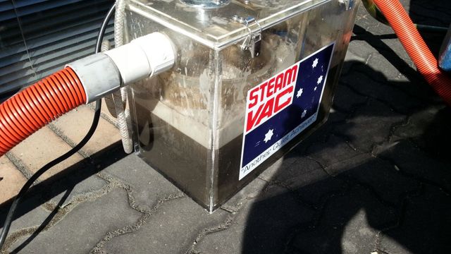

Whilst I don't have the 15 gallon CFX, I see that it does have a waste outlet down low as some have commented on.
Rather than try & lift it, why not simply hook up a vac; hose and drain it to an outside point??
Down under, in some states, it's still legal to empty the water to the lawn or garden bed as long as it does not go into any drain that goes to a creek, etc;
Other option would be to place a machine similar to a Flood Hog?? before the CFX.
I use an Aussie made Gulpa, basically a heavy duty submersible pump enclosed in a perspex box, which pumps out on auto.
Just a thought.

question wont a 5 gal. bucket fit under it to drain?
Not unless the CFX is on the docking station. See post #12 and note where the dump valve is located. The 15 gallon model is the larger one that the person's left hand is on (unless, of course, it's a mirror image which would mean that it's actually the person's right hand on the unit).
11,456
I see it way down at the bottom I was looking at the vac inlet at first. Ya that's almost impossible with out a pump out.
