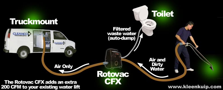

In the Rotovac Demo video the machine does not have another outlet to the truckmount. It may be something they have just added.

Rick, not sure I understand your post mate.
I can't see any reference to a truck mount, or any connection between the two machines ??
The CFX is a stand alone unit as you seen in the video.
It does not have a solution pump as such, just uses faucet water pressure, (I'm learnin' your lingo :wink: :lol: )
It does have a couple of vacuum motors and a waste pump out that they call a deflood pump or something.
The only thing that I could see it being hooked up to would be an inline set of vacs; before the waste water gets to the CFX, to increase vacuum.
I can see no benefit hooking up to a t/m or even a porty; because all they would suck would be from the waste pump, not adding to vacuum pressure.
Or do I read it all wrong, again :?:

Also, I've seen somewhere pictures of it shown as a TM booster where it is used as both a booster and while doing so pumps out to the toilet. Does anyone know if it can really do this?

That's the picture I saw. However if you go to the rotovac website and look at the pics of the machine as well as the video it is pretty clear there that there is no port in the back of the machine where you could put the hose they show running out to the van.
Somebody who owns one please clarify.
As far as the PSI issue, just get a Cleancraft "Rescue Box" and drop it in any sink, bath-tub or bucket and you're in business at 150psi.

Hi Grant, Go to the Rotovac site and look at the CFX manual...it shows the latest model with a port in the back.
