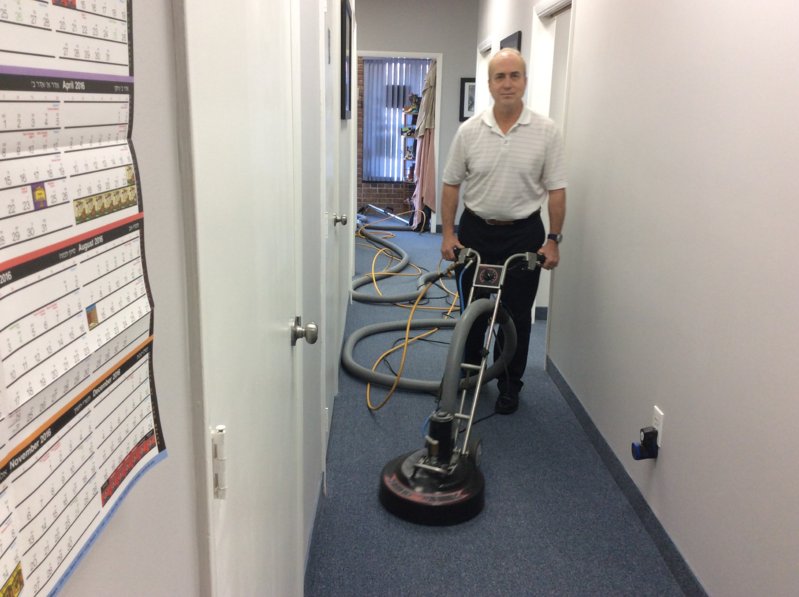

And a 5 minute transmutation turns your 12" 360i into a 15" large area CGD killer.
With it's four Teflon GreenGlides the 360i 15 floats on the surface and is the fastest and lightest rotary you can use.

I might need to try that head right there on my 360 XL...
I am going to call and just see if I can't get the Teflon glides to put on one of my heads to try too....
115,883
The round glides replace the swoop shoes, rather than fit on top.
Far less aggitation.
Probably fine with a small machine, but.it still bogged seriously under the power of my VATS

There's no bogging at all even when running my Roots 56 full blast and I doubt this would bog with your Vortex. As for level of agitation, I would put it somewhere between the Zipper ( or other wand) and a swoop head 360i. That is to say, perfect for most situations not in need of restorative cleaning.

We were smoking the motor Art..
Not my imagination.
I don't doubt you Mike. I was sent a 360i that ran hot and overheated and smoked and finally puked. It had a bad motor so Rotovac just sent me a new machine which has run nice and cool and flawlessly for 3 years of daily use. I think those weak motor problems are a thing of the past. I wouldn't run a 15" swoop head because that would probably destroy that small motor, but the Teflon glided head moves very smooth even on plush carpet, but especially on CGD,
115,883
That head is a must if you value the lightweight of the 360i and are the sort of cleaner who wants to RE every job to maintain their USP. Delicate piles, weak seams etc..
Lots of situations should not be cleaned with the aggressive vacuum shoes found on the RV machines. Or the HOSS and Trex for that matter.
The HOSS has nearly identical glides available for it's head. The Trex does not as far as I'm aware.
