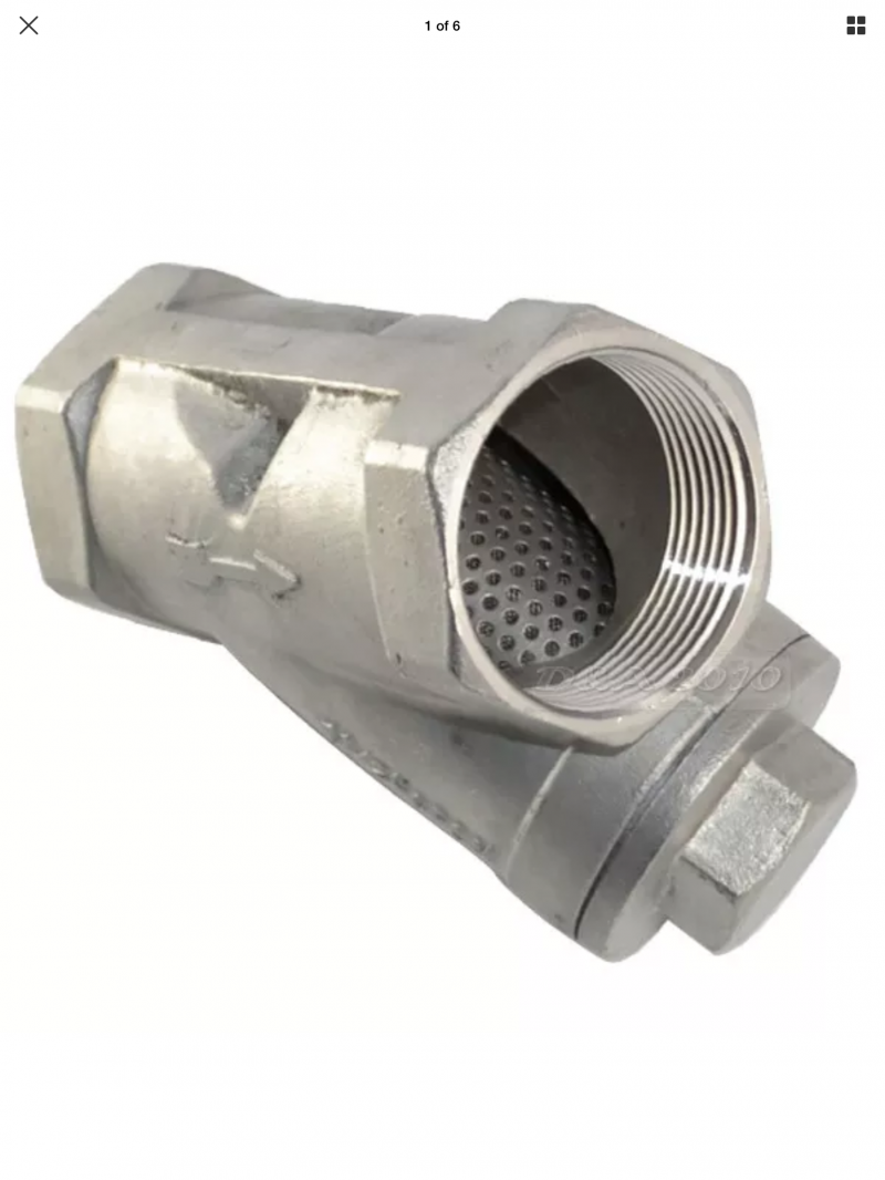

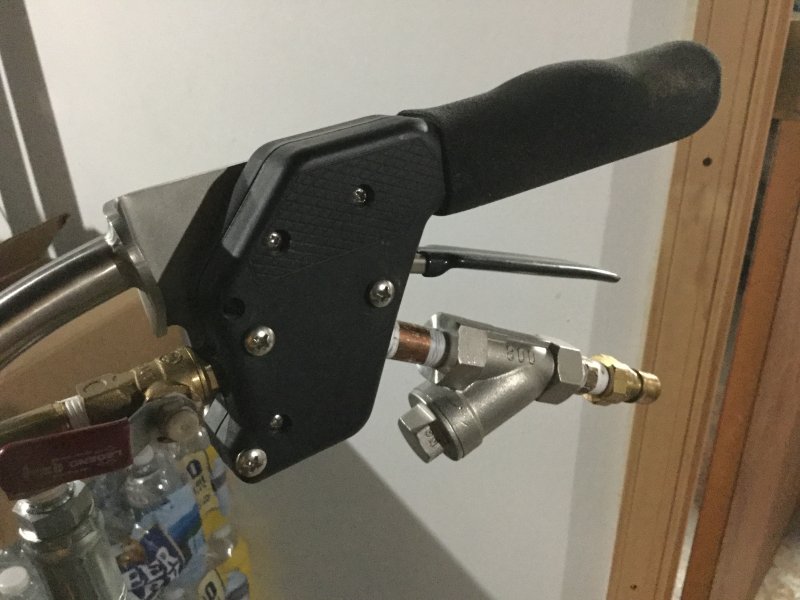

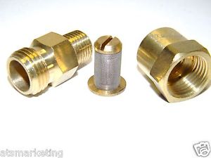

Jets kept clogging like a pain in a the rear so I added a strainer right after the male quick connect. Problem solved. Some idiot to the highest degree called Joe ButStool over at Dishonest Cleaners said it was a defect from Rotovac since it was a demo unit so I needed to replace the jets with his silly little jet strainers. Not so. This 'Y' strainer is big enough that I have not had to unclog jets nor clean out the strainer since installed. You can go many months and not get one clog. Save money on those silly jet strainers. Just unscrew one cap from the 'Y' and clean the inserted filter. Done. No more messing around with three or four jet strainers. You can add this same Y' to your solution line right before the female quick connect and never have to worry about the jets clogging on your wand.
Be sure to buy a sheet of the 100 Micron screen mesh on eBay to add into the 'Y' for extra protection.

that thing is huge, why not a normal industry inline strainer?
If your an idiot cleaner then yes your liable to hit something. I couldnt imagine how in all the months Ive been using it.
Yes its huge.
But guess what? It works well and have not had to clean it since Being installed and not one clog. So it works fine and thats what counts.
I like those inline, flushable strainers. You should be able to blow the glop without removing the screen, by removing the cap and turning on the water.
However, if that was mine it'd be upstream of the pressure hoses.

There you go duds…you can put it just about anywhere you see the need.
That's a good tip Stephen…flush that puppy
There you duds…you can put it just about anywhere you see the need.
We used the grandpa version of those on shipboard firefighting piping. Anything that got sucked into the firefighting main from the ocean could be dumped before it clogged nozzles or pumps.
