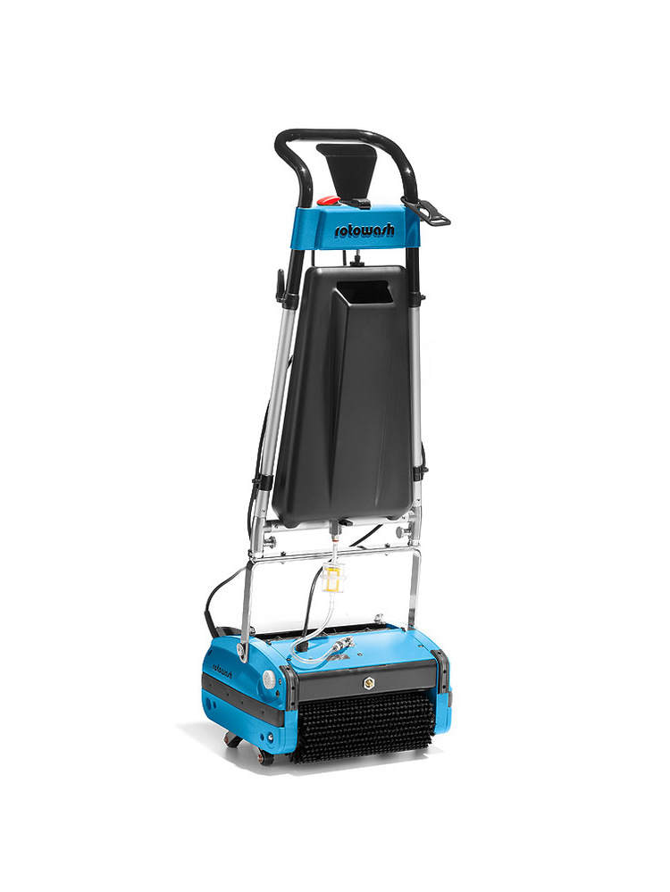

Looks like a line of CRB machines - several different models.

Rotowash is HUGE all over the world, relatively unknown in the US, you can see many different sizes and models at:

I use one from powrflite. Works well, counter rotating brushes water and soil to rubber roller in middle, scrapes off in holding tank. Main problem is that eventually it spits clumps out all over the place

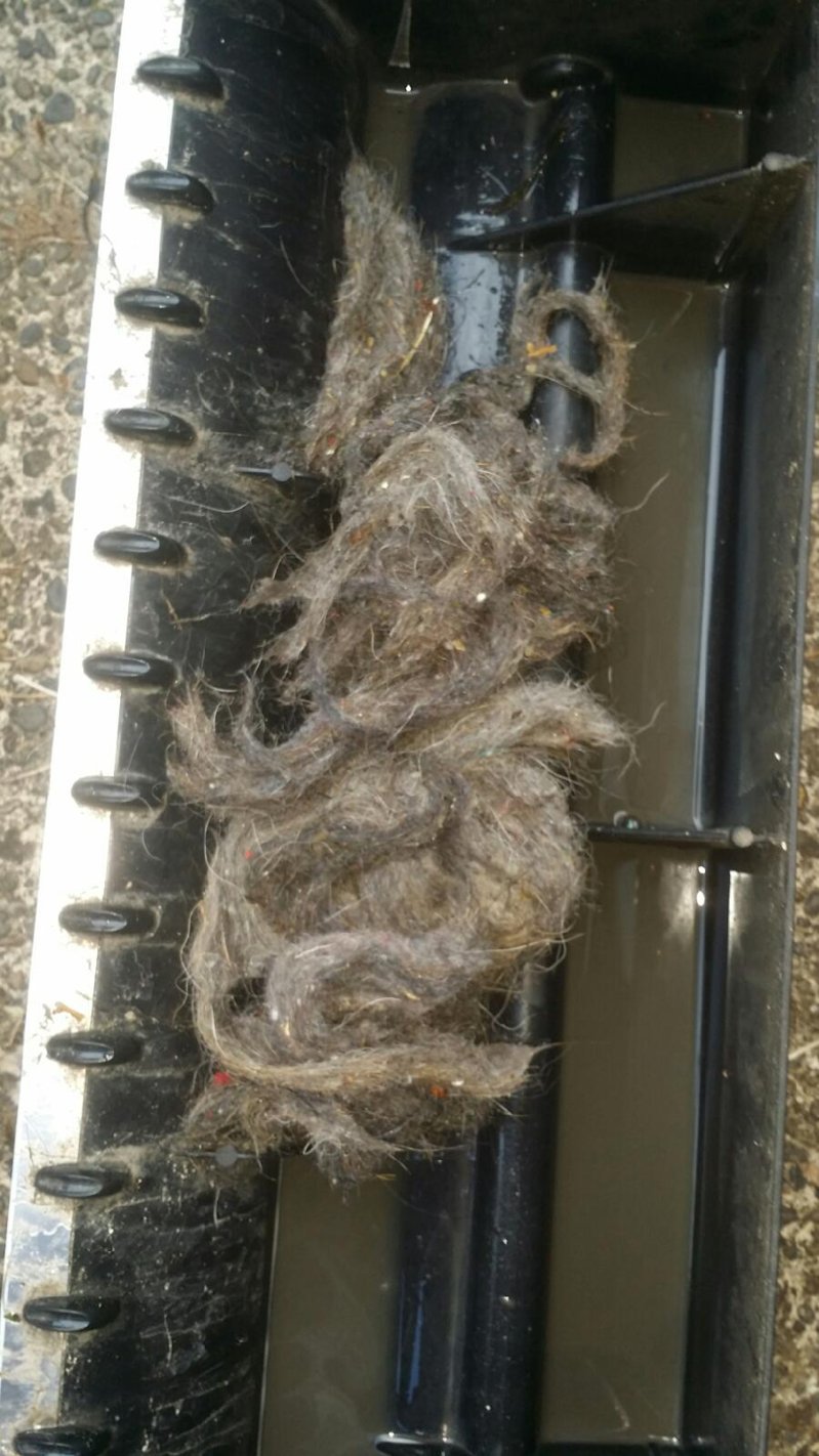

It has a waste tray / reservoir , debris and water collection, yes it will pull stuff out carpet like crazy, and I avoid spitting clumps out by stopping and cleaning machine when it builds up , before clumps happen

On the rear. I think the problem is it's too efficient at digging the crud out of the carpet. Even though I prevac thoroughly, it still picks up a ton of stuff. Kind of a poor man's duplex machine

To cleam machine, you have to dump waste tray and vacuum or hose off brushes and roller. I bring a small wet/dry vac and turn the machine on it's side, run the brushes and vacuum at the same time

When cleaning, if I get build up of hair and debris, I periodically remove manually with my hand, end of job cleaning , I have a 1" deep tray that I pour water onto and run the machine to clean the brushes, then wipe down with towel
