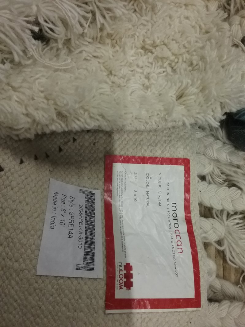

I have been asked by a customer to clean an area rug that I'm not feeling too confident working with. It is labeled as 100% wool, has a shag pile and of course is mostly off white. Not to mention that a cat barfed on it.. spot goes all the way through to the back.
I haven't made any promises to the customer that dropped it off.
Any advice? I don't have a pit, or specialized chems for wool.

That braided fringe is going to be a bitch to fool with. I'd take it to Burns.
Choose an easier one to play with. This one could bite you.

If you are going to persist in this, one-raise your prices, maybe $165.00. Without have a rug pit or similar, the one tool that will really help you will be a 175 with a solution tank. After prespraying the rug with a fine fabric prespray and letting it dwell, shampoo the rug with the 175 using a fine fabric shampoo or Prochem's cotton shampoo. On a white wool like that, it will help with brown/yellow stains. Shampoo both side. you may have to hand clean those fringes. It is really hard to rinse with a wand. First sprinkle rug with crystal defoamer and start rinsing with just hot water. Yes, you can use heat on this one. You have to thoroughly rinse both sides, take you time, multiple passes with the wand and multiple dry strokes. Groom it and put on rack or put blowers around it to dry. Ps. you may have to take your hose cuff to the fringes to thoroughly extract them. Lotta work for $65.00

That rug should be picked up,
immersion scrubbed with detergent AND Reducing agent,
brushed, and dried hanging.
Charge ~$240.
