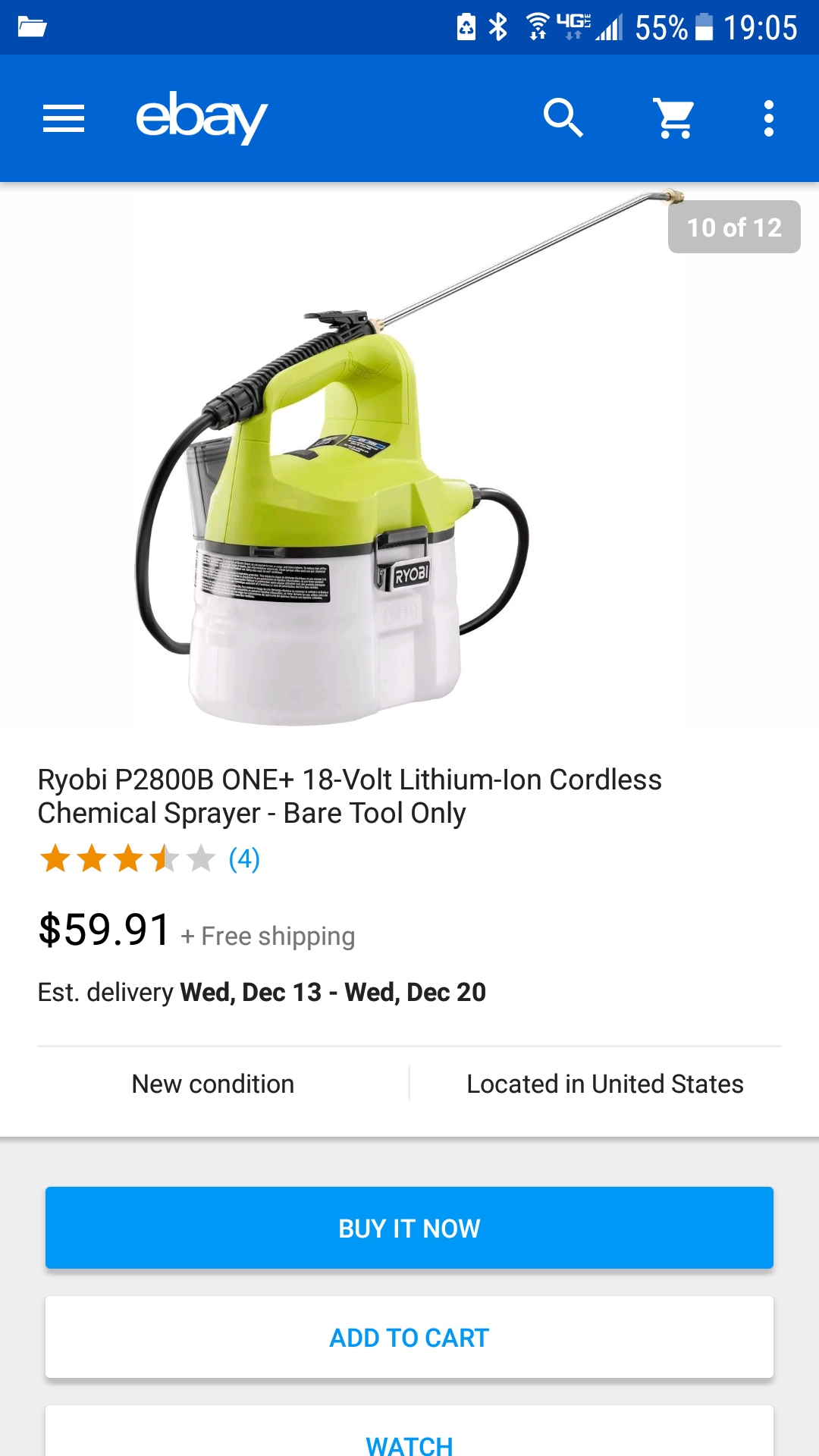

Anyone using this sprayer?

I have liked mine so far, though the measuring cup/cap broke pretty early on. My only complaint about it is that it doesn't have a fan tip, only a cone tip; and it doesn't have a high enough gpm to be a must have on the truck.

Anyone using this sprayer?View attachment 76204
Yes, I make a lot of EZ $$ with it too. Best 79 bucks I ever spent.
I use it exclusively for applying fabric protector.
The trick is to replace the wand with a new one from the hardware store that will accept a 8015 T-jet. Think the replacement wand cost me about 9 bucks. Simply unscrew the ryobi wand and screw in the new wand w the t-jet and your ready to rock!
Than, sell Fab protector on every job to increase profits.
I have one
got it as a free promo offer when I bought some hedge trimmers .
I like the hedge trimmers , but wasn't impressed with the sprayer .
Not enough volume for my preference
for the "price" I paid, it's fine for spraying weeds in the mulch beds and shooting range pad.
But don't figure it would hold up to any professional crew use/abuse

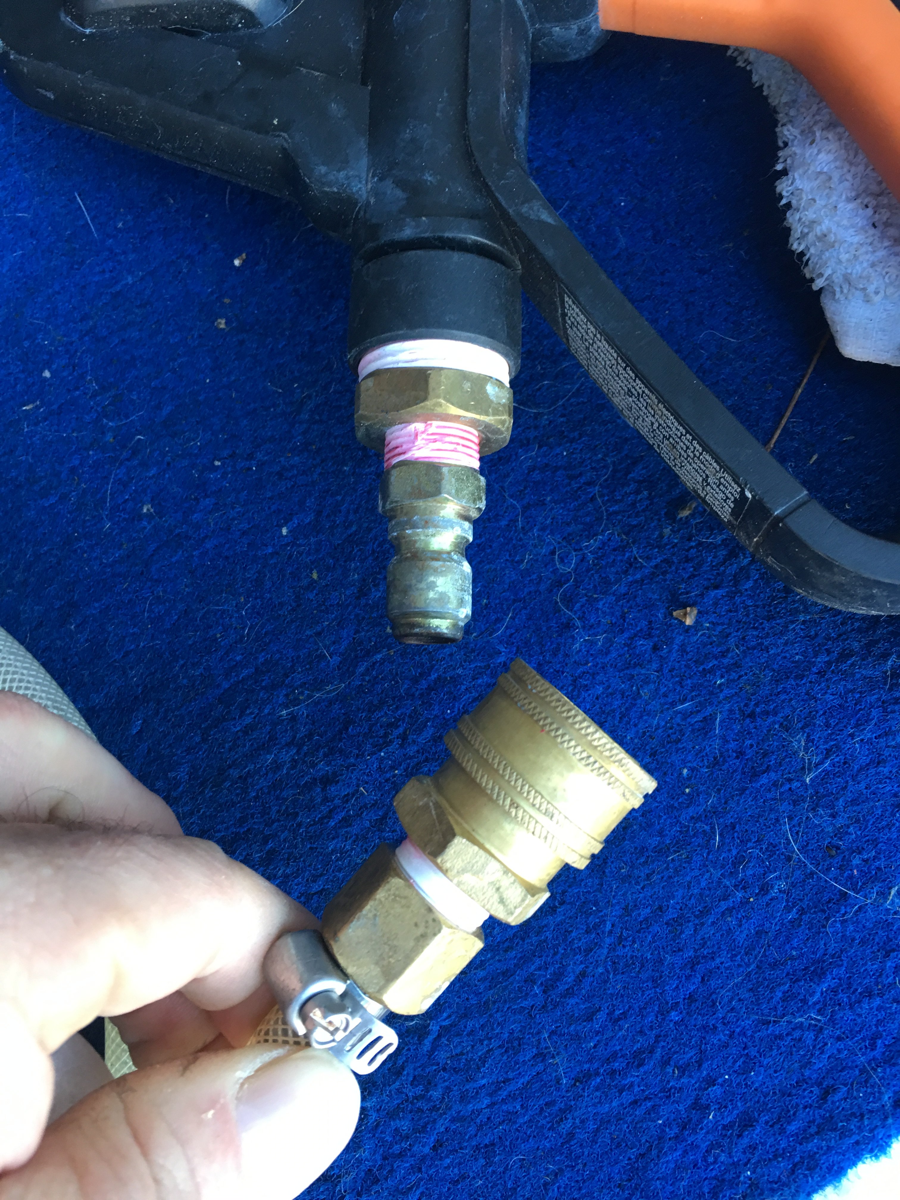

Sorry I was too tired last night to explain. I had the same issue. The plastic QD’s are crap and let in a lot of air. You need to replace them with brass fittings. Since doing this I’ve never had an issue.

Thanks Damon I'll dig mine out and try to get some brass ones.

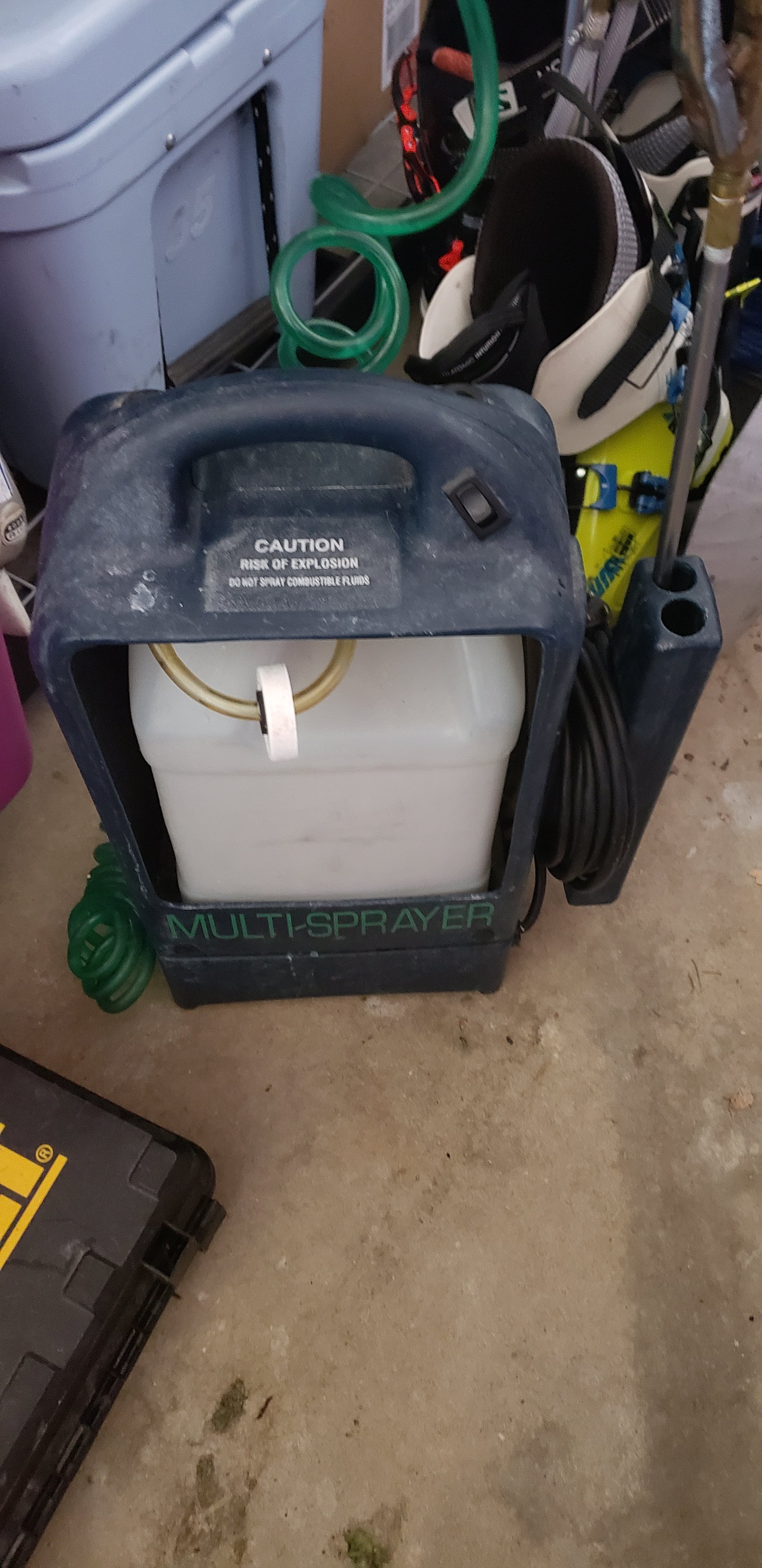

Tossed my Multi Sprayer in the trash when the regargable battery finally died.
