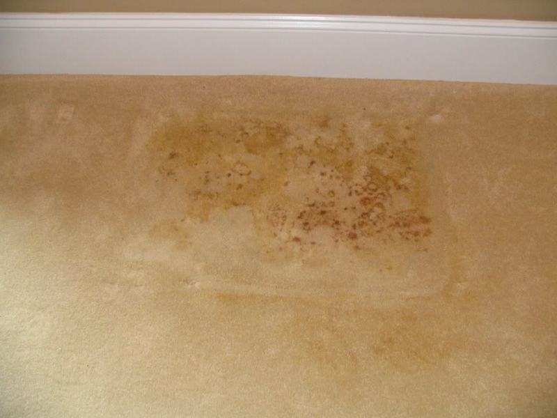

Here is a large stained area, approx 32" x 32" or so and the repair was made from the back side. (yes, for all that may say it was at the edge of the room, that is obvious; it still shows what is being suggested; I will still do this even if I have to move a lot of furniture, if it will make the repair better).
here are the clips where I had to put together two pieces to make a donor piece
Notice the boards used to work on; this is the portable floor I take with me to work on
when I am in a home; gives a very stable surface to work on
Here is a clip with the carpet dis-engaged and working on it from the back
Here is a partial clip showing some of the hand sewing at the corners; this method really allows one the ability to make a very good repair
This is just a suggestion but it is a close example of what I think you are describing and how I would try to repair it, from the back side of the carpet, if possible.
