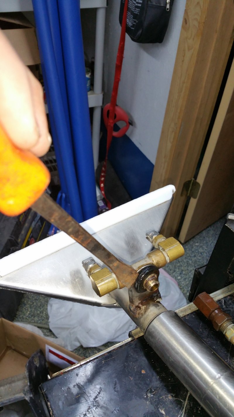

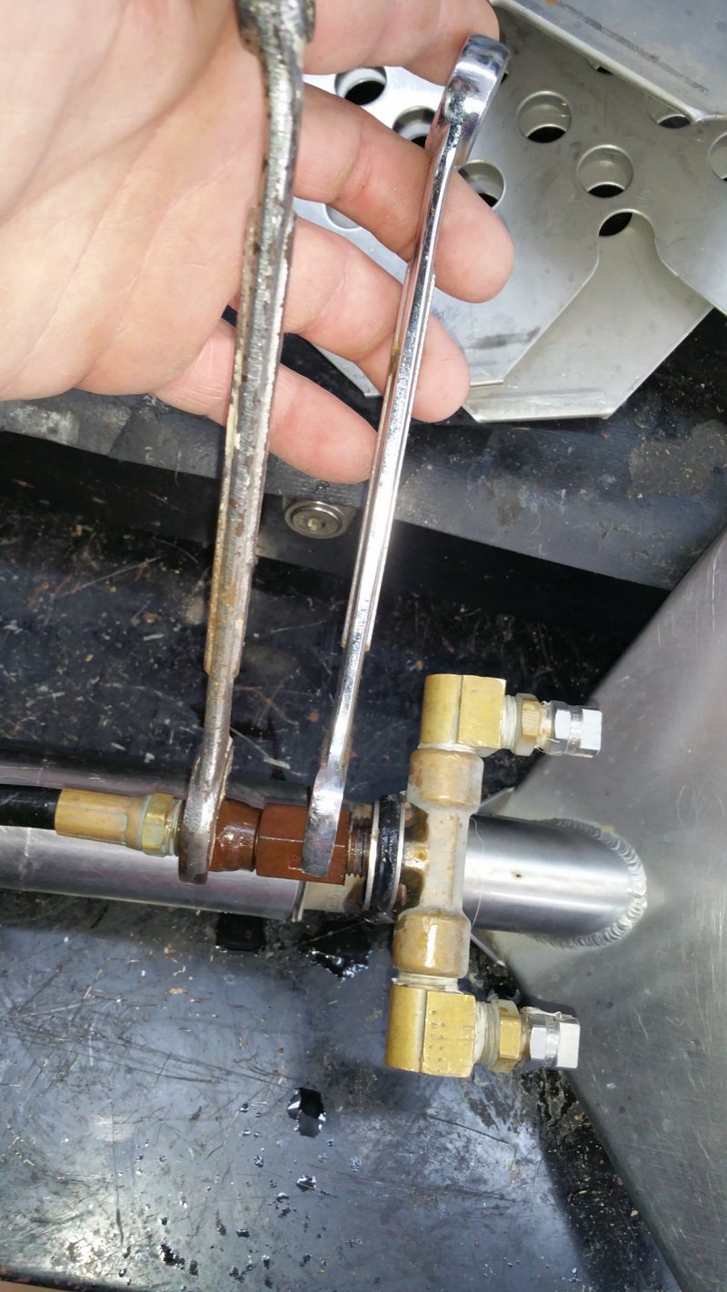

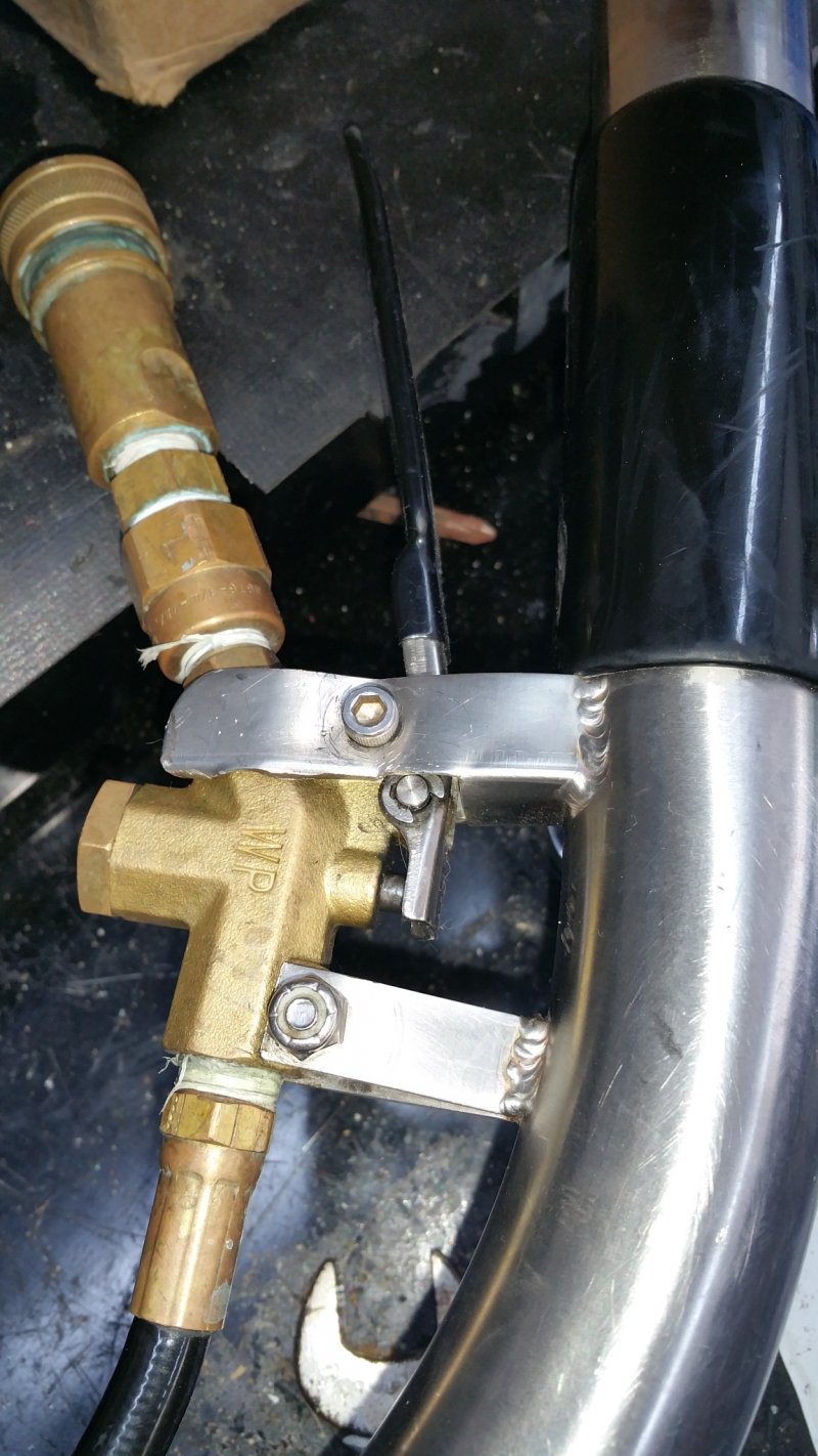

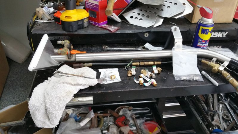

Smaller, the tool, the more opinions and preferences....

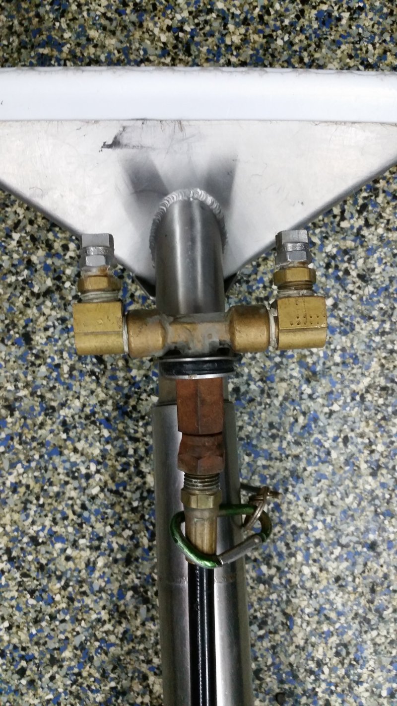

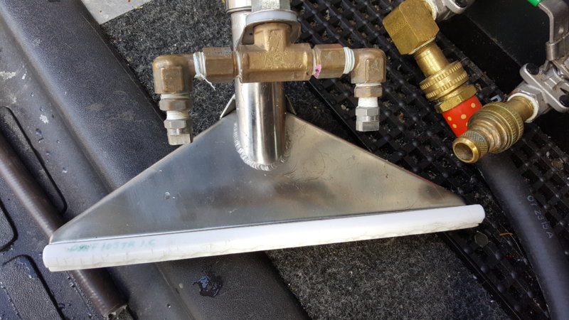

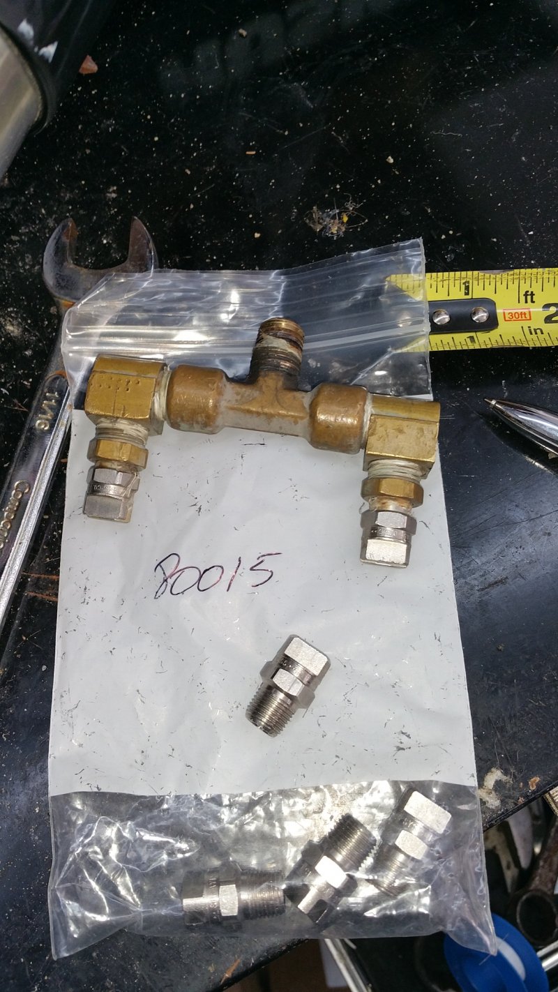

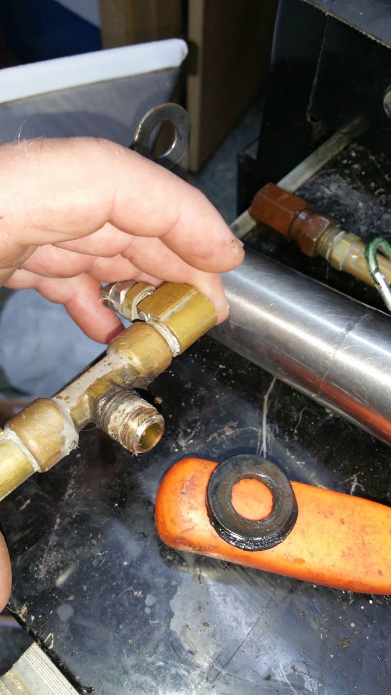

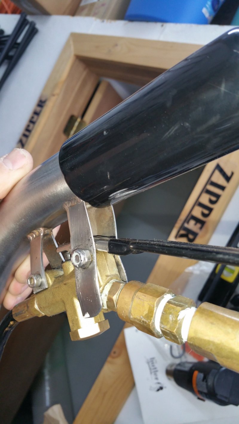

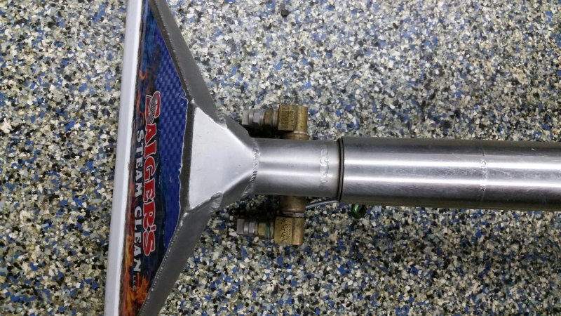

But, this tool works very well for us.

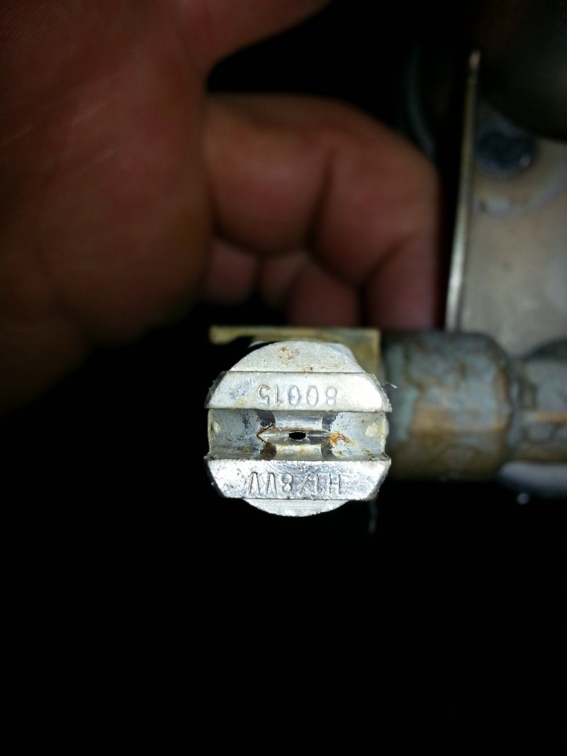

We do not like it in stock form especially with a single jet....does not give enough impact and flush.
We make it dual jet, add a Greenglide Hybrid, 80015 jets, and entirely different tool!
Everything descript in the video, but....everything is 1/4 inch pipe thread.

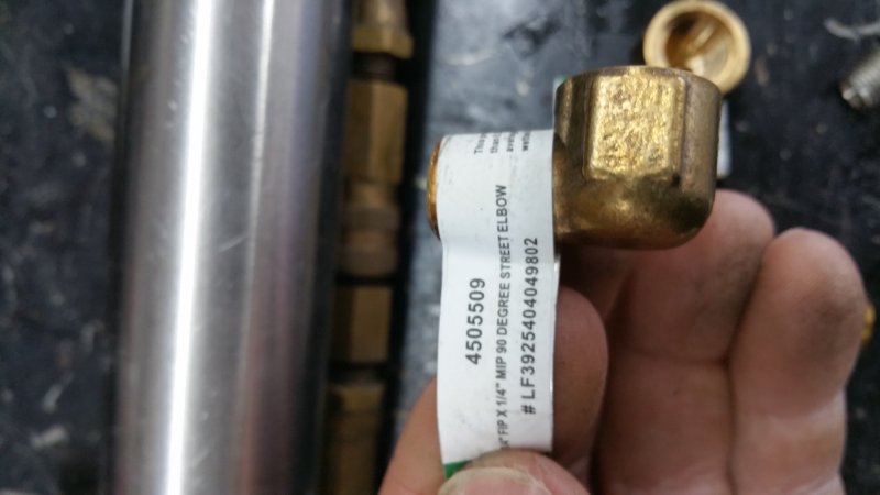

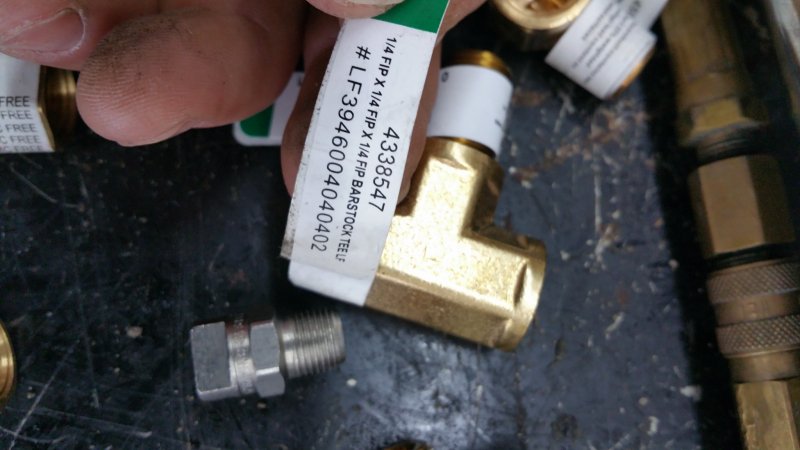

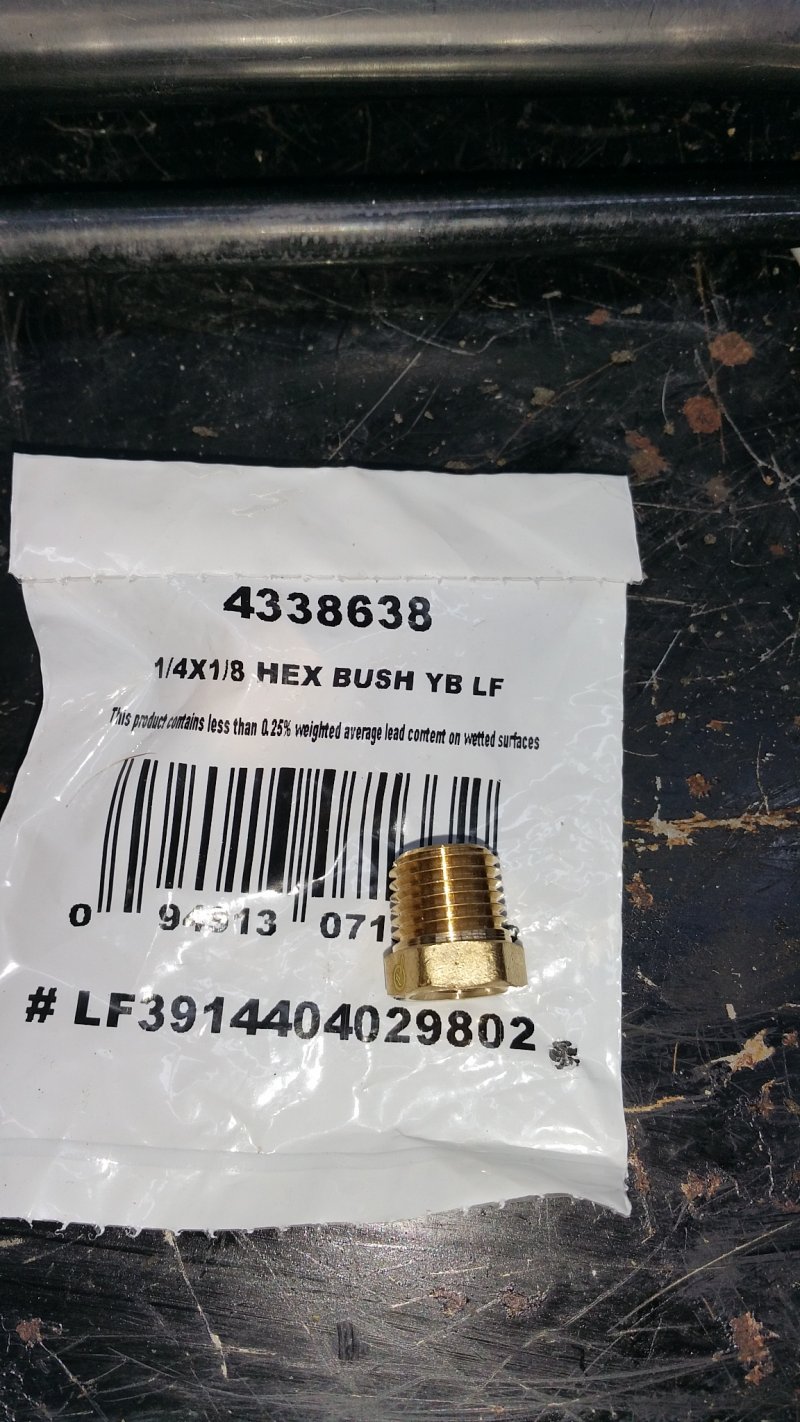

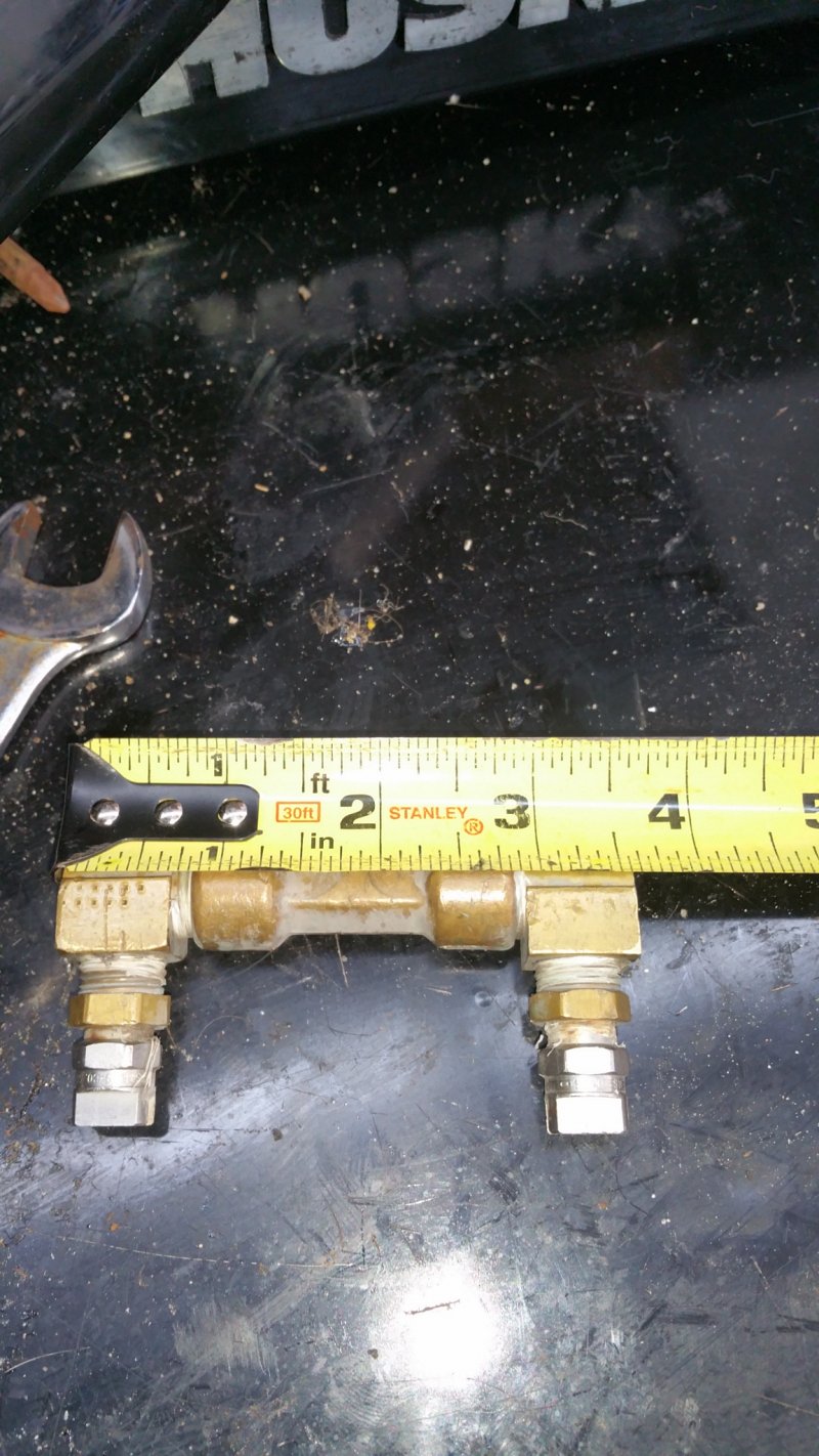

Parts needed:
* One Brass T (prefer Female, Female, with Male in center) 1/4 inch by 1/4 Bar Stock T
* One Brass nipple that is 1/4 inch if did not find Female, Female, Male)
* One 90 degree 1/4 inch by 1/4 street elbow
* Two 1/4 inch by 1/8 Hex Bushing to reduce for the 1/8 inch jets
* might need to lengthen center T bar so recommend picking up Two 1/4 inch, 1/4 inch adaptor just in case
* Teflon Tape
Here is the video of it: Best wishes....

I did mine w 11015 jets-- not enough water-- going to 11003 jets instad.

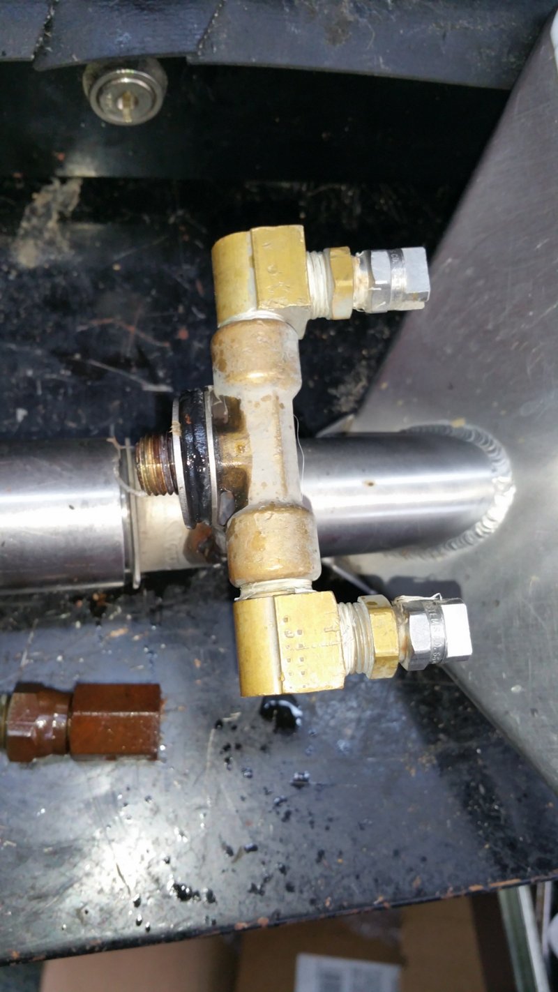

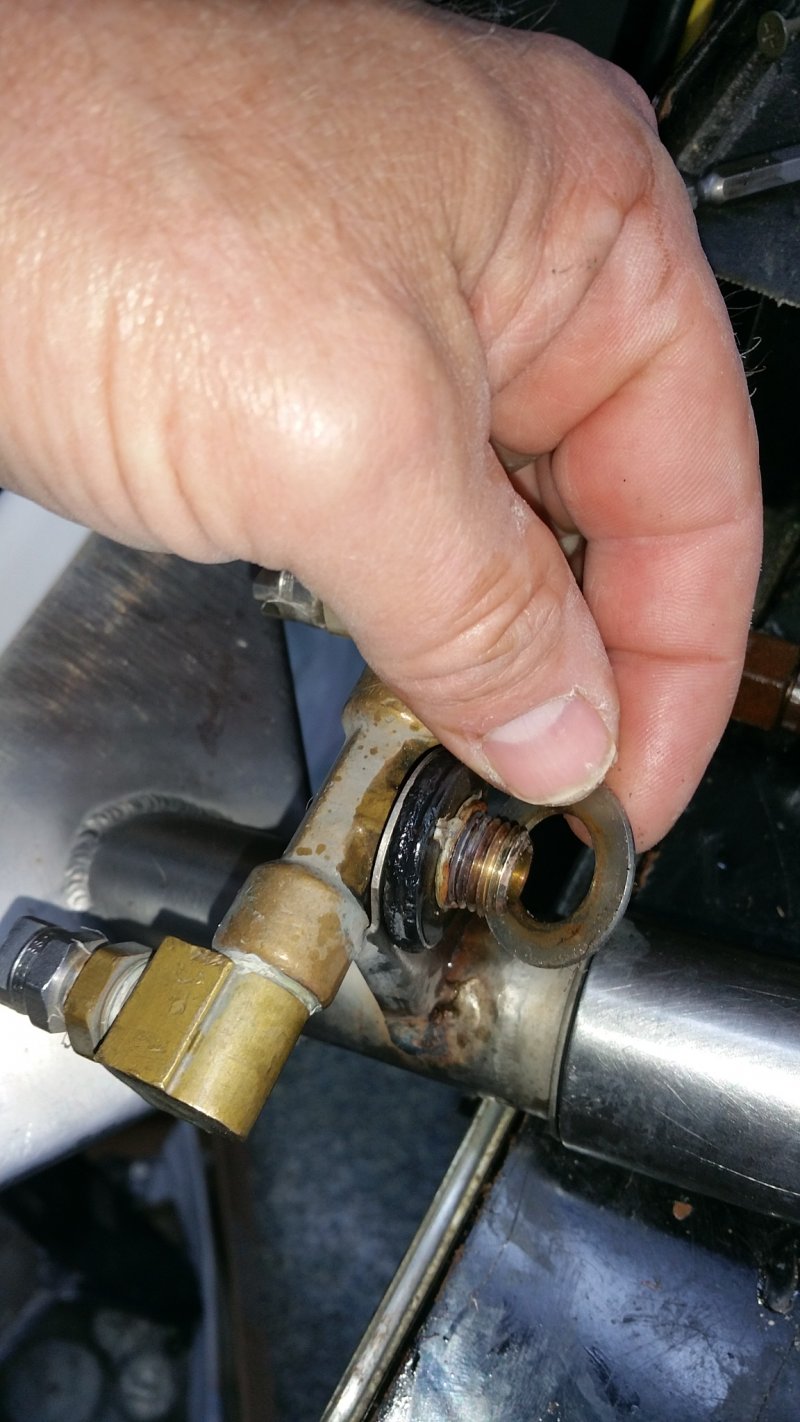

Hey @Mark Saiger, I'm finally getting around to doing this. I saw you made a bunch a while ago. Do you prefer just using the hardware store parts, or is it worth it buying that specialty T from amazon? Or doesn't it make a bit of difference?
11,199
Grand Rapids, MN

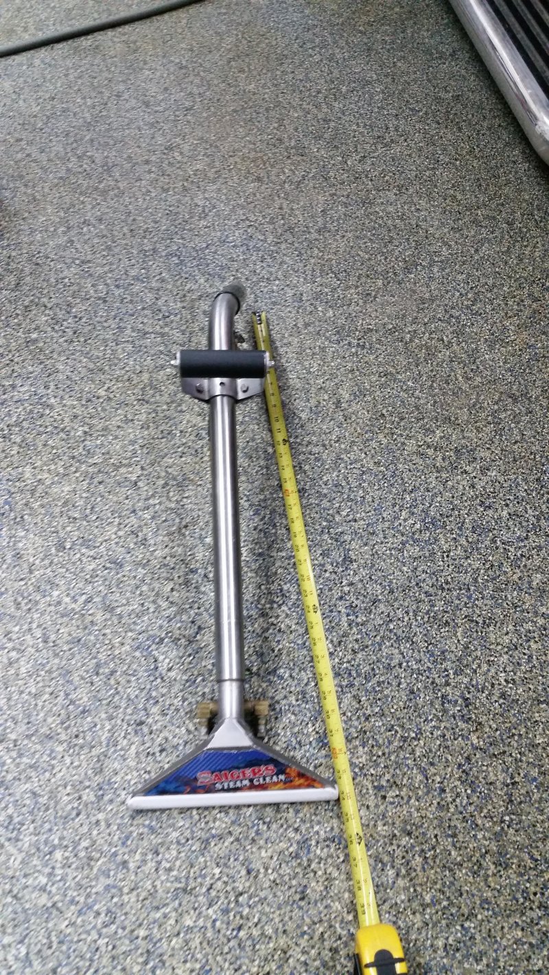

Found the hardware store one just fine... Also, leaving the spacers in has been better that I might have taken out in my video.
Here is a pic
Reactions: D Luke
