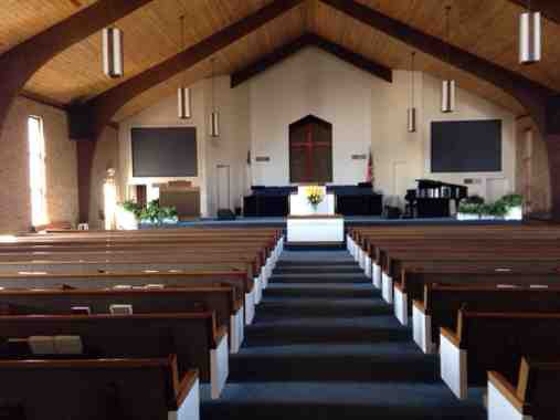

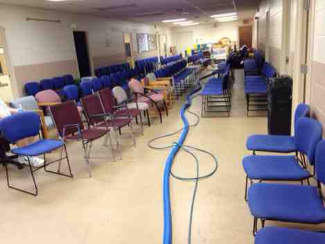

I used my SS to clean 34 church pews and over 150 chairs the past 2 days. It's a great tool and I'm really tired...
