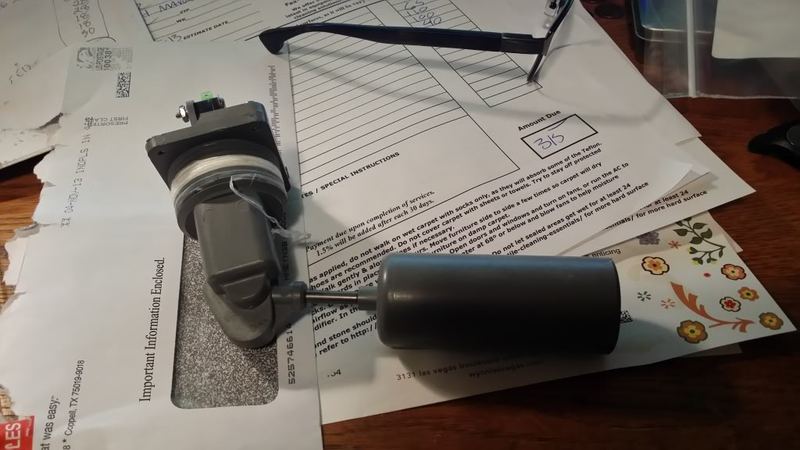

It ended up being the waste tank shut off float..the extra waste tank we installed was not plumbed the best way and it was creating lift in the tank bringing the water up to flip the float switch..we tested the theory by running it till the unit shut off then dumped and fired back up to run balls out again..
So a few parts and hoses to do a little routing of hoses to connect the waste tanks and we will be good to go..

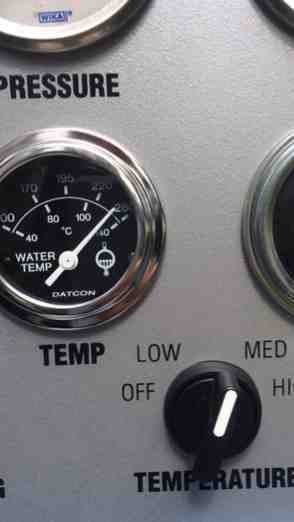

WOW this thing is pretty sweet..gets crazy crazy hot and has massive vac..runs super smooth and well beyond my expectations..very very happy
I run it on med heart and get 240-260 deg..I'm scared to run it on high lol

those float valves are problematic in general.
water gets in the body and shorts things out, plastic is brittle..
I doubt these were made for this shake rattle and roll application.
15,251
Mine went out in my cleanco and I just rewired and bypassed it.

Crank that thing up and see what it does.
Aint got 3 speeds for looks dude : )
Mike
These are actually pretty darn reliable and well suited for the application when properly placed in a waste tank. Our warranty rate is less than .7% and improving actually. Unfortunately problems that manufacturers have with these switches that then impacts the cleaner are generally the result of simply not dotting the i's and crossing the t's as they say. Reliable product engineering is the result of knowing that the devil is always in the details. Proper placement within the waste tank is critical and the easiest place to place the switch isn't necessarily the right place.
I agree...Harwil makes some of the best float switches out there......the hardest thing about them is sometimes getting them screwed in with out breaking the float off.....

Yep.....you can lay that needle over if your not careful.....and she will hold it to....this machine has and does everything you need it to and then some....

The only trouble we ever had was someone bumping and breaking it or a hose hitting it and breaking it. Putting a cover over it protects it from happening and allows us to squeeze the reel closer to the unit to save space.
