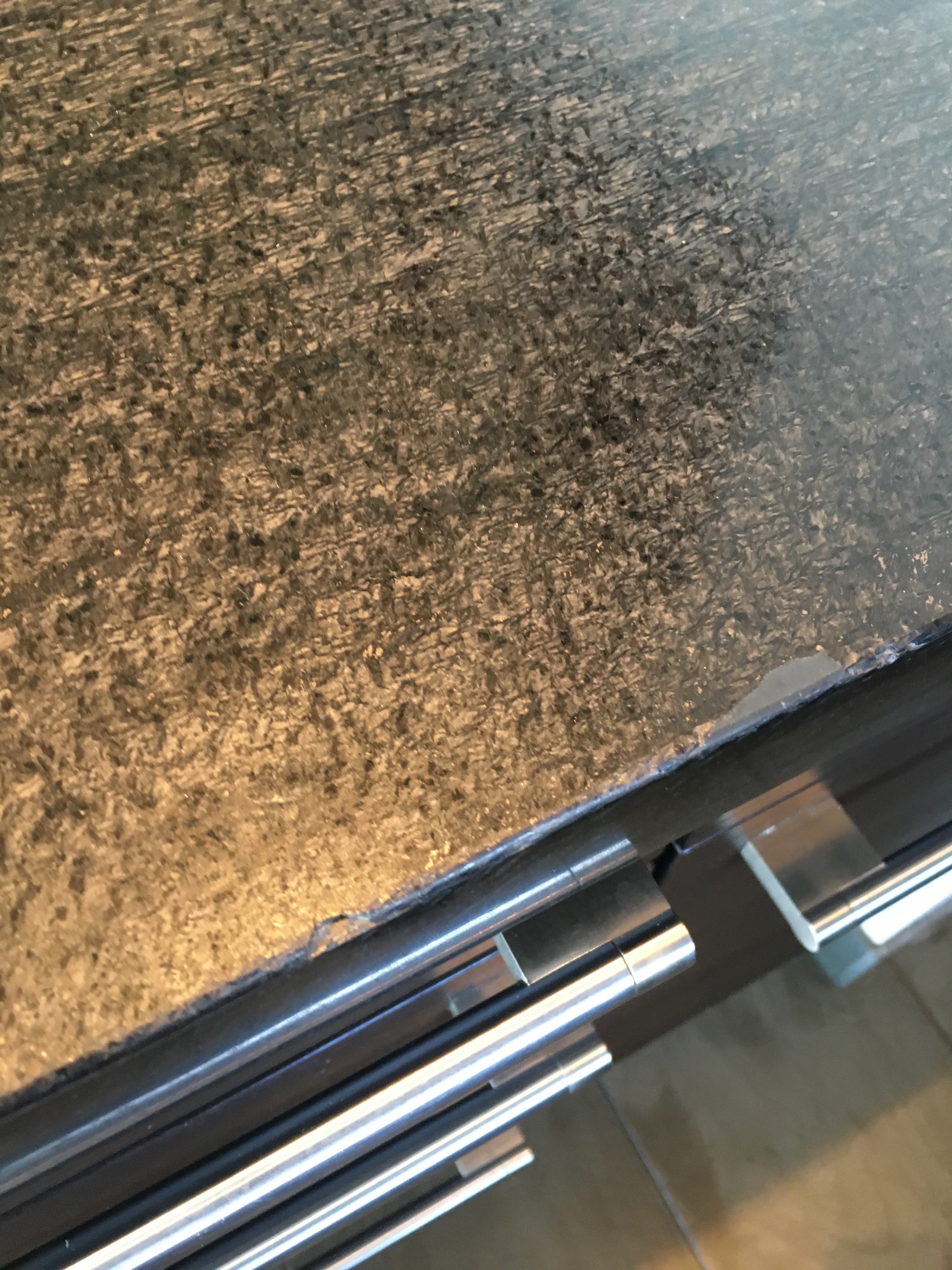

To spiff up her countertops. 39’ of schist, aged and somewhat flaked. This is to sell the house. So: Hone and polish, or just polish and hope it looks okay? I’ve done marble, but not schist and don’t know what to expect or how to price it. Also, there are chips on the edges. Suggestions, please.

well, doesnt appear to have any calcium in it, so can not compound polish like TML. likely need mb20?

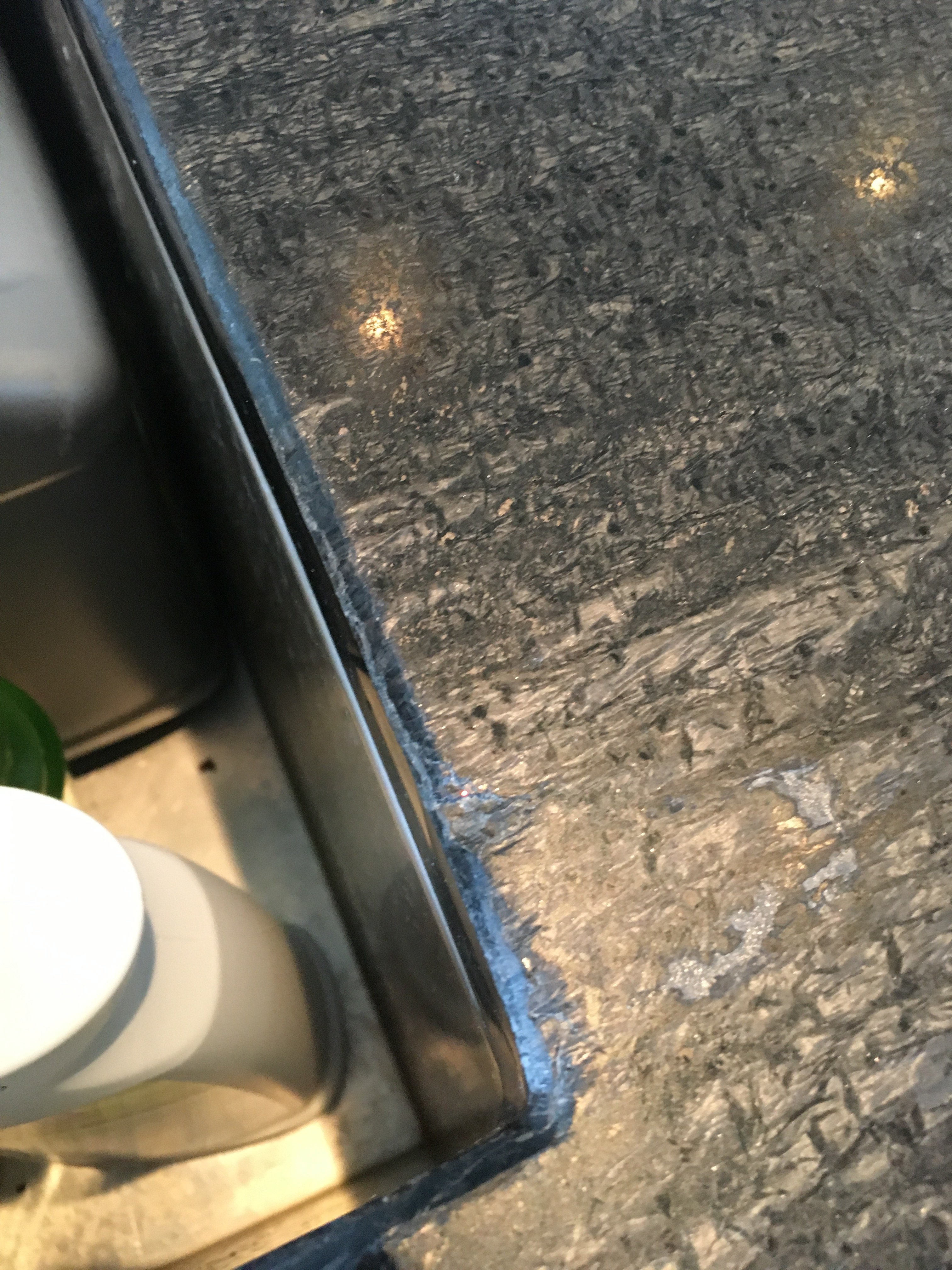

repairs, need to put a light on it to see how translucent it is. that will dictate repair material for best results. Repairs would have to coinside with honing so they can be flattened and smoothed. the bullnose repairs will be fun...
May want to provide test sample....

Carl the second picture above has an edge repair the installer made, it is an opaque grey. Looks like crap. Would Fill-a-Chip fix that and the one in the first picture (above)?

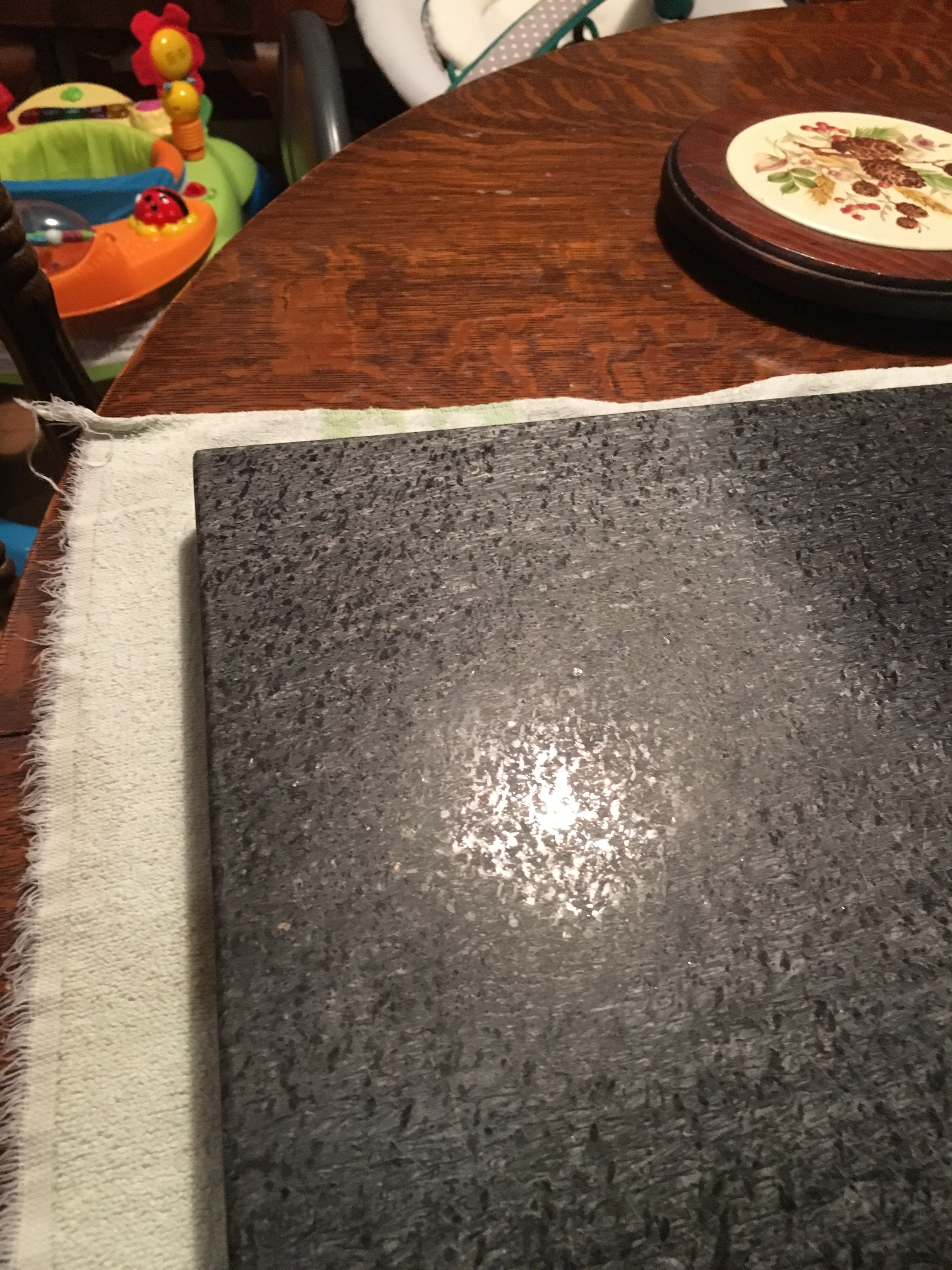

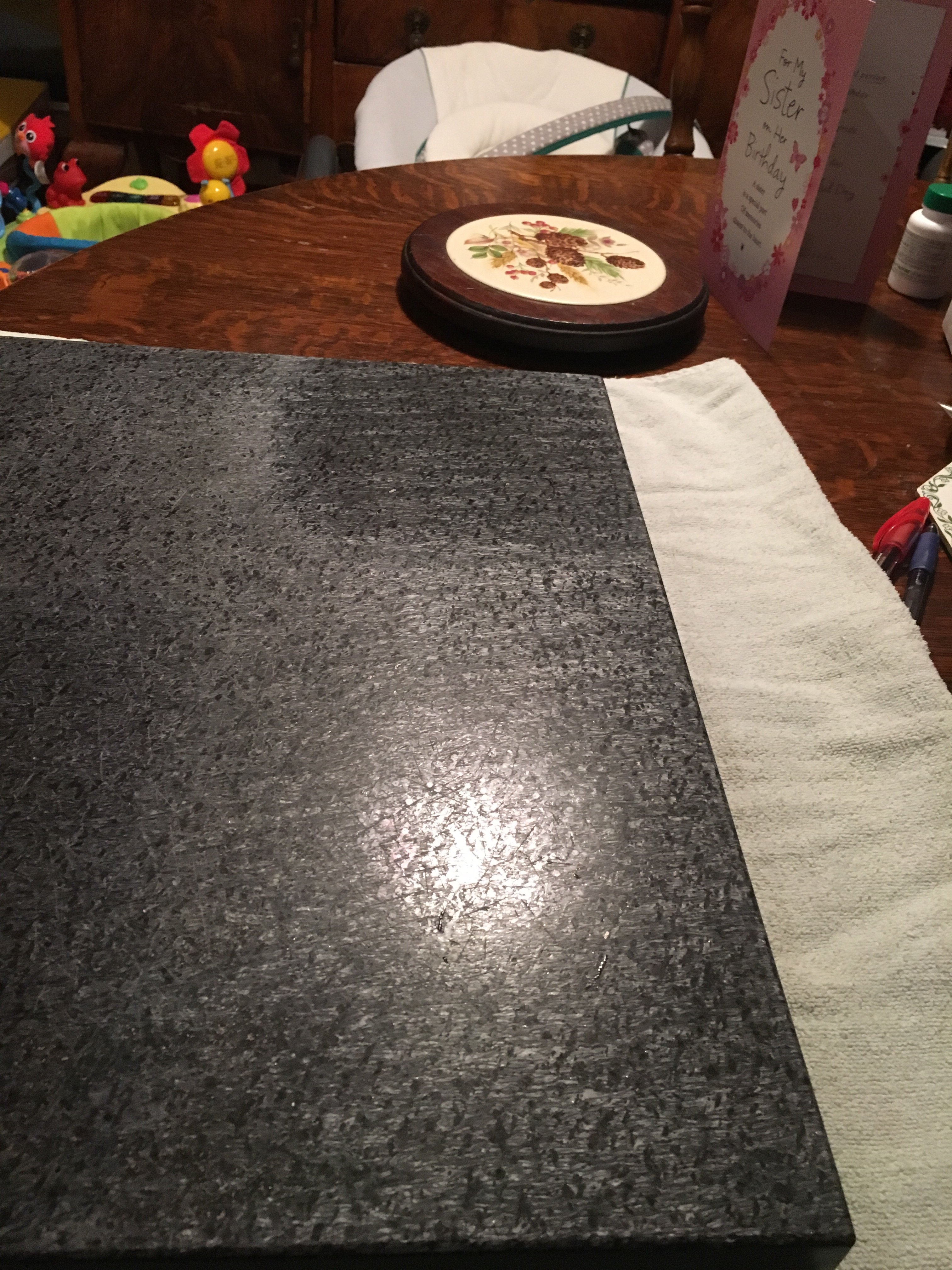

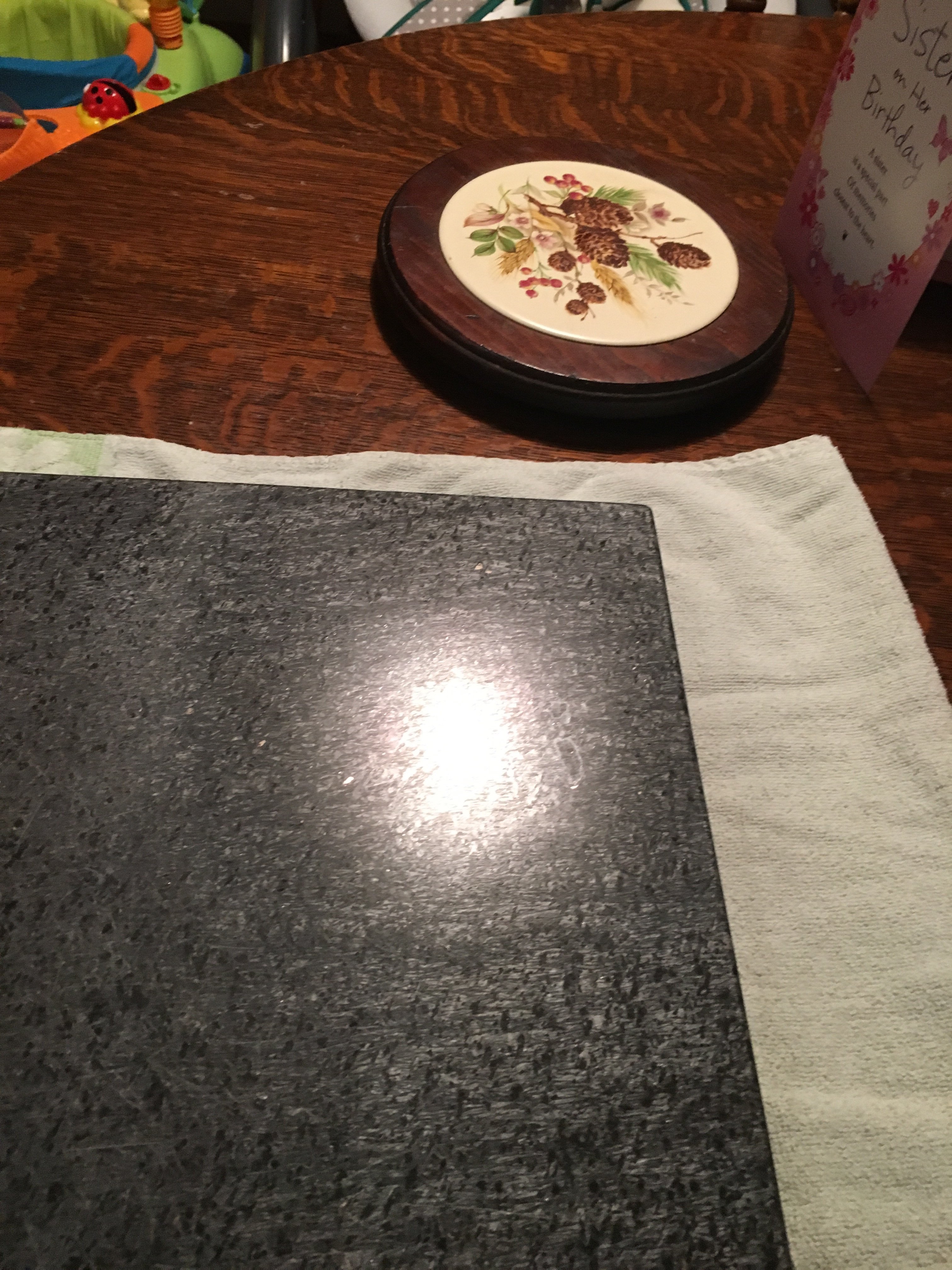

I think polish would add a bit of gloss, but the surface is lightly flaked all over. So I did a sample piece. Honing works best (of course), DIP leves a shine (but the surface is orange peel and scratches remain) and polishing doesn’t look enough better to be worth charging for.
1: Worn surface
2: Polish only
3: DIamond impregnated pads, orange peel surface
4: Honed surface

hey Stephen,
BTW, the diamond section looks good what did u end with?
how well did it cut? did you use marble or granite diamonds?
Its a counter, so worry about PFs, so you can go high as possible with diamonds.
do you have mb20? hard rock has something comperable to i think.
cant use traditional polishes for TML (trav, marble,limestone) on non calcite stone, dont do anything- any we found out
DIP suck for most work . although have there small space
To test traslucence, we carry strion led($100) and put straight doen on top. if is at all tranluscent, going to want to use glasier from bonestone. it is not easiest to work with . if not then use your fav poly and use multiple colors.

Carl, I just saw your post. I used marble pads on the schist to hone the sample, so it isn’t a bright result.
