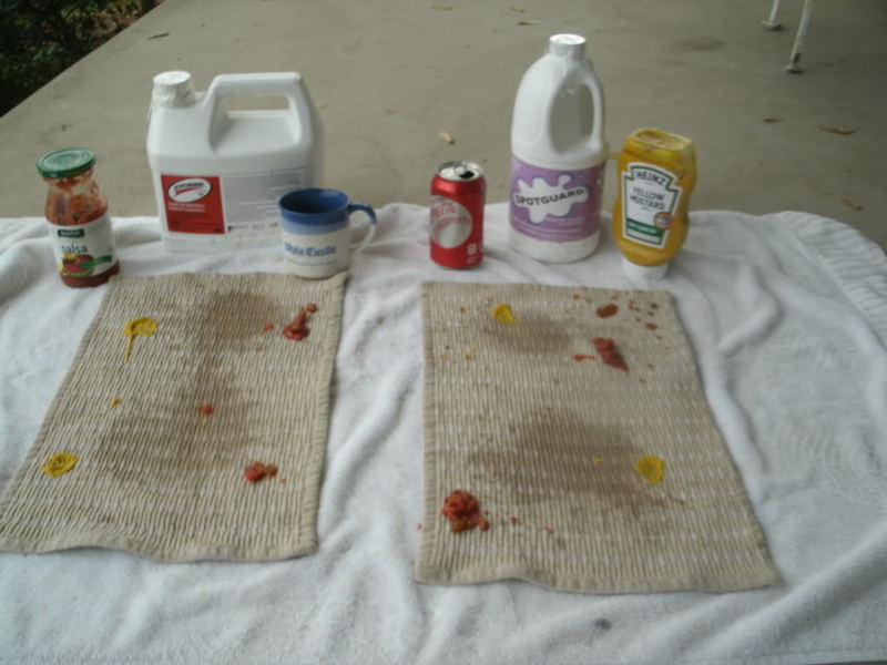

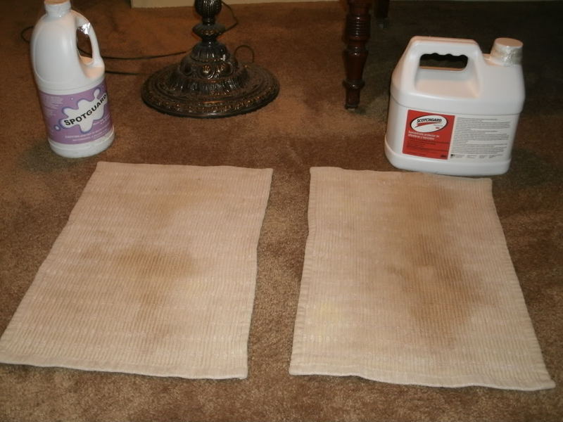

Hot coffee soaked in immediately on both.
Art Kelley
May 19, 2007
4,200
Coke beaded up on the Spotguard side and not the Scotchgard side, then I added salsa and mustard, a usual night in front of the tv watching American Idol.

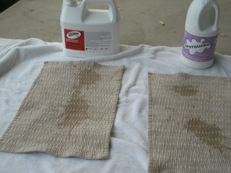

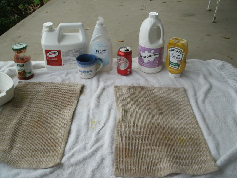

I cleaned it up as a custy would with a damp towel and some dishwater.
Everything came up but the coffee although the Magic Wand Spotgard side looked the best.

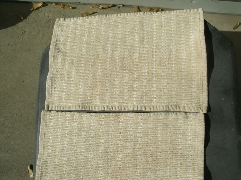

When dry:
Art Kelley
May 19, 2007
4,200
After I cleaned it everything came out. So the lesson is put down protector and make your money, but it won't do much but bead up for a while if you use Spotguard.
