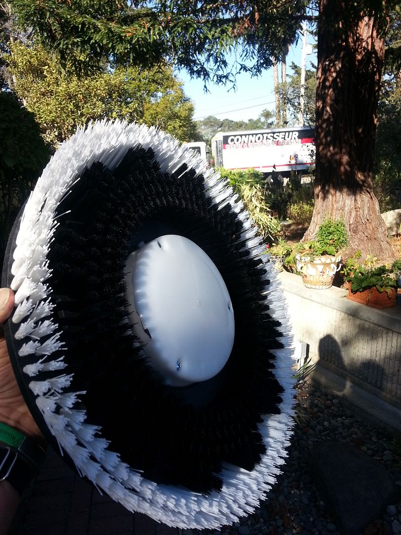

I use this brush on probably 95% of my jobs
http://www.cleanfreak.com/Qstore/p001094.htm
http://i1092.photobucket.com/albums/i415/vegun/20131004_092529_zpsd2ee87f9.jpg
One of my jobs today was a nasty one. I pre-sprayed with Flex with Citrus and scrubbed with the brush. Normally it is all I need to do to make it ready to clean. But today the brush wasn't doing it, so I for the first time broke out the red pad.
Man!!! It was like I was using a dirt erasure. So totally made a HUGE difference over the brush!
My question is this...Do I need to use caution with the red pad? I'm wondering about friction/heat if the carpet happens to be olefin. I don't think it would be a problem but I'd rather learn from your mistakes than make them on my own! :winky:
Any other thing I should know about using a red pad to pre-scrub carpet?
thanks in advance for your advice!
