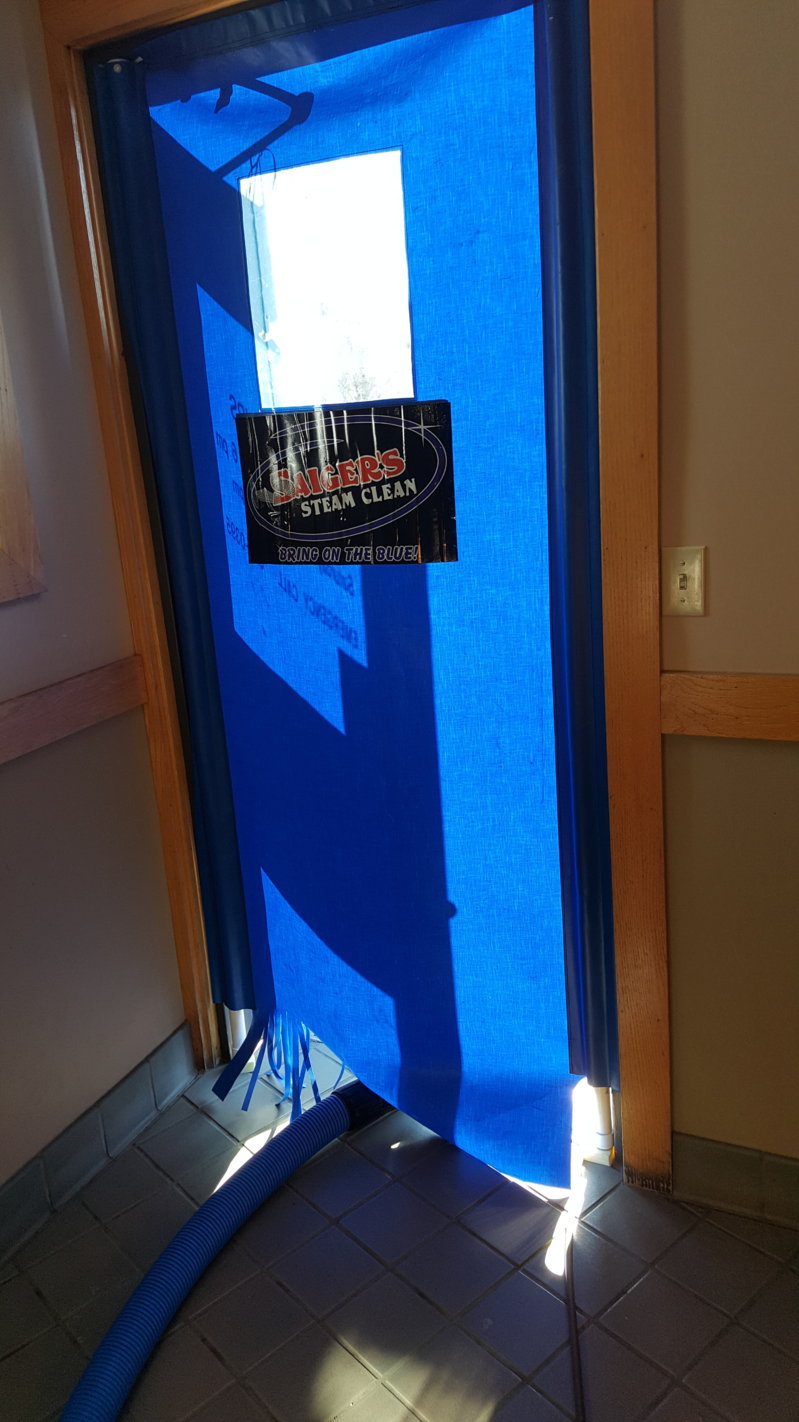

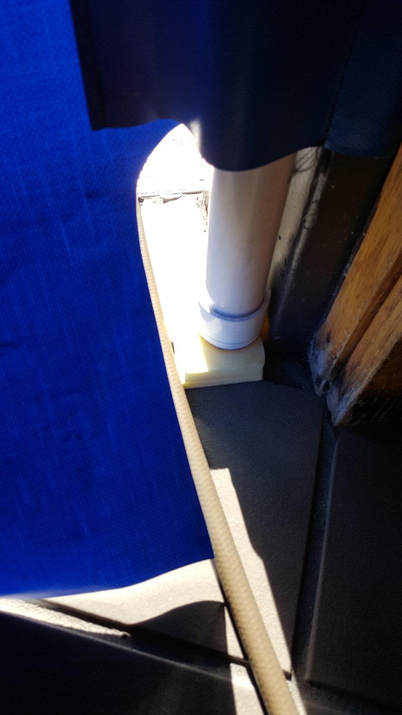

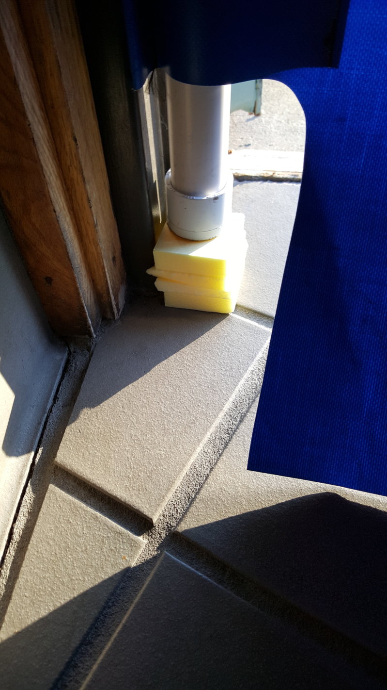

Extension pole trick for Seal-A-Door on taller doors especially commercial doors
I ended up putting 2 under each pole on this one due to the wind conditions

I am going to try this on my next windy day. The wind was blowing directly into the Seal A Door and it didnt want to stay put.

Another option, Tim, is place the upper part of the frame on the outside edge of the jamb....therefore, the jamb will help block it from sliding inward, if that's an issue. Otherwise, for just increasing the pressure, the blocks are a GREAT idea!
