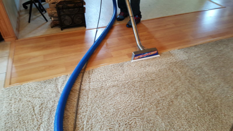

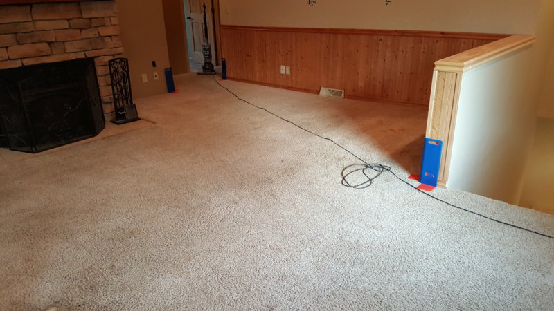

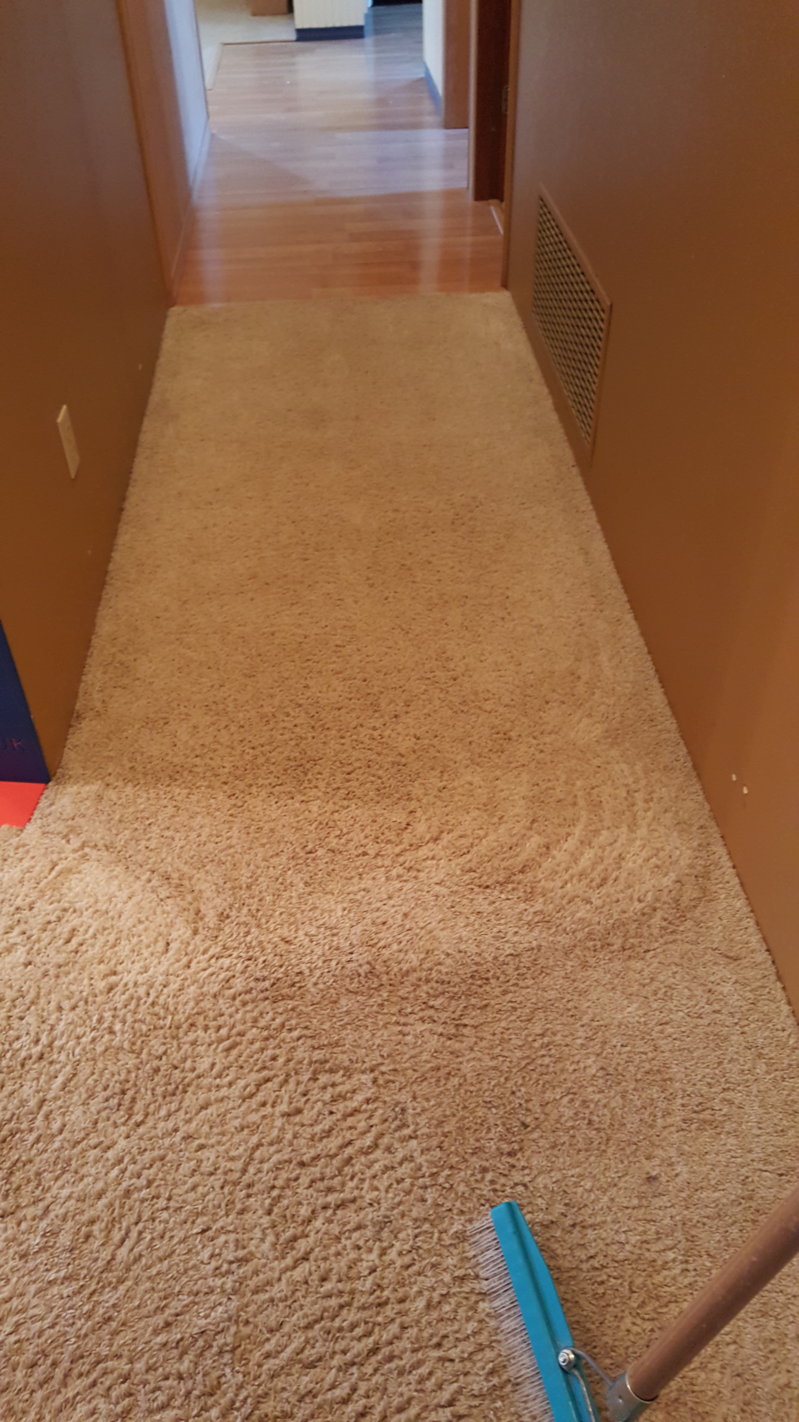

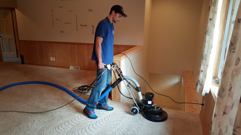

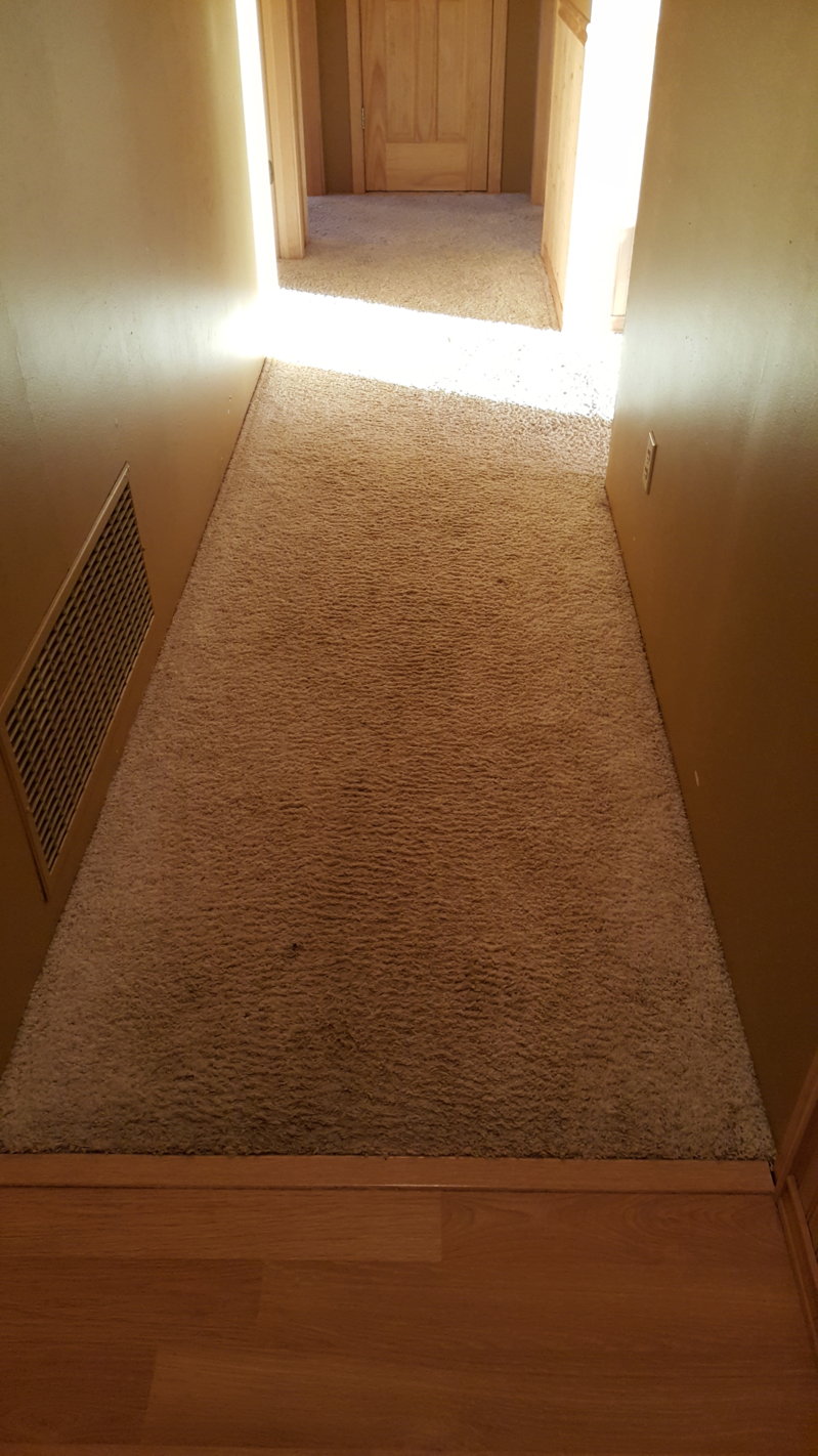

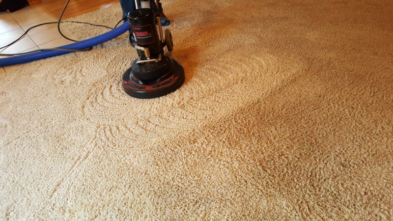

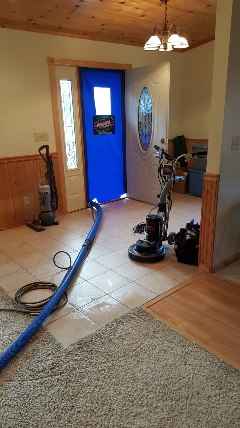

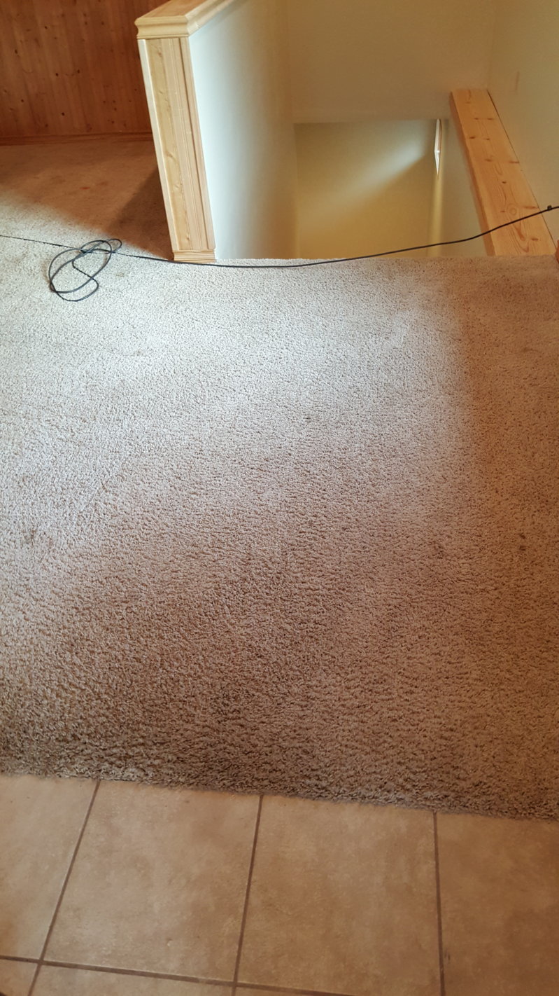

Had a few inquiries about streaking and swirls with RE's.
You don't need a dial to adjust speed on a unit...you just need to adjust your speed and how fast you move the unit side to side....or forward backwards....
Just put up this video today thinking about this.
On this carpet, we were able to proceed sometimes at a good clip, and then at times had to slow down....
We have had no issues grooming out Swirls....
Oh.... @Scott S. ...a little mention for you in the video :)

Nice video thanks. Mark do you like the rake more than the brush?
Reactions: Mark Saiger
11,200
We carry a brush type groomer and also the rake....
I find we use the rake a lot on this type of carpets vs the broom type....but we do have both so we can still make them stand up, groom out our marks and make them look as purty as possible :)

I really think that our reputation is due to using RE on many residential carpets. Unmats traffic lanes (like in Mark's video) like no wand possibly can. Don't know what we'd do without our RX's. Even the great Zipper can't accomplish what RE's can. But you'll have to kill me to get my Zipper.
