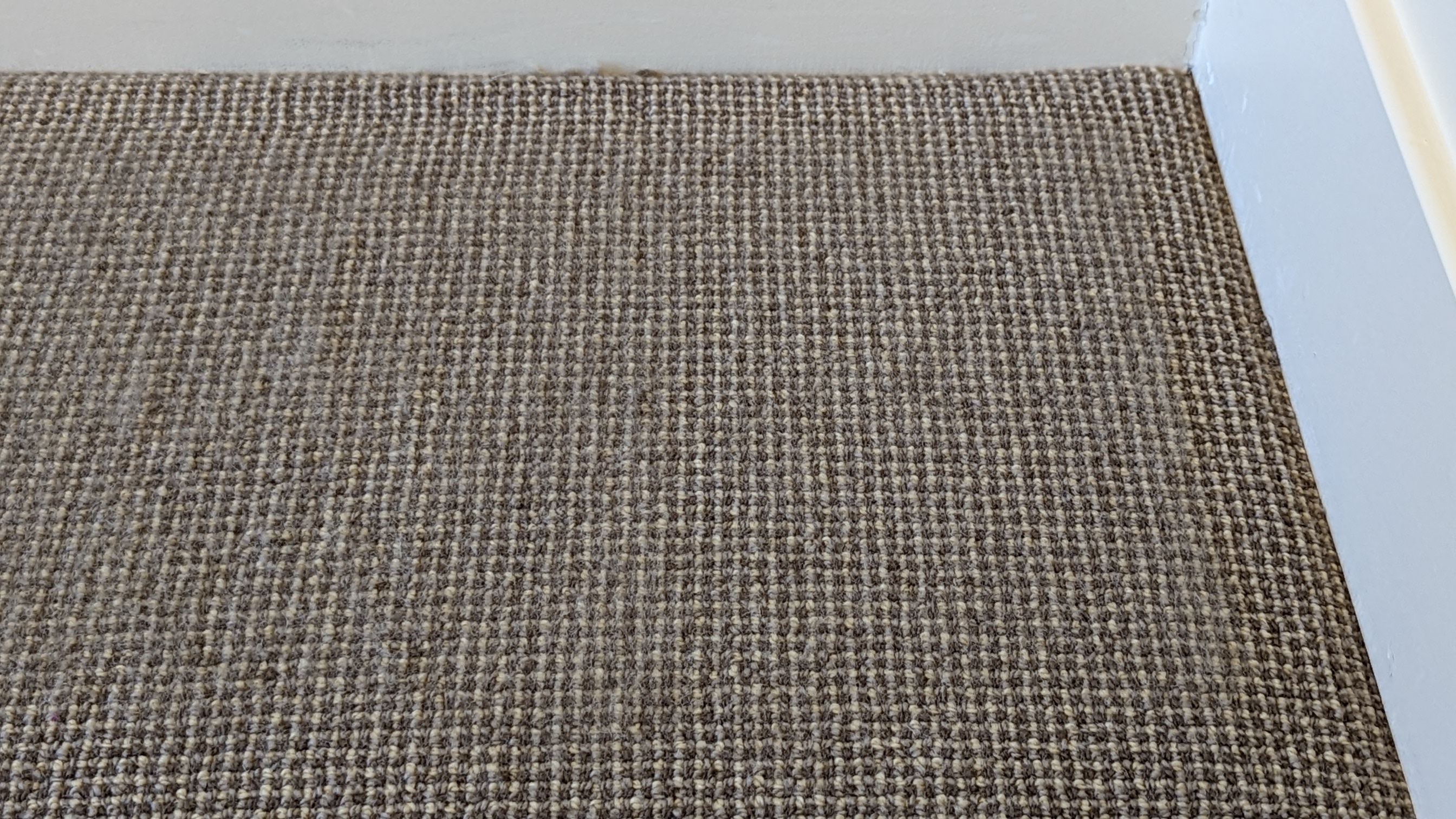

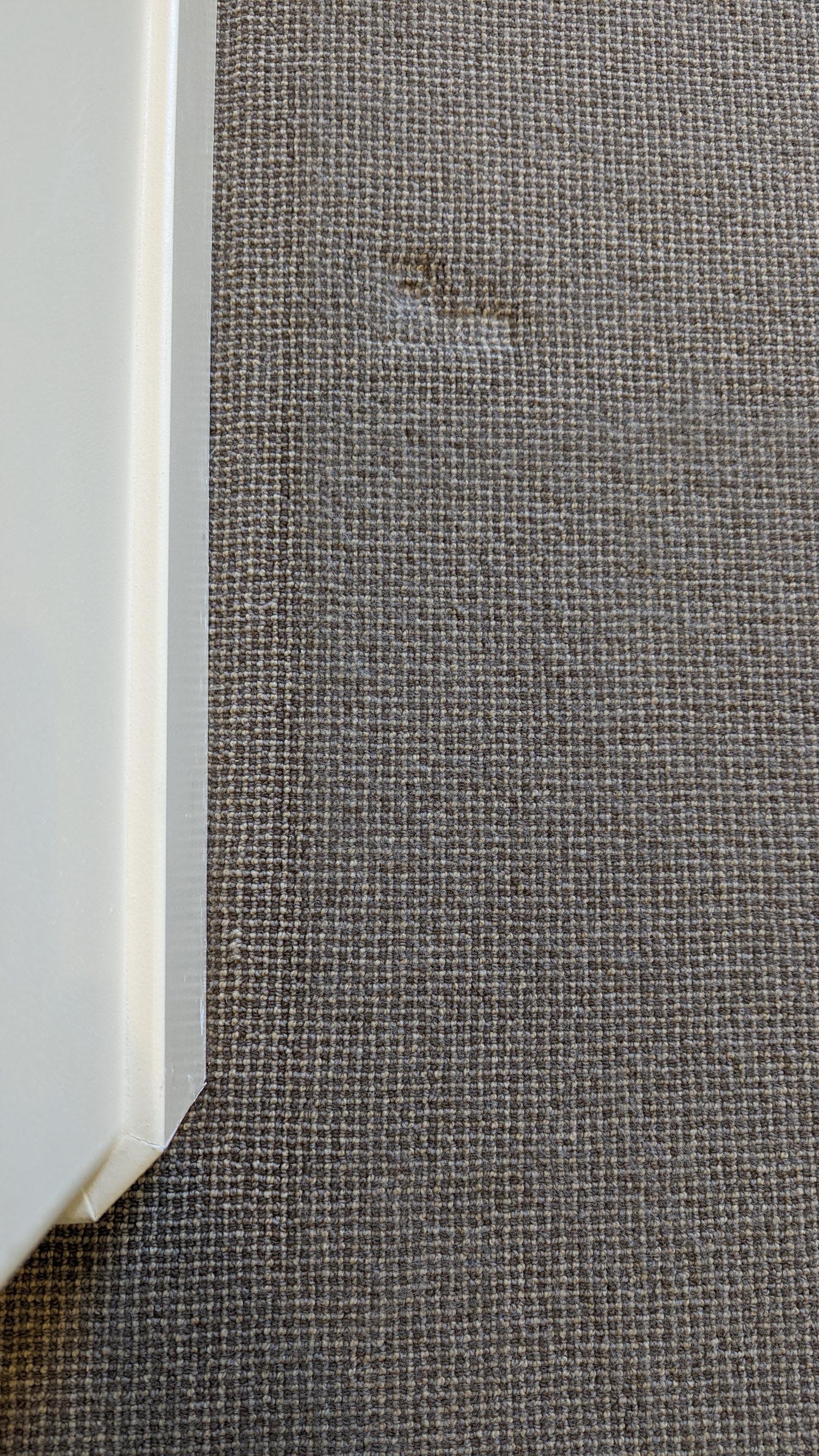

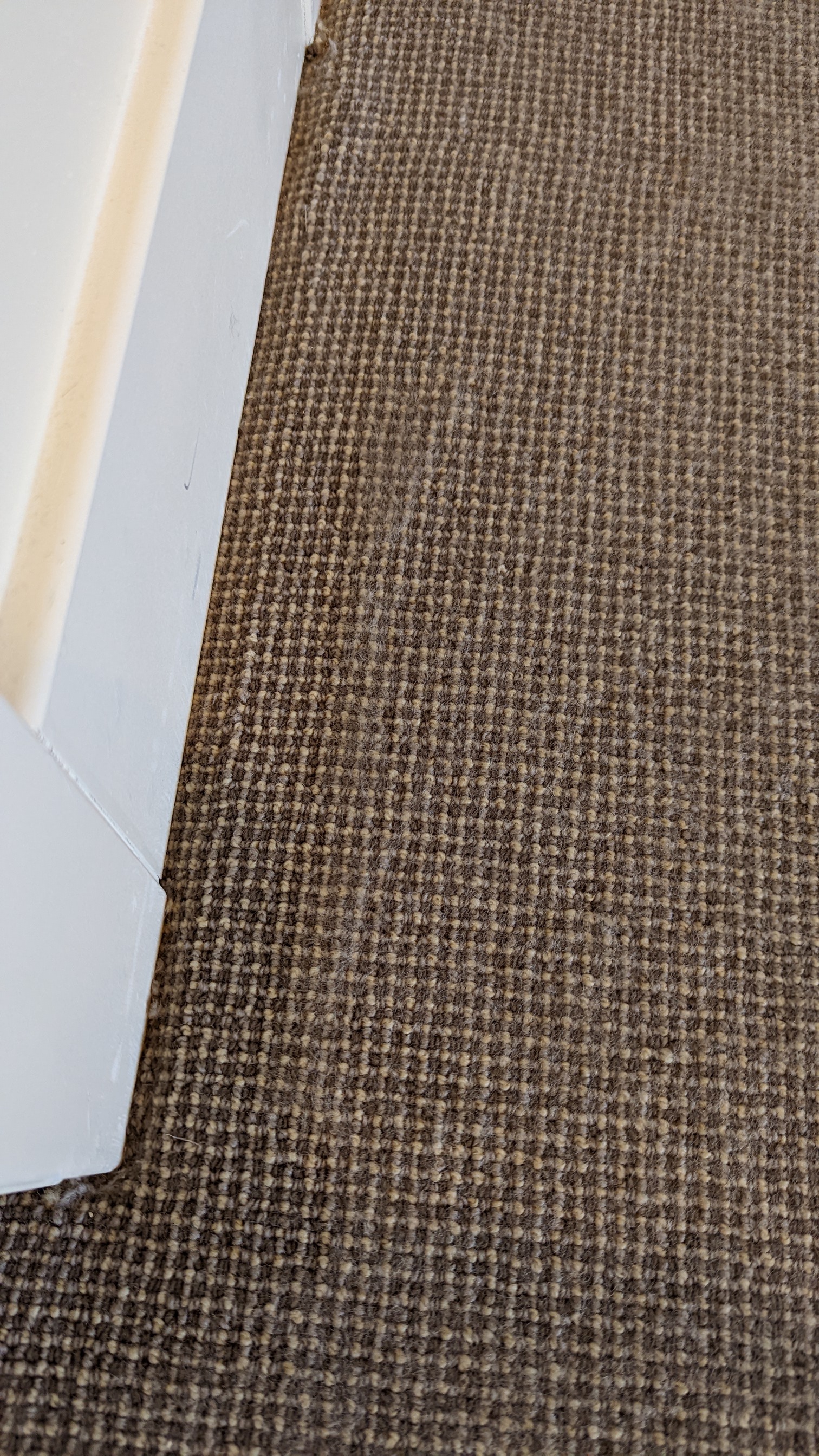

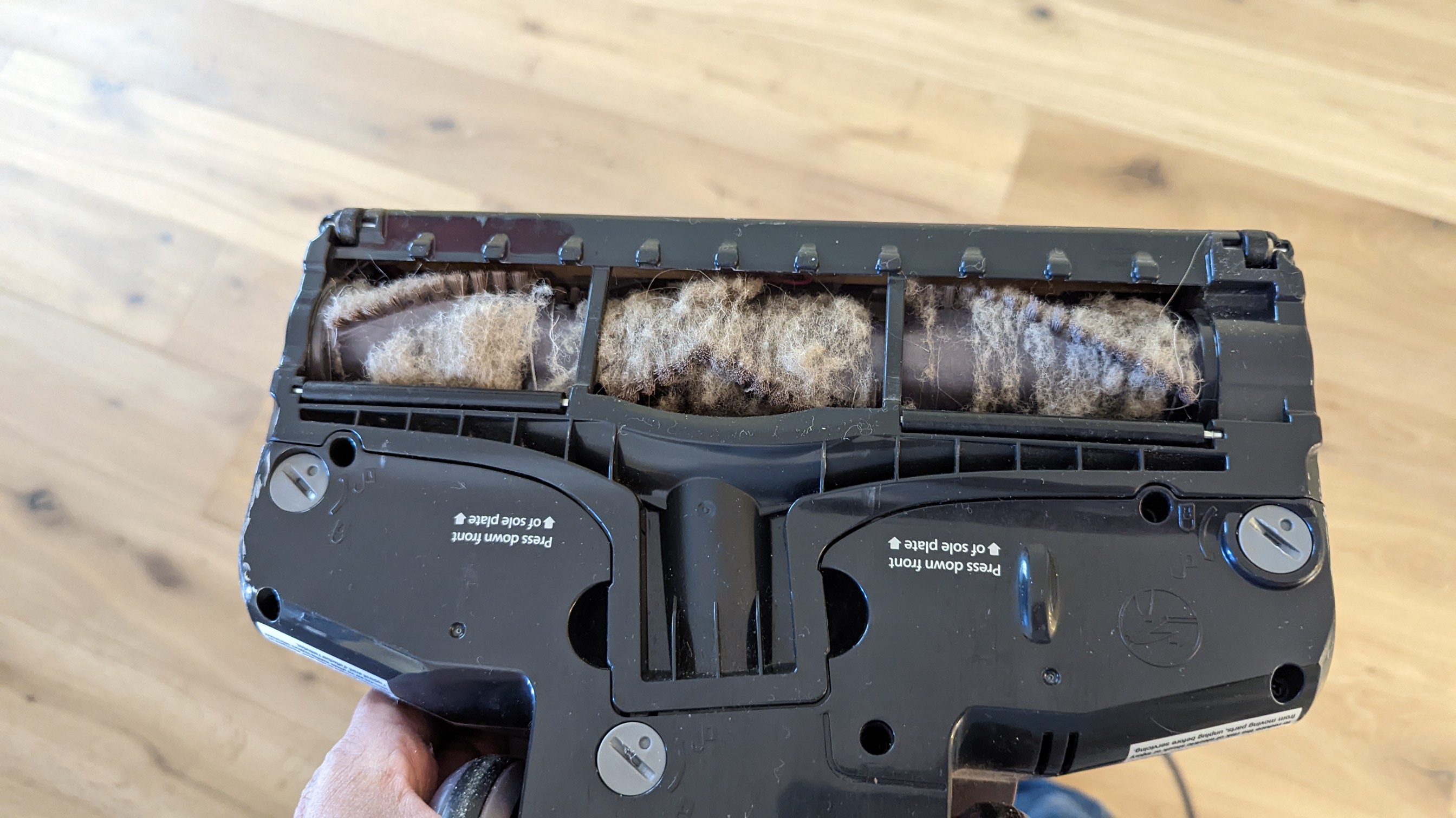

Look close along the edge and you'll see what the undisturbed pile is supposed to look like.. PXL_20221010_172010879.jpgPXL_20221010_172046266.jpgPXL_20221010_172054526.jpgPXL_20221010_172211301.jpg

Lot of loose threads on that vacuum. Any vacuum will do that. The question is why are there loose ends on the carpet that the vacuum can snag?

Shearing machine and a hand buzzer, just like new.. Surprising to see wool in a rental.. Down under see’s wool waaaaayyyy more than state side..
We’ve seen salesman tell consumers that a Shark, dyson, etc is safe for wool.. You’d think people would stop after a few passes.. Nah, do the whole house first.. Then complain later about fuzzing..
