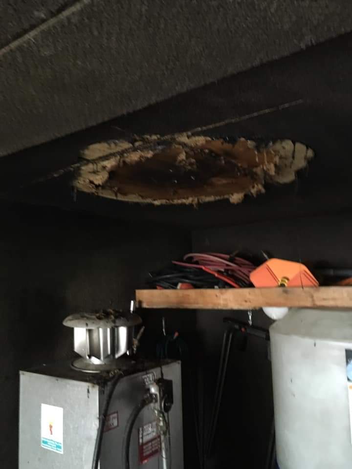

Waldo's POS LG nearly killed him yesterday.

in the pic it looks like that LG is deep in the van up against the side with a wooden shelf right above it. doesnt seem too smart to me but its hard to tell from the pic.
They should be near the door with plenty of breathing room. I think they are just as safe as any propane stoves or heaters in any RV but just like an RV cant be a dumbass about it.
cant have trash and cardboard boxes all over a rat nest van.
that being said I had an accident with one about 8 years ago but it was my own fault... we were still using bbq tanks and I tried to put an inline fuel gauge on the tank. big mistake lol
I still use BBQ tanks. When I know the fuel is low, I carry a spare. When working the spare sits outside the van until needed. I know my systems and am comfortable with them but really should be using a belly tank with the regulator outside the van. I would not let an employee use my system.
