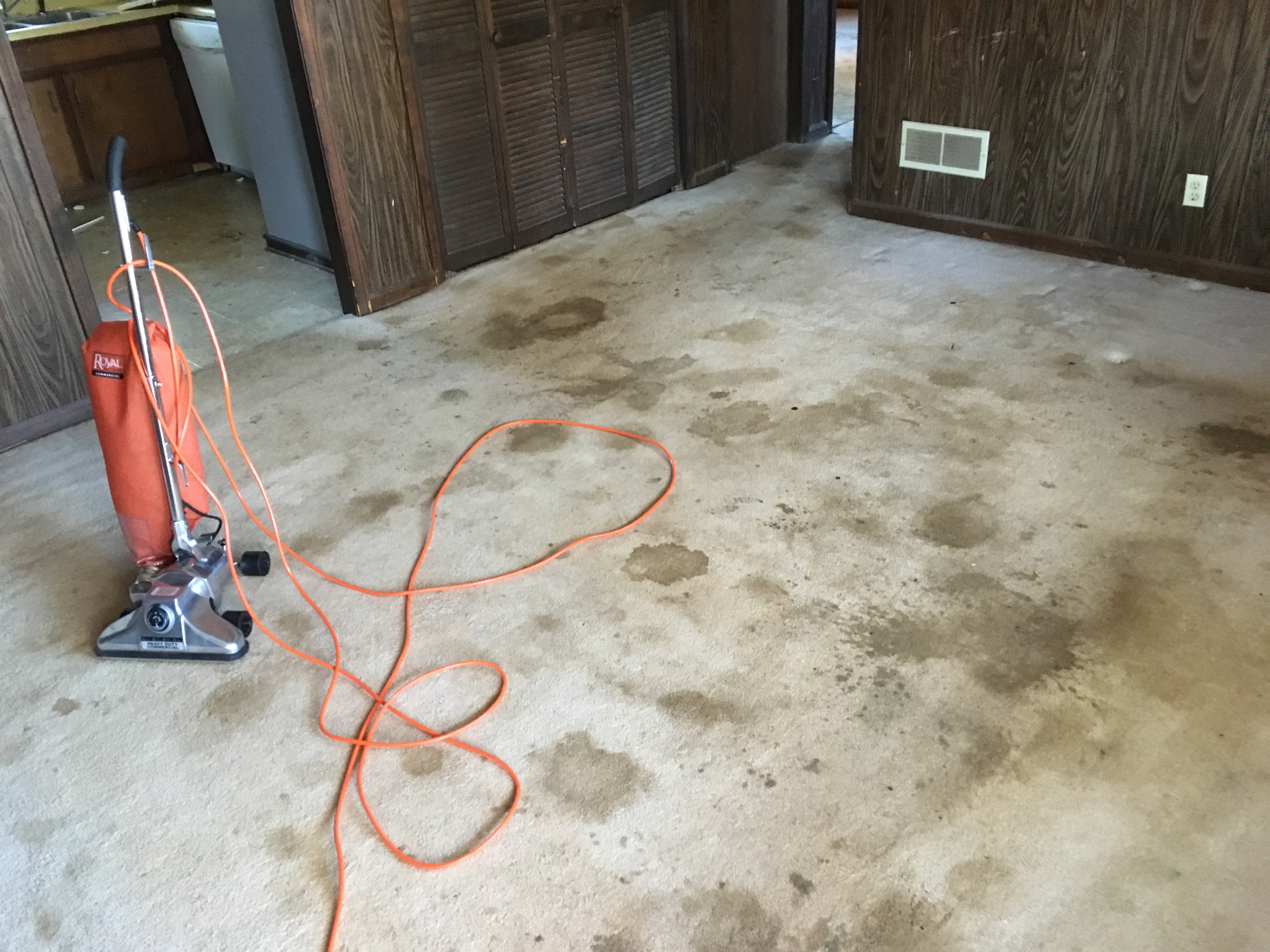

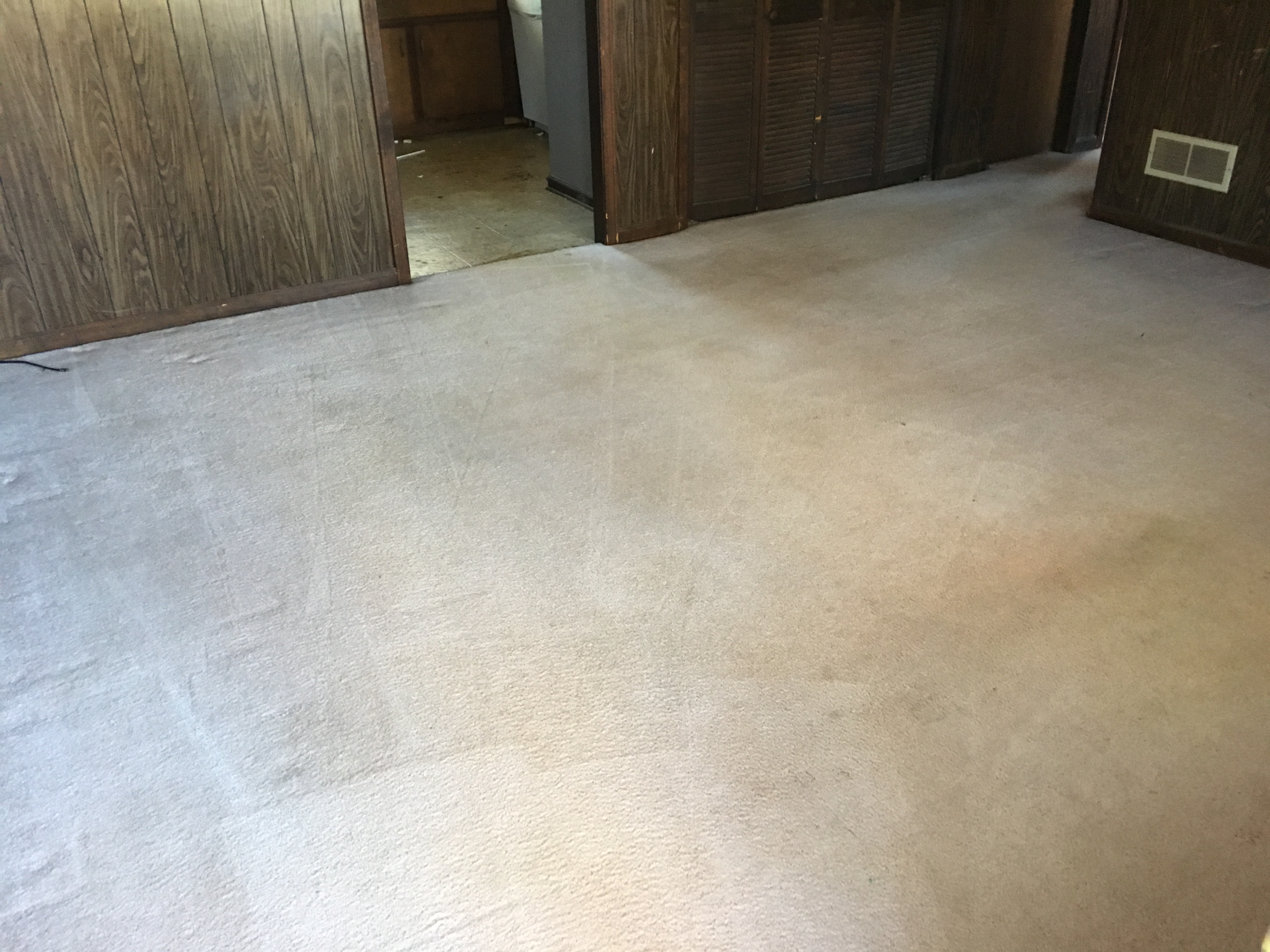

Conquered this one today. I don’t think it’d target the crowd I want to target, so I figured I’d leave it off of Facebook.
14,081
Georgia
I know there's still heavy yellow staining left over on that. But for a rental, I was done after my process of vacuuming, spraying with acid on piss, rinsing it out, spraying my normal stuff, crb like crazy, HWE.

I would've walked out..
No need to walk out when you charge double. I've cleaned this several times over the last 10years from the same property manager. So why should I walk if they have always given me business and not complained when I tell him, "it's gonna be twice the norm$$$". ?

you need a 360BH.
Would the 360bh have made it look better or got the job done faster? Because I don't see it going any faster than my 15" wand, and the crb took so much crap out.
And for some of you who would've used a 175 on this with a brush or pad...I've never seen my 175 with a brush pull up more hair balls like a cat than my crb has pulled up. On this job, I think it would've still looked like crap if I didn't use the crb.
I don't see the 360bh doing much more than what a 175 and wand could do. It seems that the benefit would just be saving time if you don't want to use a crb

One day jr. you'll learn... :lol:
It's like going from a trailer to a box truck....:stir: You just don't understand it until you try it... I agree the crb pulls a lot of crap out, but the RE tools will always pull more sh!t out than a wand would....! And that's a fact!:winky:

When my shoulder starts acting up more, I’ll open the wallet for one. Until then,
FB7777
360bh and you won't look back
Don't pay sticker price either ... at least 15% retail
Or call Rotovac direct and ask for an "open box" special
You'll get a great deal and it will be new
