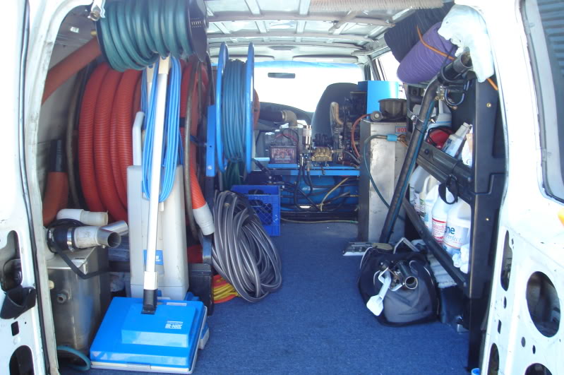

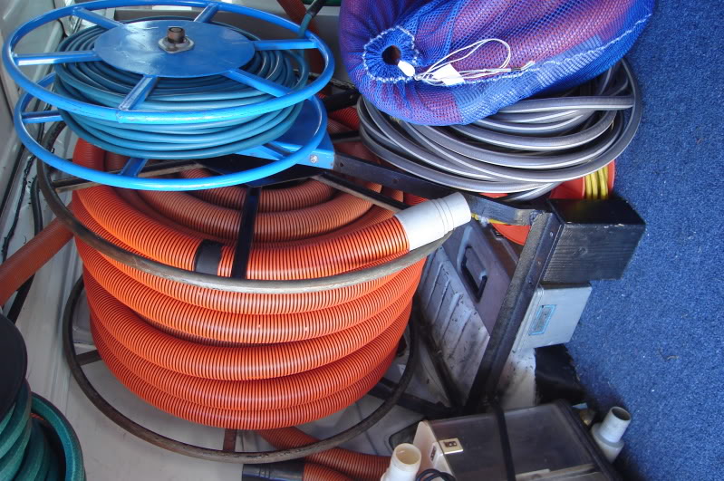

I'll start with mines. I installed and layed it out myself. Well, with the help of a forklift the machanic's next door let me borrow and a friend holding the wrench on the bottom of the van. :wink: My first TM install. I'm always looking to improve my setup.
Floor bed lined (rolled on) $50.00
3/4" plywood for the floor $70.00
Left over outdoor carpet from a job $free
Prochem TM including items below $1250.00
(Hose reel
Vac hose 400ft
Waste tank
Solution lines 400ft
2 chitty aw29 wands
Swivel stair wand
Dri-eaz (amp hog) Air mover
Uncle Larry C. (aka Meat) 3gallon sprayer he loves but a cracked bottom (I had a new bottom on the shelf)
1 Hydroforce
Sandia little 3gallon spotter
Prochem Cheyenne portable with a cracked solution tank (useless)
A whole bunch of chemicals that I trashed.
Alot of other misc. small stuff)
Little Giant 3HT $ had for 15+years
Filter box $ had for 15+ years
Solution reel, Prochem stair tool and upholstery tool $ free from a friend/cleaner who sold his business & moved away
Fuel tap $50.00
Copper hard line for gas-TM $5.00
Mytee shelves I won from MB auction that (Mytee John) picked up the shipping on $235.00
Foot Valve for waste tank relief $50.00
1997 Ford E250 135,000 $240.00 from a mchanic that owed me some money
New radiator $200.00
3 new ignition coils $80.00 total for 3
Fresh water hose reel $120.00
Muffler for TM $150.00
$2,500 total to get everything up and running. First job I did more then paid for itself. :D

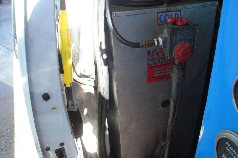

Prochem Eliminator made in 1999 or 2000, can't remember right now. Machine had only 1500 hours on it. It had a coolant hx and a engine exhaust hx but I removed both and just run the propane. The exhaust hx was no good from when I got it. I did think of running the coolant hx to preheat the water but was advised not to. I grew up using the LG3HT.
Propane for the main heat source. I did tweak with the thermostat alittle. Not sure on the temp it puts out, but it does turn into steam with only using a 25ft of hose to fill my prespray jug with the dial all the way up.
I did paint POR15 on the frame after having a friend weld in new metal to replace the rusted places.

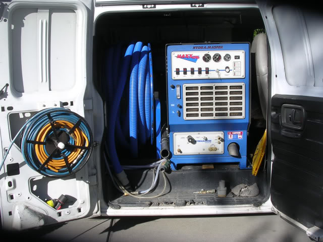

It is an AVENGER 210...same components...different configuration......
It is the same unit we gave Josh......
Hey, mines has 2hp more. And is watercooled. !dork!

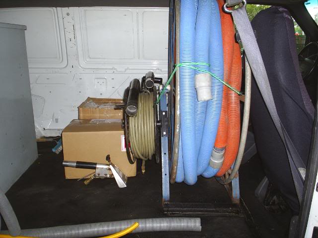

Reel on the side
To the right: rx, vac, fan, op, hydro, bucket of tools
Left: 60 g. tank, grout repair stuff, buckets
room easyly fit the brute or other 20" machine in middle

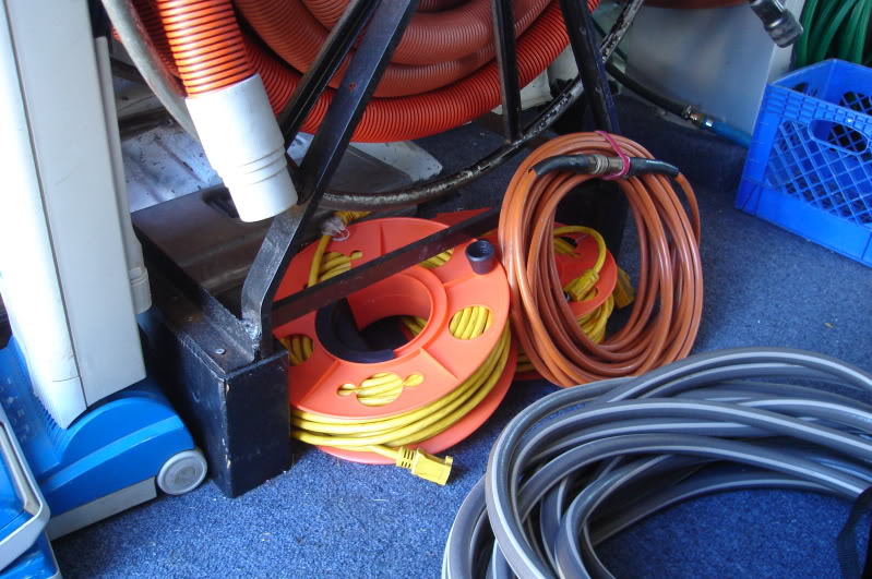

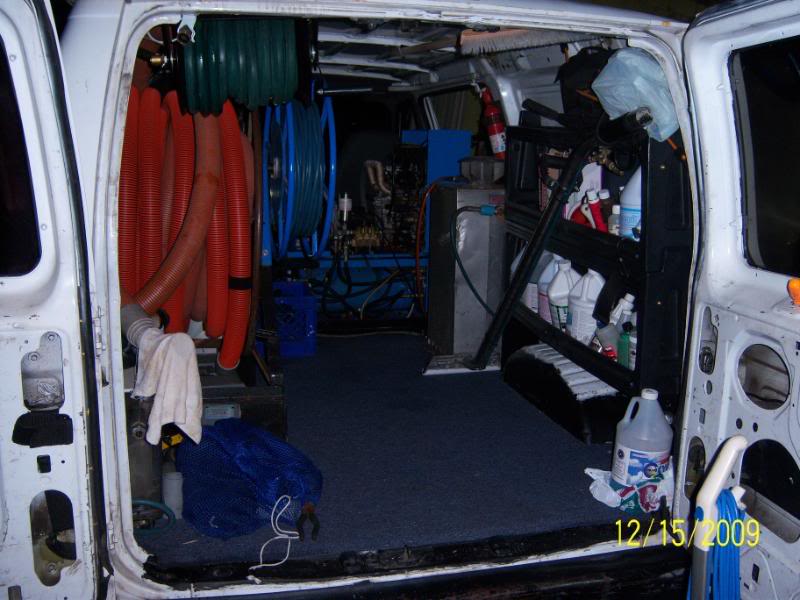

Updated with more pics. It's a learning process for me. I'm always open to trying different ideas.
Of course that's not all the tools I carry, but most is there. I don't have to drive far since I live on an island. Asking the right questions will determine the tools I need to take. My service area is no more then 35miles max, in any direction.
I see why the extended vans are more popular for cleaning rigs. Mines is a shorty.
