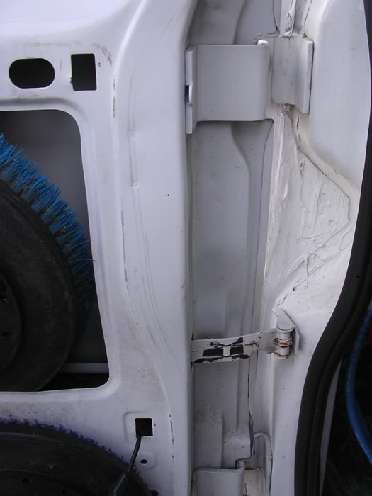

I have the reel on the side now and would love to be able to have the doors open more then the 90 degrees they seem to be designed to do.
Does anyone know of an aftermarket part that will allow to do this?.
Hinges are in the top and bottom. The piece that stops the door is in the middle.
I haven't looked at it closely but maybe it's adjustable??

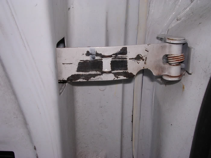

If that's like my old van, push on that thin piece of metal in the middle as you open the door and it will become unhooked and open all the way. I don't know exactly what van that is though.
Ricky Thurman
275
That middle piece.....pull it toward you as you are opening the door. (you must pull it before then door reaches about 1/4 open)
Fon Johnson
Oct 15, 2006
1,066
Yeah, that thing in the second picture is called the check strap. If you opend the door about half way, you can push the check strap in and then (while holding it) swing the door open all the way. It is to prevent the door from opening to far and damaging itself or the body. It does depend on the model though, as not all trucks had this feature. It makes me laugh to think about what they used to use on the rear of the old astro vans..

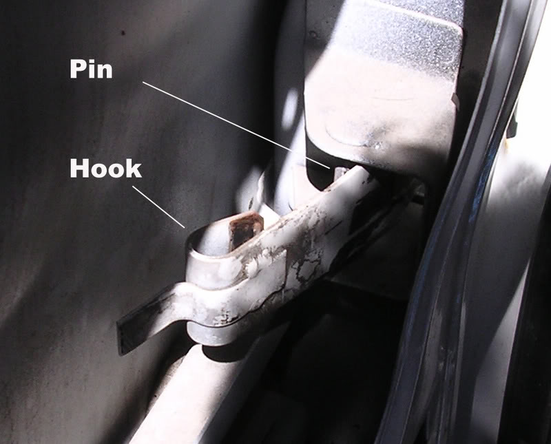

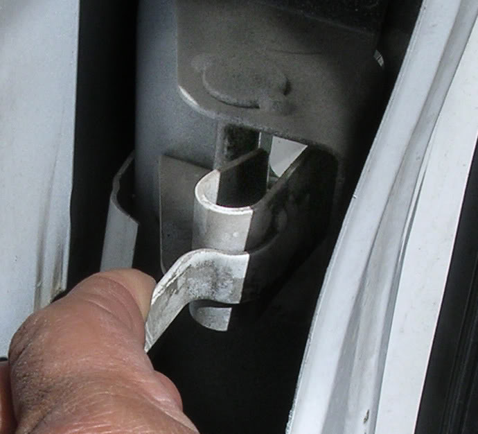

All your suggestions were right. Pull towards you almost immediately after opening door. It was late when I tried it and did'nt work, I waited too long to pull. I took the brush I had in the side to see how it works. No problem now. Just a simple hook system is all.
Here's another pic so someone else may have some reference at a later time
The strap as the door is opening
Passes the pin once pulled towards you.
