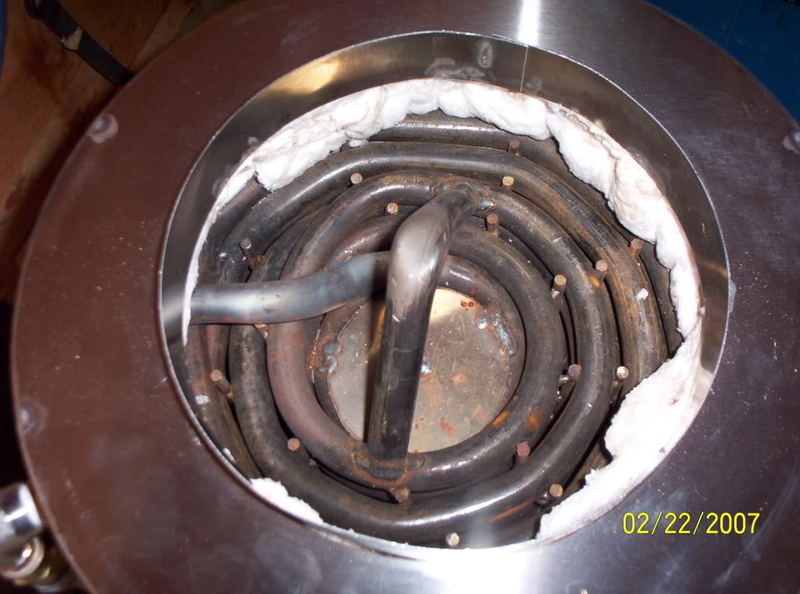

this is the top, it has that plate welded there cuz it can and does shoot some flame out the top..

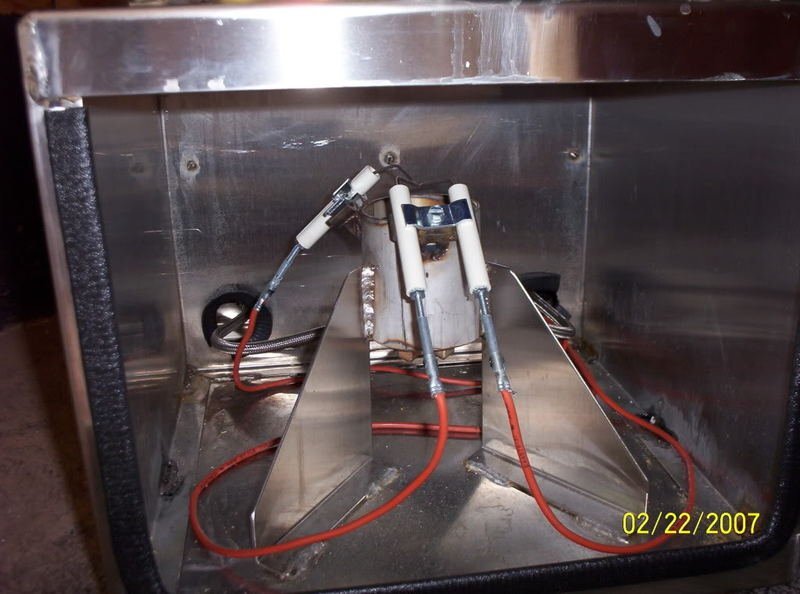

picture of the burner...unlike little giants with multiple little jets this has to larger in there 1 for 1st stage(180k BTU) 2nd for 2nd stage(360k BTU). it looks like a mini hot air balloon flame

That is a trip how the burner jet is single for lower and dual for higher, is the flame pattern pretty even across the coil, or do you kinda depend on the little center plate to "hold back" the tower of fire?

it appears to be fairly even, where i have it set while i was testing, i couldn't see in the back(wall)

it is schedule 80 black pipe, it'll take quiet some time to rust through...and yes YOU MUST PURGE before you clean..you could probably drain it after the days jobs and not have as much...
I think he told me 200' coiled in there..i don't remember that total number...i know when i first hooked it up, it took a little while to get flow out the other side. I think its either 3/8 or 1/2"
