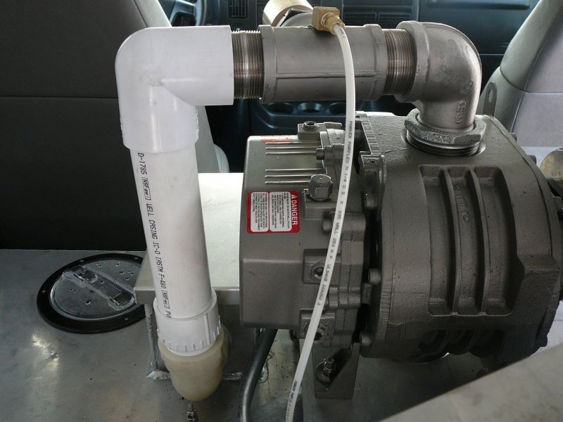

The Sutorbilt 4MR has a continuous limit of 16" of lift, due to separation of the lobes from the gearcase:
A brand new blower system on our newest Dynachem TM will operate a couple of in.hg. above that level.
Sadly, many TM manufacturers are regressing in maximum lift on their TM's.
Ditch the pvc, from a consumer perspective it looks less appealing. Even if it is a great unit.

@Larry Cobb , I don't know any better, but is there not much affect vacuum when the port is reduced down to 2" from 2.5?
27,863
You lose a ton of airflow (cfm) if you reduce from 2.5 to 2 inch. Whatever diameter your blower port is, you need to run that same size to your waste tank.

4MR Blowers have 2.5" FPT ports.
Significant restrictions in the blower system are, in order of importance:
1. Wand-Carpet Interface (minimized by cast or machined vac head)
2. Blower Silencer (minimized by straight-thru design & all stainless construction)
3. Vac Hose interior smoothness (minimized by SuperFlex laid out in straight line)
4. Vac Filter Design (minimized by larger mesh or quality inline filter)
Why the reducer going into the blower? ...and all the elbows.
Lift doesn't mean much if you aren't moving air efficiently.
