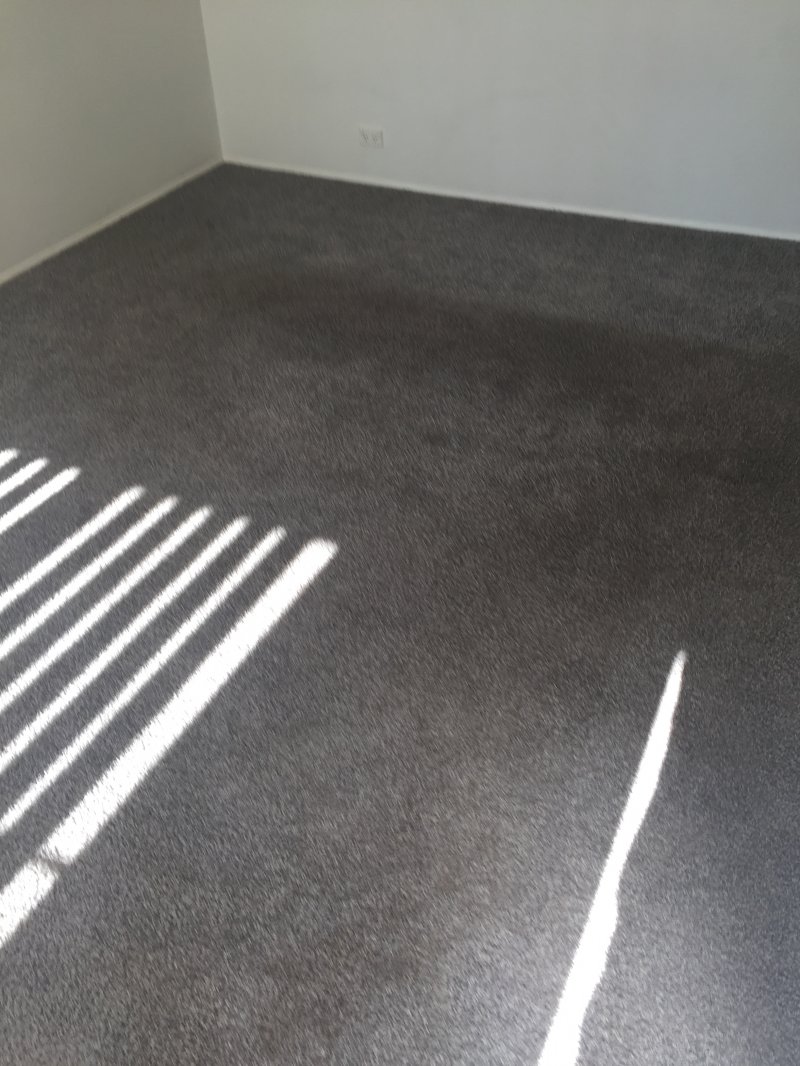

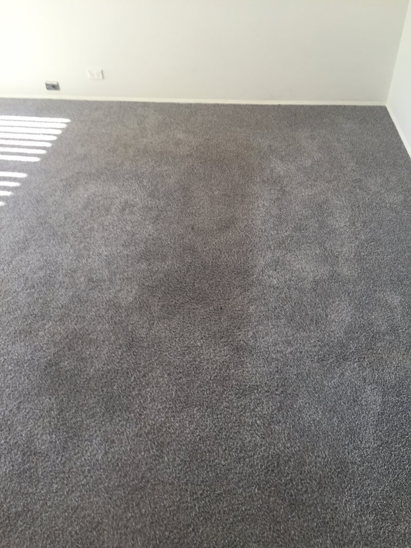

I've cleaned 5 SmartStrand carpets in the last week. One of these was a second visit on a vacated rental property. The traffic lane in front of what I assume was the lounge suite, is grey and ugly. Couldn't get it clean on first visit after multiple attempts. The retailer went out, and sprayed some water on it and scrubbed it with a white microfiber rag, and got some soil transfer and declared the carpet hadn't been cleaned properly. On the second visit I re-cleaned - vac, scrubbed pre-spray, steam cleaned. Photos show not one skerric of difference. I rang the supplier and tore shreds off him for his parlour tricks attempting to discredit my business, and his complete absence of education in the limitations of exhausting soil exhaustion through the HWE process.
I cleaned another one yesterday. I'm warning all customers about expectations before I start cleaning this rubbish. I'll post before and after of yesterday's SmartStrand below. What I'm observing on these carpets is extraordinary absorption of oily soils in trafficked areas or areas exposed to pet coats. Greying out in the traffic lanes accompanied with some matting and elongation of the pile. It is more subtle than with polyester, but certainly there.

Photo 1. Before.
Photo 2. After. A big improvement and lots of work to get it to that level, but certainly not acceptable in my opinion (although customer was happy with this).

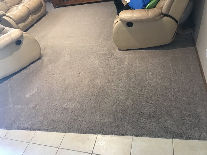

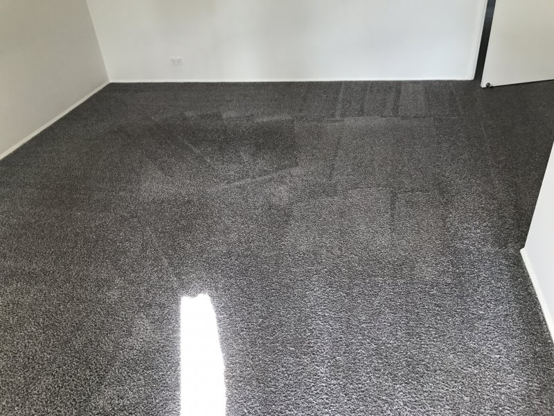

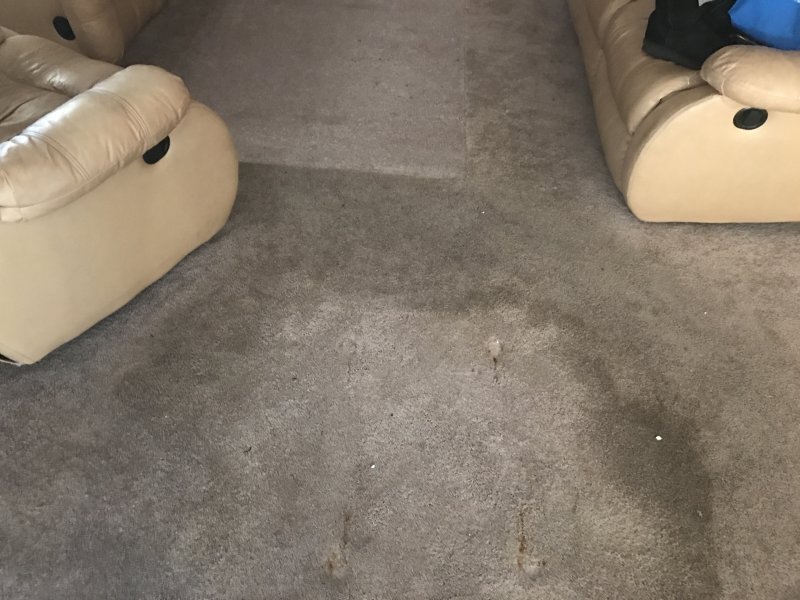

Ok. So the job where I've had to do a secondary visit early last week. The top two photos are from the first clean, immediately after cleaning.
The third and last photo is immediately after the second clean. There is essentially no improvement or difference in appearance less pile alignment from the wand. Both times was vacuumed, scrubbed and wanded.
