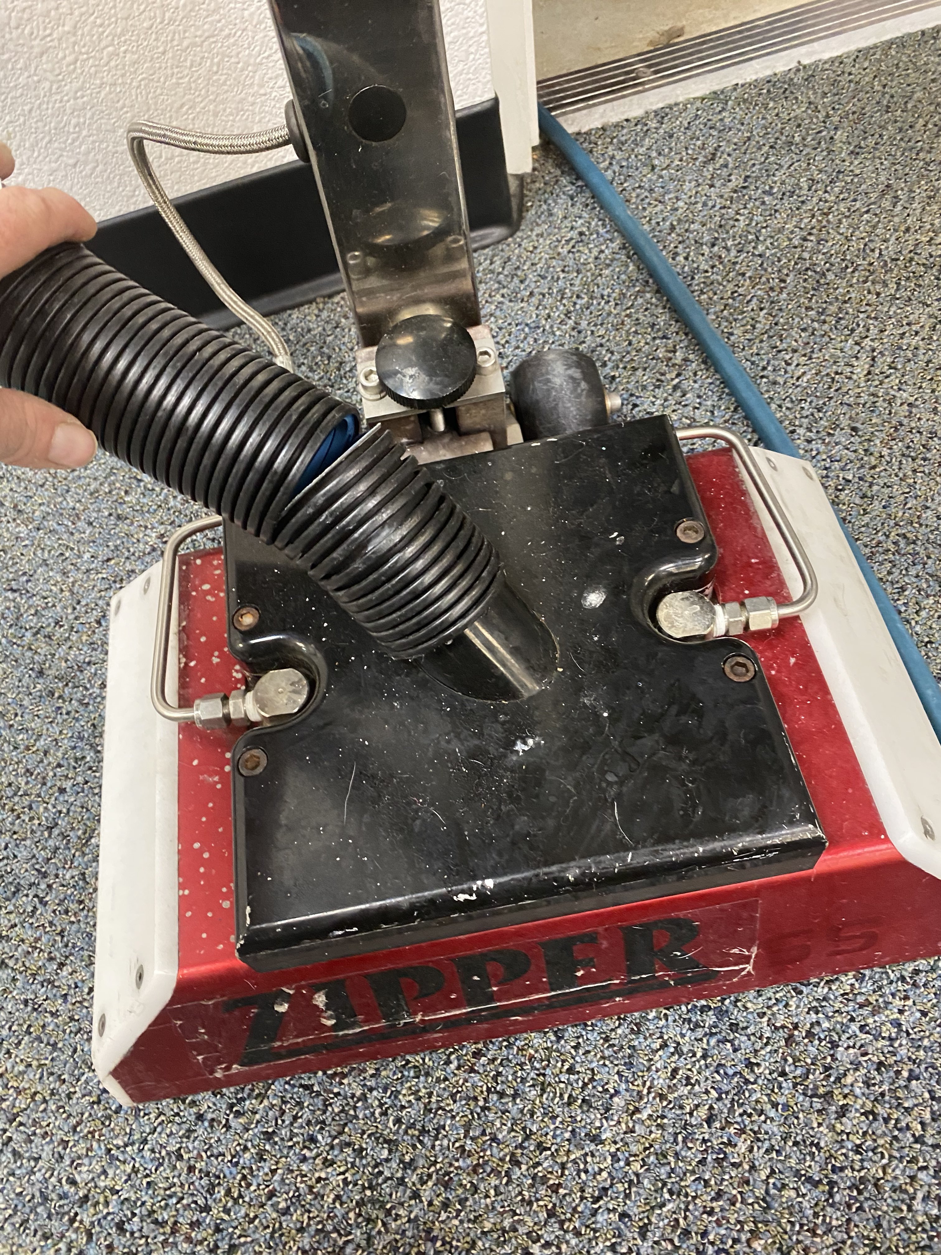

Cleaning a large office building tonight and my Zipper broke :(. I was cleaning at full on Ramming Speed and rammed it into a desk, causing the black vac hose to rip. I had to run out to my truck and finish the jobber with my 2” Dev wand. I’m so sad and depressed. What am I going to do? Who can I turn too? Will the sun rise tomorrow?
On a serious note, where do i get a replacement hose?

Same thing happened to me Thursday. My first thought was the tin snips I had in my hand before I left. I thought why the hell would I need these and set them on the bench. Cut it off at the break with needle nose.

Don't you know how to cut off that section of hose with a knife and shove it back on?
I fixed it. For some reason I thought it was some sort of special hose. All of the kisses from my dog must be effecting my mind.

blue lining means its lil better (amflex) I'm sure other distys carry it too under their own branding
