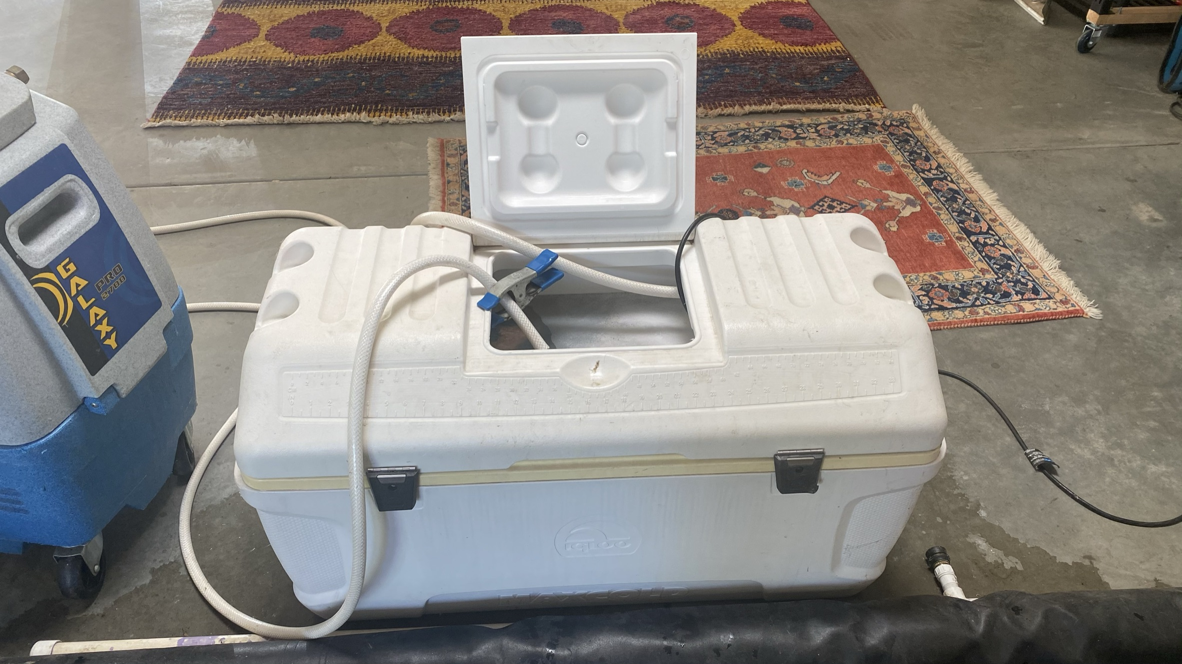

Anyway, I have a bunch of rugs in the shop and they are all urine soaked. Not sure how I'll do the bigger rugs but for now I'm using a large cooler to soak the smaller rugs in Rug Restorer for 8 hours. Inside the cooler I installed a submersible pump to recirculate the water. I need to do what @Joe Appleby does and make some large tanks out of some pipes. Joe, Any chance you can send me some pics of your soaking tanks and maybe let me know where you got those large pipes? I thought I took some pics when I was in your shop for @Jim Pemberton's class but I can't seem to find them. My cell is 530-355-3363. It would be much appreciated.

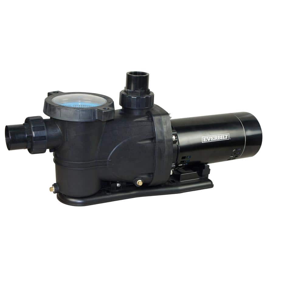

This is what i used as my Rug Jacuzzi.
Your friend has shared a link to a Home Depot product they think you would be interested in seeing:
Everbilt 1.5 HP 230-Volt/115-Volt Pool Pump
SKU# 308300265
I made jets with PVC pipe.

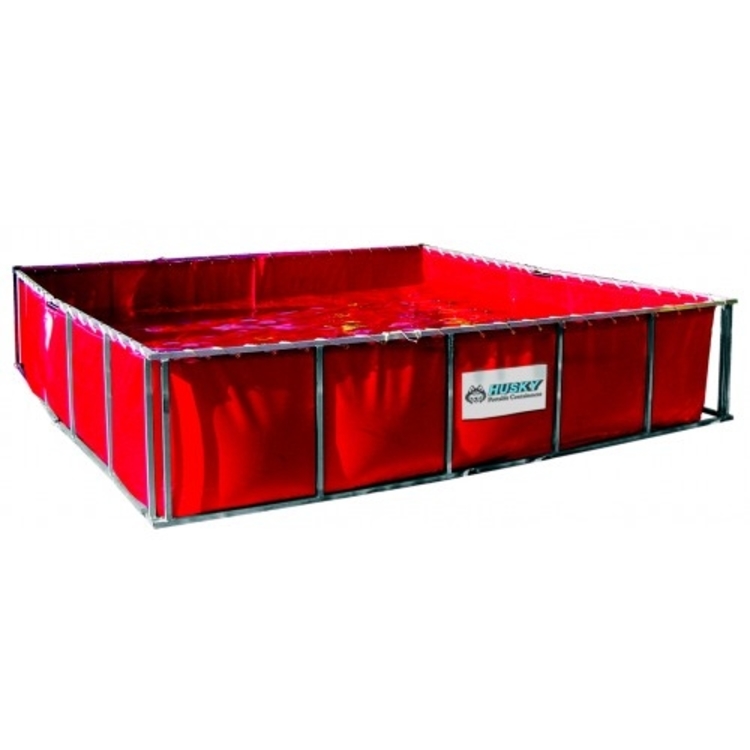

If you want to save money, water,and Chems.
Just make a wash pit with 2inch PVC pipe and a waterproof tarp.
Lay the pipe on floor and cover with tarp. The pit will be only 2 inch deep. But that's good enough. But this does take up alot of floor space.

gosh, that circulating water looks great!!!
How much can you get for all your efforts on those smaller rugs? they must be something special , for the owners.
