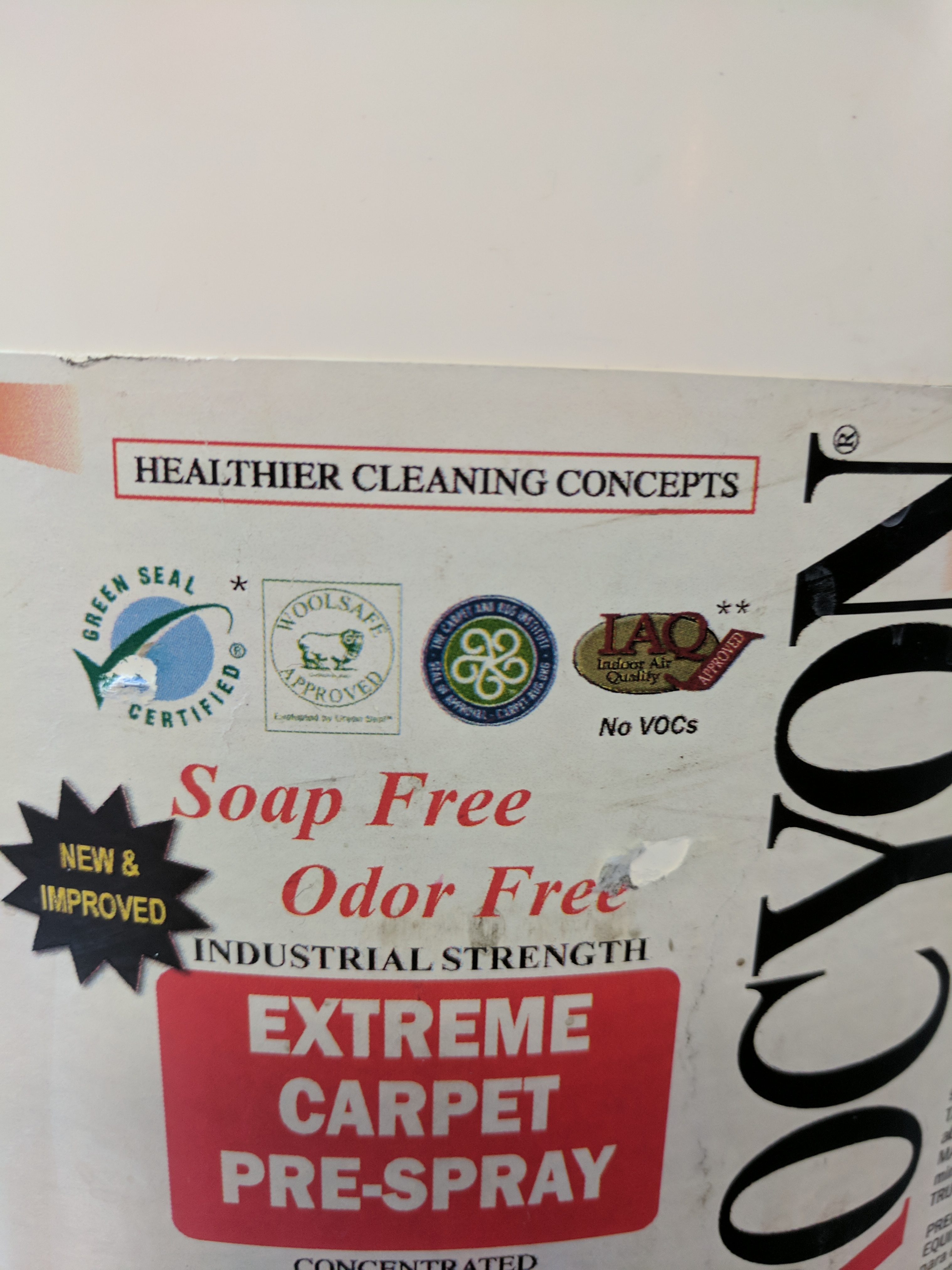

Products with stpp are green seal certified. Are they not green. Is green seal certification just a joke?

My concern is with Procyon. It is green seal certified. I am aware of the eutrophication concerns with phosphates. Ironically, with the limits on phosphates in household products, we are now using phosphates to fertilize several lakes in our area to increase plant growth.

https://www.epa.gov/saferchoice/safer-ingredients#searchList STPP the most used phosphate in powders does not show up on the list. We have worked with Green Seal and EPA DfE and it was clear from them that the level of phosphate used in our formulas did not qualify. They measure what is in the bottle, not the dilution used.
Thanks for the info Tom. So it seems in other words, that due to the level of phosphate in Procyon or similar products, it's still green.

Our "soap free" competitor has 90% phosphate or 180 times above the phosphate limit in the bottle for Green Seal. However, sodium carbonate is 100% green. However, when you want free rinsing in a product, phosphate rules and sodium carbonate is a poor substitute. Phosphates also work well at high dilutions making it a perfect choice for powdered rinses. However, in a pre-spray the sodium carbonate has great value in providing alkalinity at a low cost. Phosphates cost 4 times more per pound than sodium carbonate. We do use both together in most formulas but from what I have observed we use more phosphate in our formulas than others.
